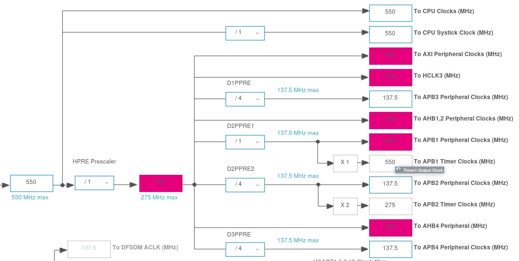

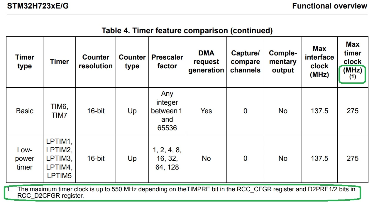

I am trying to achieve the maximum timer clock on the STM32H723ZG for input capturing. In the data sheet is written under Table 4: "The maximum timer clock is up to 550 MHz depending on theTIMPRE bit in the RCC_CFGR register and D2PRE1/2 bits in RCC_D2CFGR register."
I tried to achieve this in the Clock Configuration but it seems like the only solution I found is invalid (see screenshot below). Can I still do that? Or is there another way to do that?
I tried to compile it and it worked without a problem. Sadly I cannot test it on hardware due to delivery.

What would HELP, is that the Foot Note on Table 4 NOT BE THERE if none of the TIM listed in SAID TABLE support 550 MHz
SYSTICK, nor HRTIM, are in that table, and Tilen's post is from SEVEN years ago, for a different processor/die
Fixing the documentation needs to be JOB#1, there's just way too much of this cut-n-paste nonsense that dwells for years. Need to hire some technical writers and proof-readers.

AScha.3
February 13, 2024
Red = wrong !
set HPRE div 2 , then get max. clk on APB1 timer clk.
try.
icethiAuthor
February 13, 2024
I tried, HPRE /2,  D2PRE1 /2 (137.5 MHz is max for APB1 Peripheral) and then APB1 Timer is 275 MHz. In the data sheet it is written, that 550 MHz should be possible, but I cannot find a way?

Hello again @Tesla DeLorean @icethi @AScha.3 , thank you for reporting this. I will report this internally to be updated for the next release of the doc. For the Timers mentionned on the table 4 of the datasheet, the maximum frequency is 275MHz.
Best Regards.
