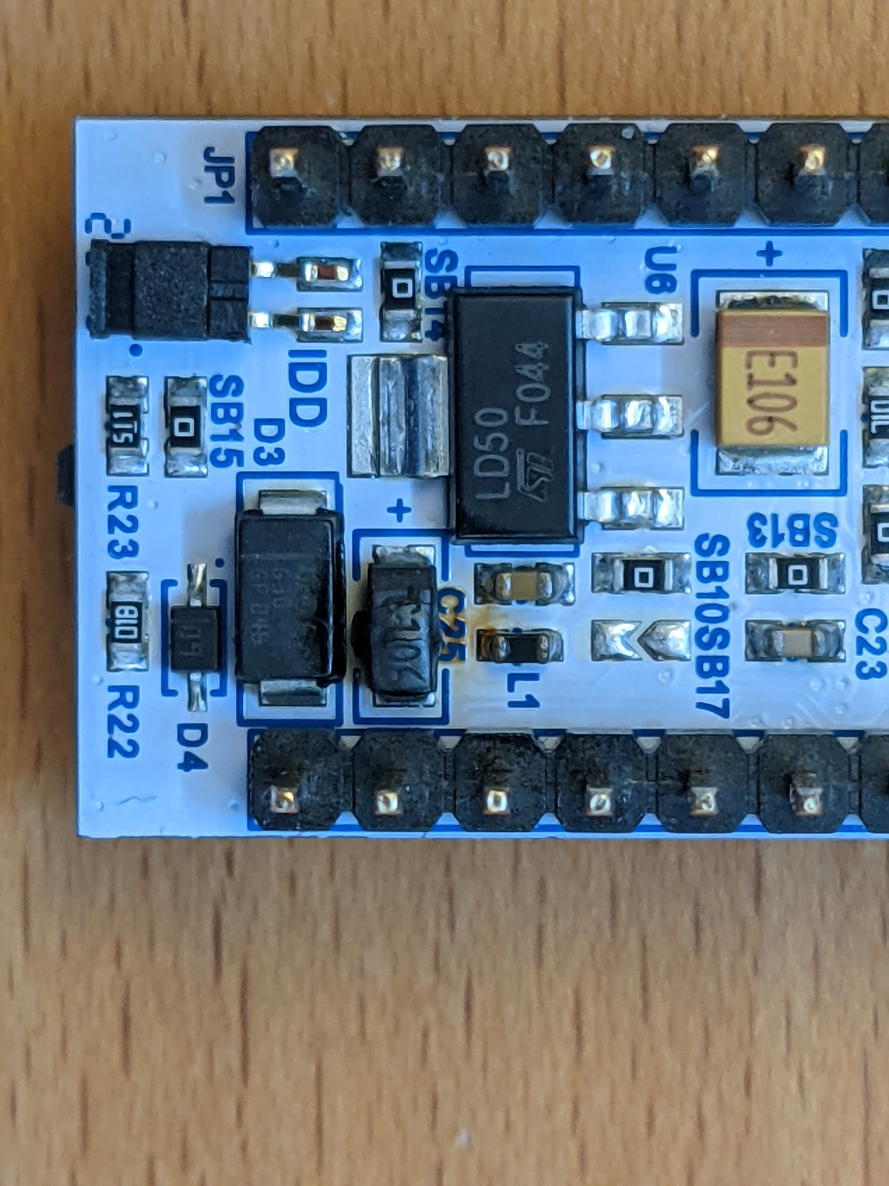

So I attached a 9V block to VIN and GND. It did not work, and all that happened was that I started to smell and got hot. It looks like the capacitor C25 was the component which got really hot.
The board worked before on USB. USB was not connected at that time. All solder bridges had been left to default.

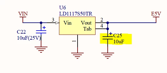

Are you sure you connected it correctly? I don't see any reason why it wouldn't work.
C25 is on the output of the 5V regulator and shouldn't have an issue with this.

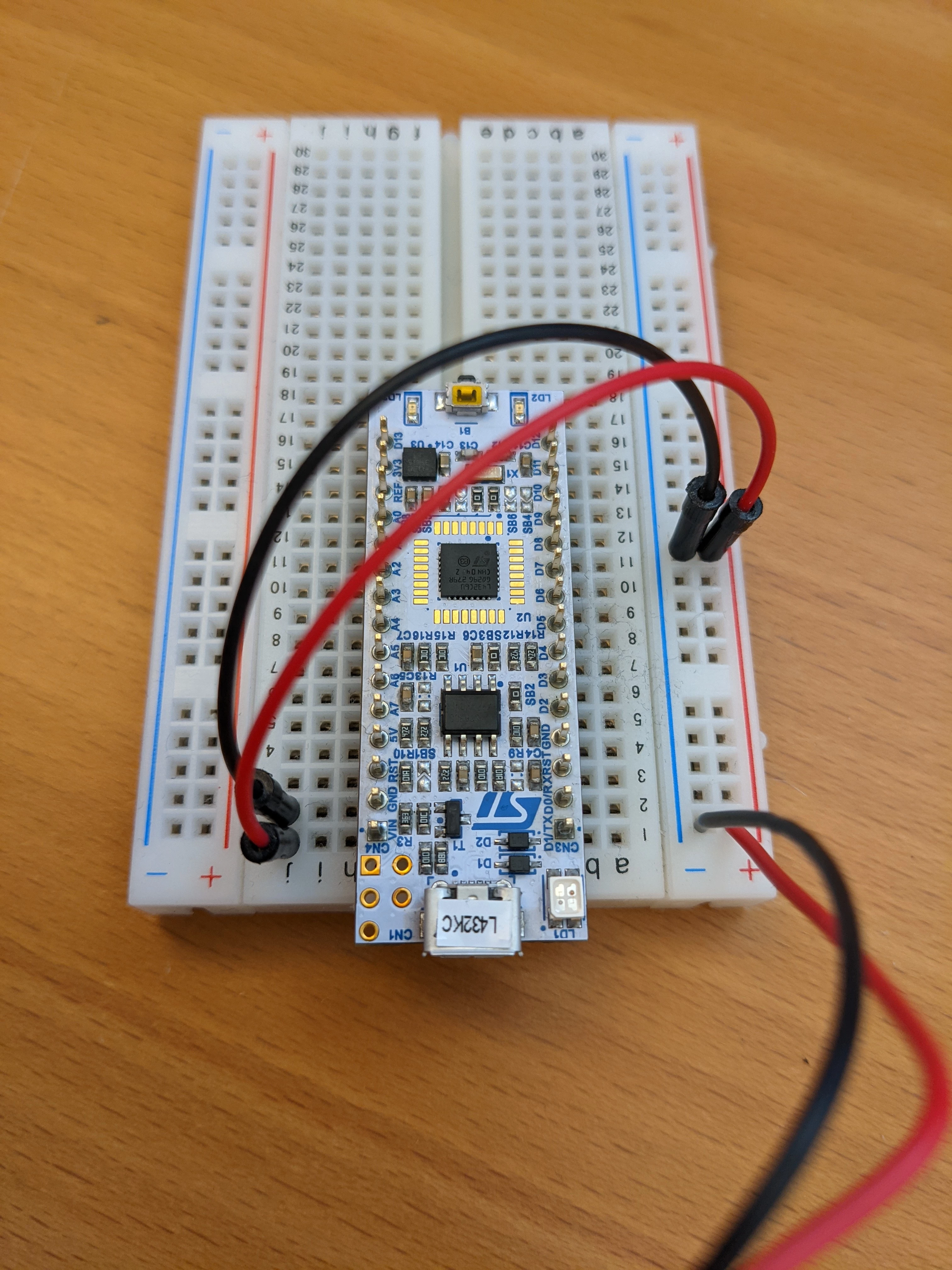

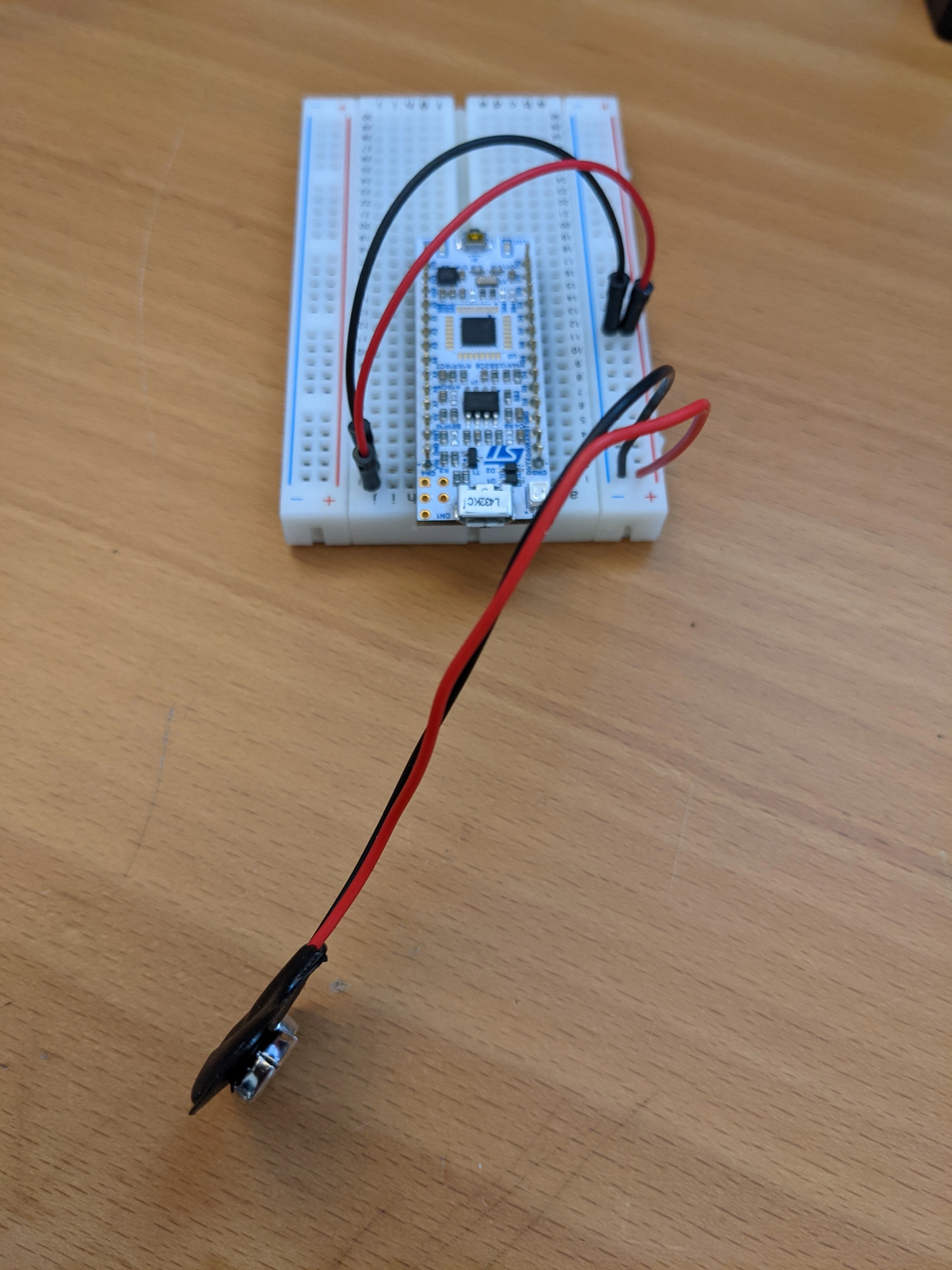

I am confident, but not sure :) Thought I did it correctly, thus my quest to find out what went wrong, and seeking help here. I took some pictures, maybe that helps.
Here is the component which I suspect got blown, looks like C25:
0693W00000BdMWVQA3.jpgHere is the overall setup:

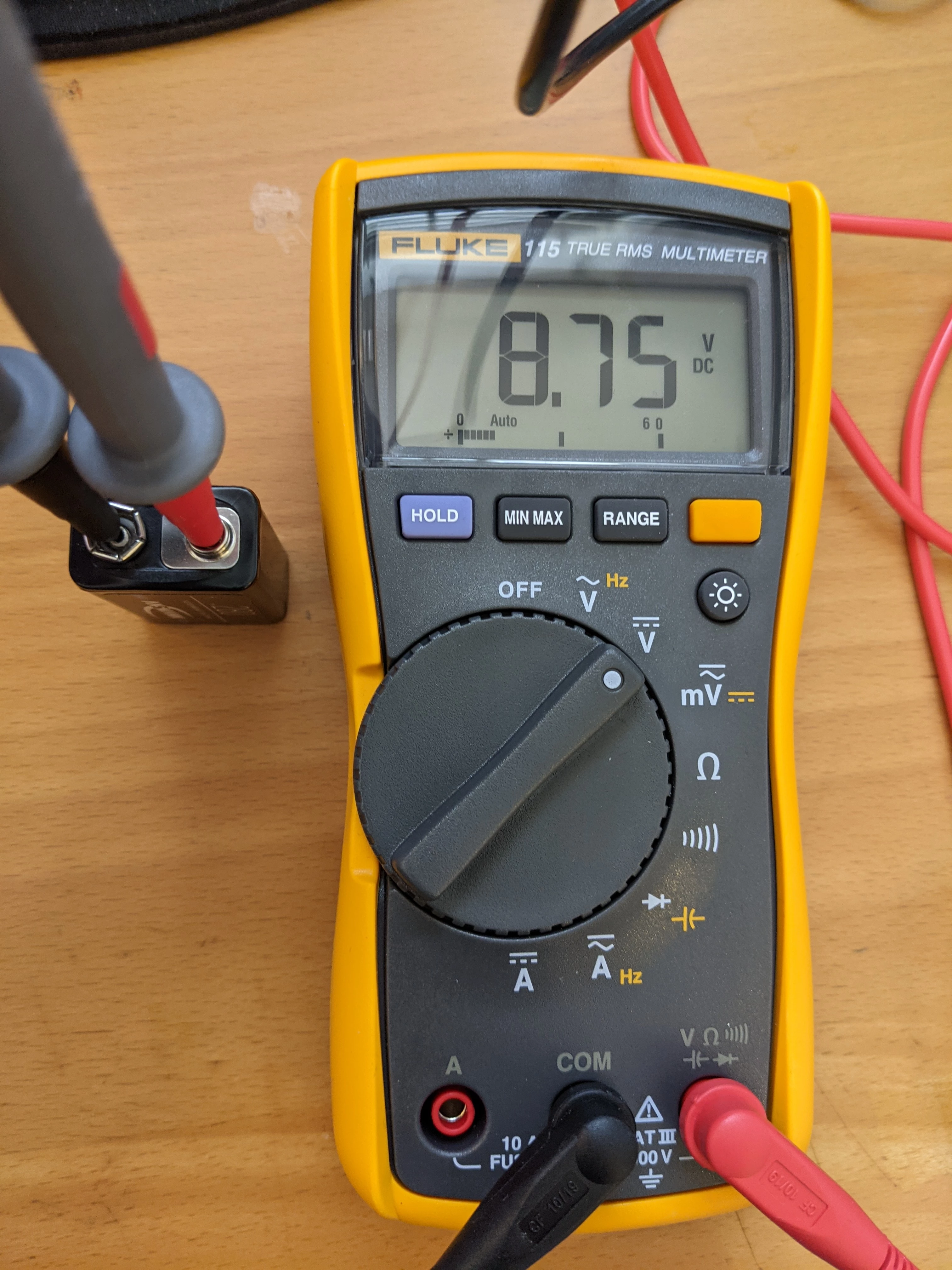

0693W00000BdMWkQAN.jpg0693W00000BdMWpQAN.jpgAnd a check that the battery is ~9V:
Should be ok?!

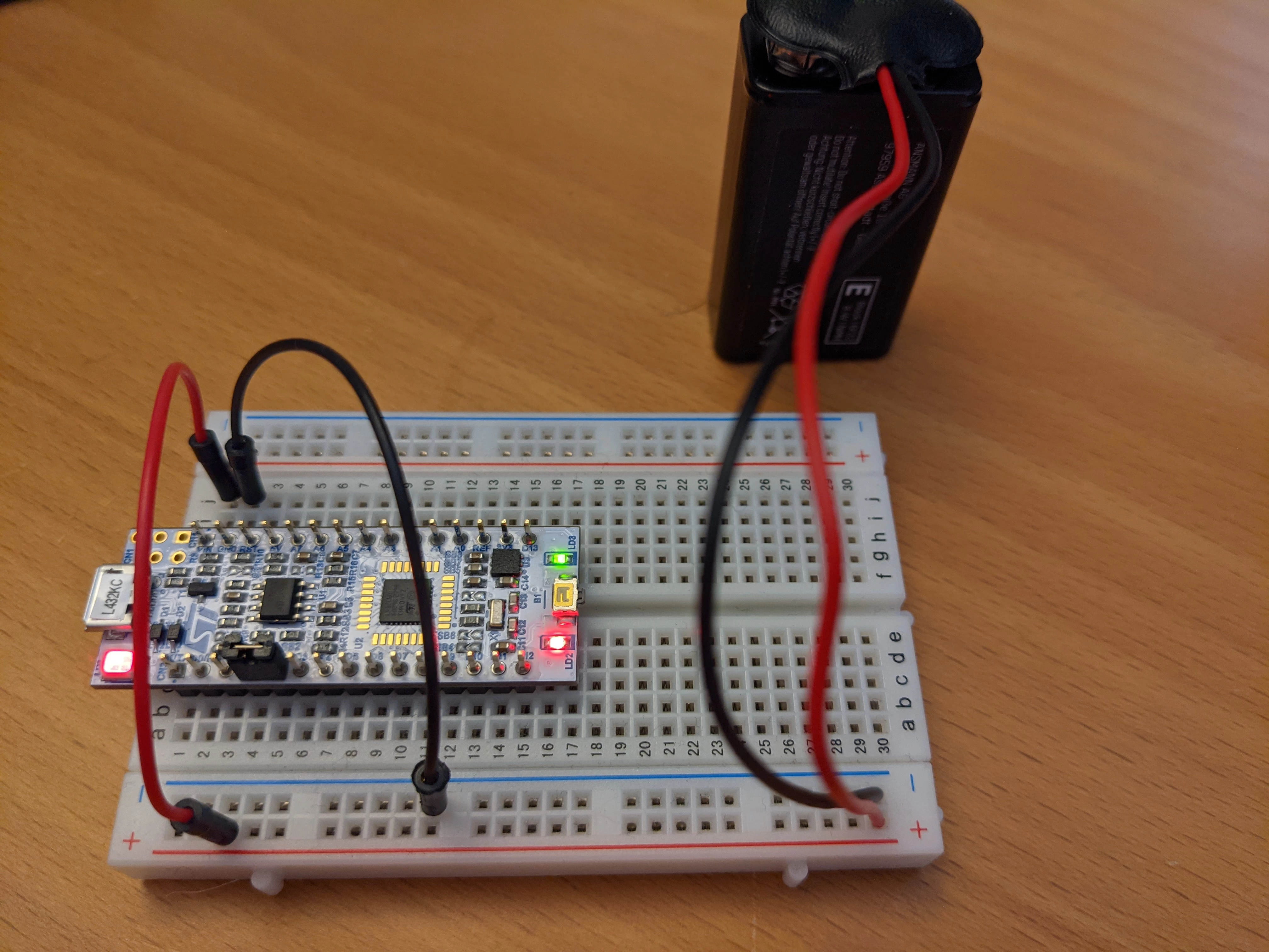

I just wanted to follow up on this. I ordered a new board, used the exact same setup, and I did work right away, as expected.
Maybe it simply was a faulty board.
