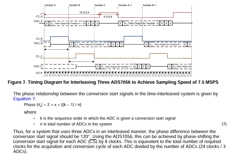

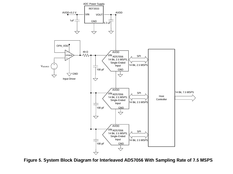

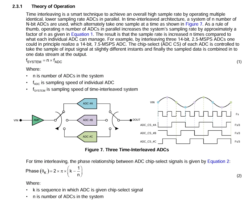

I want to achieve 7.5msps using three 2.5msps external ADC with interleaving method. So how can I achieve this with STM32h745 controller. below attaches some documentation. please anyone can provide some example code or guidance to achieve desire task?
sbaa231.pdf (ti.com)
slyt731.pdf (ti.com)

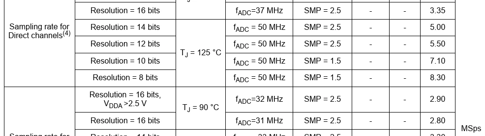

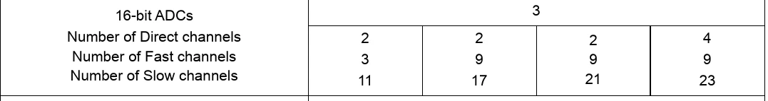

Why not use the 16bit ADCs on-chip ? Can do 14bit at 5msps  - each ! So up to 15msps possible .

yes AScha.3. but as per project requirements want to use external ADC ADS7046. and that working with SPI. so please can you guide for same?

Thanks for reply... i want triple interleaved with External ADC ADS7046. and that work with spi. please can you share example code for same?
