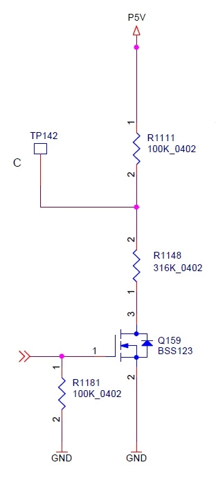

I have a question on about the 5V tolerant pin of the STM32F103RG. I would like to control a voltage reference create by a voltage divider with the STM32F103RG like below :
But i would like to replace the MOSFET by a 5V tolerant pin of the MCU (configured in open drain) to have two state : the first state with 5V at the voltage divider and the second state with the voltage attented in the voltage divider. Is it possible without damaging the MCU?
Are we supposed to see a schematics here? Because I can't.
Just ensure that the pin does not have to sink more than 20 mA when low.

Thanks for you response,
Yes it was supposed to have this schematic.
Ok, so i can replace the mosfet by an open drain gpio. Thanks
