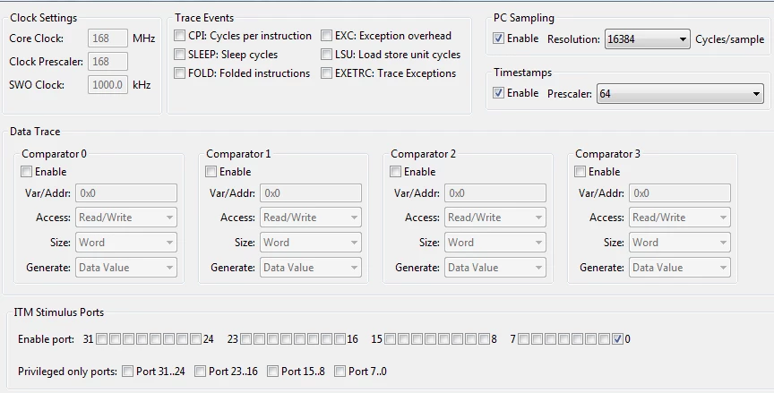

Can you or anyone check if SWV ITM works with PC Sampling enabled and, if yes, post screenshots of config?
If nobody responds then it probably never worked.

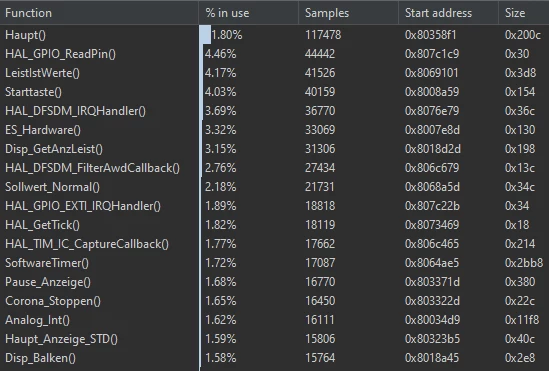

Yes, as i said: working fine, see here example for profiling: maybe one minute running (top part...> 1%)

What I meant was: with PC Sampling enabled, does the SWV ITM debug console work for you?
How do you set the address range for profiling?
I cannot get it to show more than a bit of the startup code, in the bottom 32k block.
The buffer is set to 20MB.
AScha.3
October 1, 2025
Yes, ok, until buffer full....then error message.
As i said: not for running long time with profiling.
+ set prescaler :because SWV is in the end a serial, at 2 or ...8 mbit , so it cannot send sampling time info at a rate of 100 MHz or so...i have prescaler set to 64 or more...at 200MHz core speed.
Buffer i have also at 20MB for profiling.
Huh, what?   Profiling just gives you the time/function in % , = how long is cpu busy in ...,...,...;
no address range, just all, what its doing, while sampling.

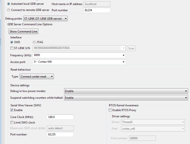

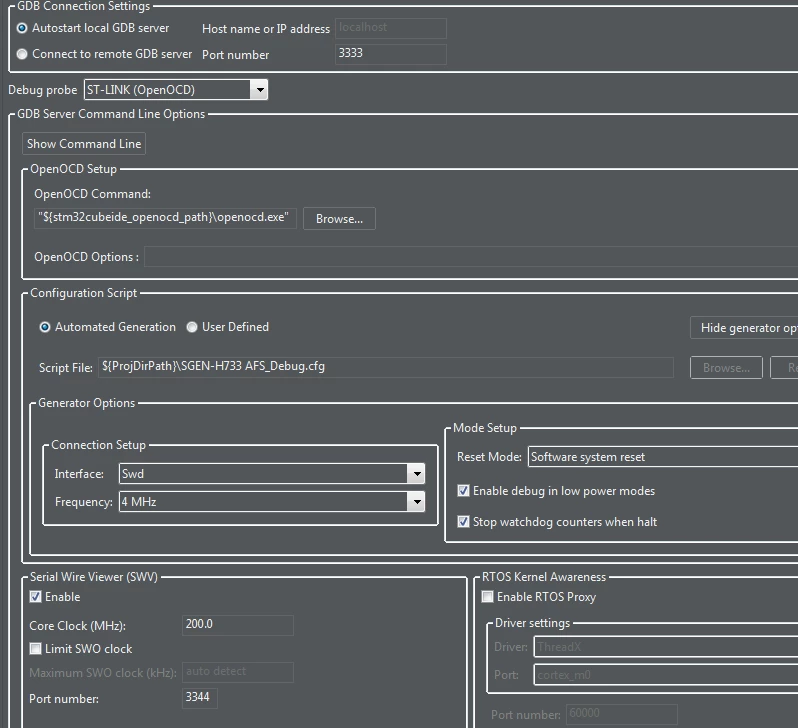

What settings do you have here?
AScha.3
October 1, 2025
...about same (just other cpu , H743 H7A3 , clock etc. );
and debug (mostly i use OCD ) software reset:
uncheck PC sampling, if not looking for statistics.
PHolt.1
PHolt.1Author
Senior
October 1, 2025
OCD... what debugger?
Yes I have to uncheck PC Sampling for SWV ITM to work.
I have tried OCD with the CTLINK V3 and it does exactly the same stuff as with SWD.
