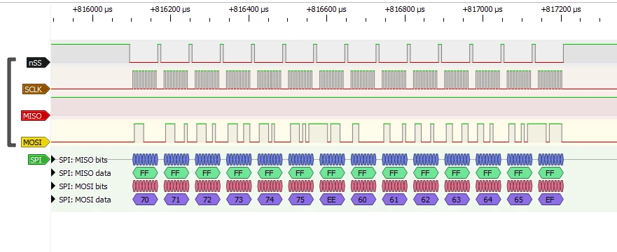

Problem 1: Slave MCU could not receive the data
Master:
- output the Data array by SPI in DMA mode
- output data are correct and checked by Logic analyser
Slave:
- No matter how the SPI setting is, received data are always 0xFF
- SPI DMA have fired event but the data are always 0xFF
- Tried to set both side have CRC, the slave side have CRC error occur but the DMA content are 0xFF
- Tried to use polling method, but same result.
Could anyone advise me what should I check on next step?

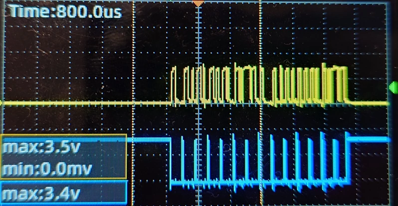

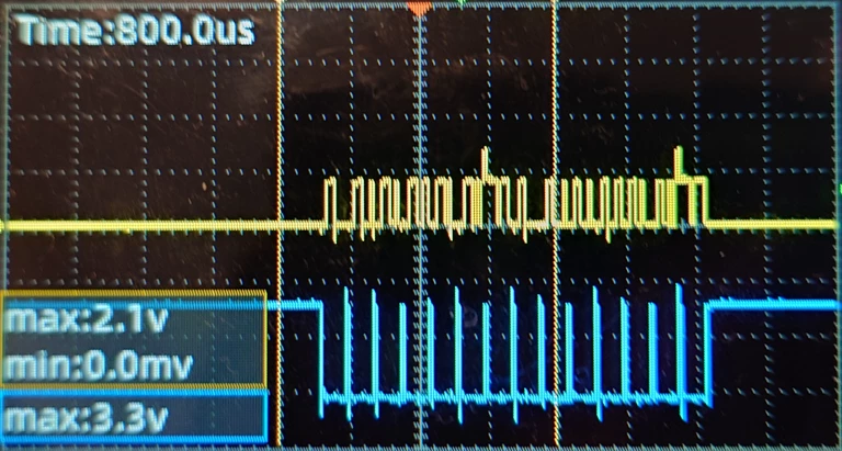

Problem 2 – MOSI/MISO pin voltage cut half when using slave side using “Full-Duplex Slave”
- When Slave MCU selected the “Full-Duplex Slave”, The MOSI pin voltage cut half.
- When Slave MCU selected the “Receive Only Slave”, The MOSI pin voltage became normal
(but still have problem of received data by DMA at problem 1)
(Yellow is MOSI/MISO, Blue is NSS)
Full-Duplex Slave:JFung1_2-1744723480809.png
Receive Only Slave:JFung1_1-1744723480761.png
Why the Voltage become cut half?
I have tried the GPIO setting but nothing change.
Mike_ST
Mike_STBest answer
Apr 15, 2025 1:52 PM UTC
>> - Connection:
>> G031K8 (Master) <=> G031K8 (Slave)
>> MOSI <=>MISO
>> MISO <=> MOSI
You have to connect MOSI of the master to the MOSI of the slave, and  MISO of the master to the MISO of the slave.

EZHON.1
Apr 16, 2025 12:51 AM UTC
connection issue, it's different with the UART communication.
