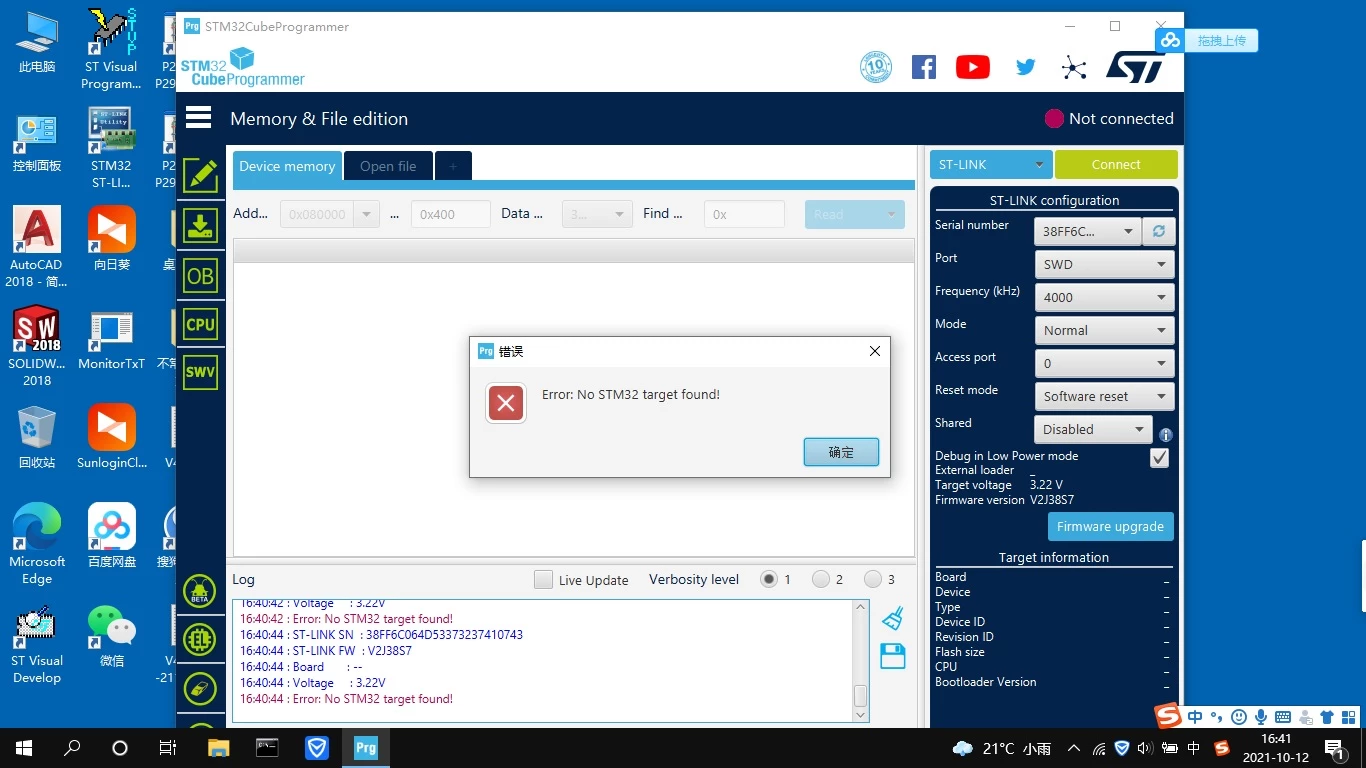

I try to connect PCBA board with programer tool STlink-V2, but show can't connect target STM32G030XXX from STM32CubeProgrammer software interface. see below image.0693W00000FCBZLQA5.jpgBut I try STM32F030XXX can connect the target, please let me know what is the problem for STM32G030XXX?
Check if STlink-V3 can meet this requirement?
October 12, 2021

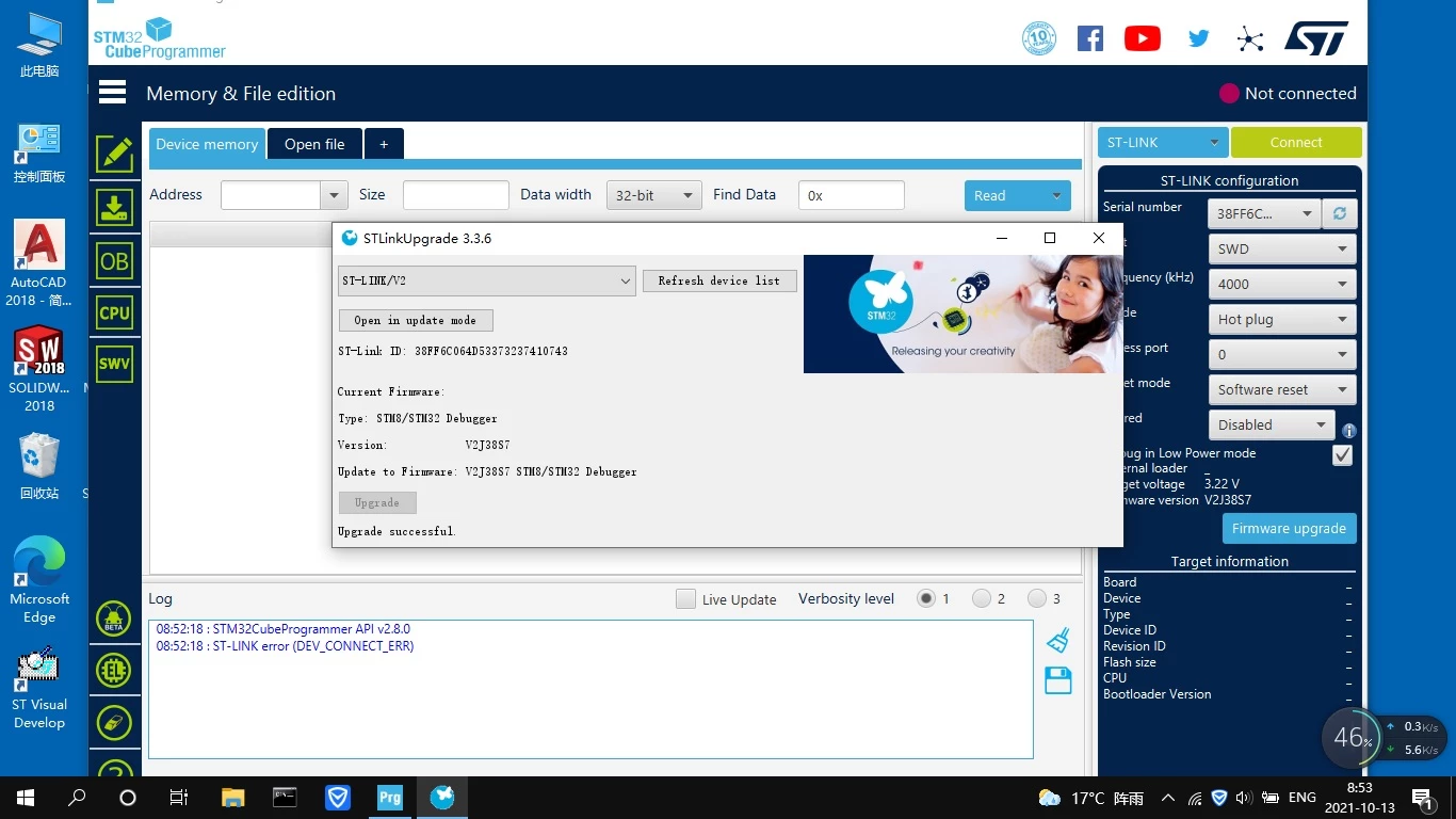

Have you upgraded the ST-link firmware? go to ST-LINK > firmware update or through this Link STSW-LINK009.
Maybe you should check if the MCU is correctly powered and connected in the right pins !

Yes, I already upgraded the latest FW successfully, see below image.
0693W00000FCIjXQAX.jpgI can make sure the pin contact is very good and powerd on by 3.3V from STlink-V2 tool. Since this tool has been using STM32F030XXX progrmaming, only changed to new MCU type STM32G030XXX, other no change. programming point is same as STM32F030XXX.
I checked PCBA TopBand supplier, was told if the STM32G030XXX was encrypted protection after programming by them, STLink-V2 tool can't be used, if no encrypted protection STLink-V2 tool can do programming. But you mentioned even encrypted also can be used for unlock and programming, please help, thank you!

I used STLink Utility also happened same error, can't connect the target. I am curious that why STM32F030XXX encrypted protection can connect the target with Stlink-V2 tool, while STM32G3030XXX can't connect the target? What is the difference?
S.Ma
Principal
October 13, 2021
G0 is designed for very low pincount packages, compared with F0.
Check boot0, swdio, swdclk and nrst pin configuration and usage in flashed application.

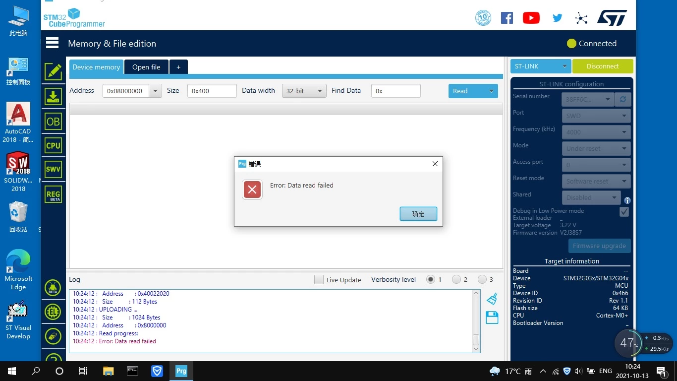

Sorry, I selected under reset mode can connect the device but show "data read" failed, see below image. This was casued by third party chip was encrypted protection?

Houda GHABRI
October 22, 2021
Hi @Ayang.1​ ,
This error message is "normal" we cannot read Data when read out protection is equal to 1 (0xBB).
So you need just to click OK to the message then go to Option bytes Tab and modify the RDP value.
Can you please test and tell me if it is Ok?
