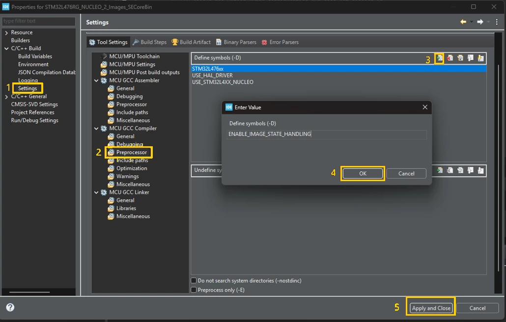

12. How do I enable rollback and image verification?
To enable the rollback feature in SBSFU using the ENABLE_IMAGE_STATE_HANDLING compiler flag.
To do so, go into each project (SECoreBin, SBSFU, UserApp):
Right click, go to properties and follow the instructions as displayed in the picture below:
Apply and close, then rebuild all projects.
