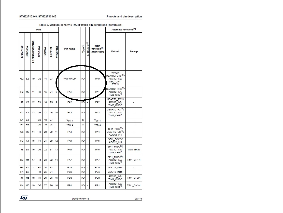

Aug 31, 2023 2:34 AM UTC
Hi, ST MCU Support Team,
In the Datasheet - STM32F103xB, March 2022, PA0 - PA7 are not under FT or TT, but with a "-".
Could you advise the meaning of this "-"? Does it mean "TT" or others?
Thanks.
Lan
Aug 31, 2023 3:22 AM UTC
On the STM32F103, "-" means not 5V tolerant. The datasheet has specifications for non 5V tolerant pins. No need to bring definitions from other datasheets onto the STM32F1 datasheet. Each stands on their own.
