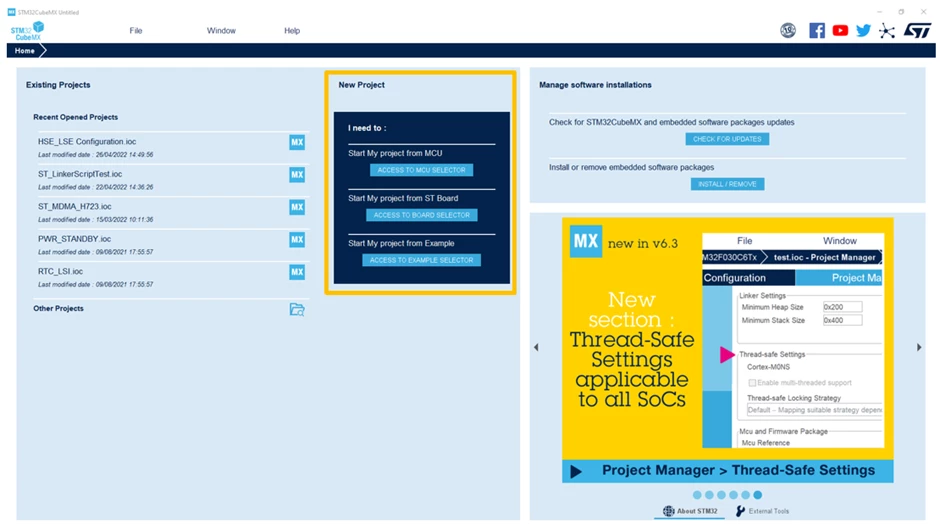

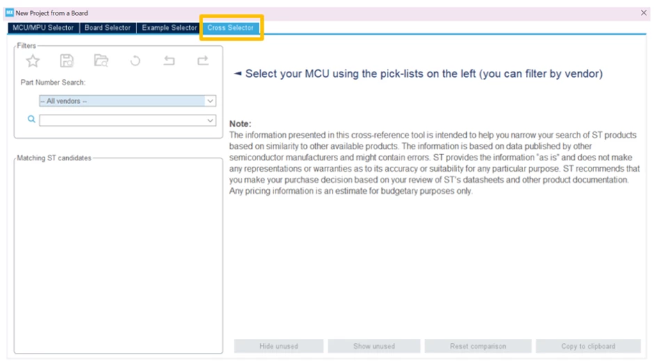

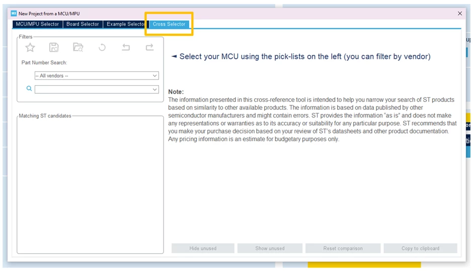

To access the cross-selector tool, start on the home screen of the STM32CubeMX application. Under the New Project section, select from any one of the following icons: access to MCU selector, access to board selector or access to example selector.
Once you’ve selected one of the new project icons, navigate to the last tab (cross selector) on the pop-up window:

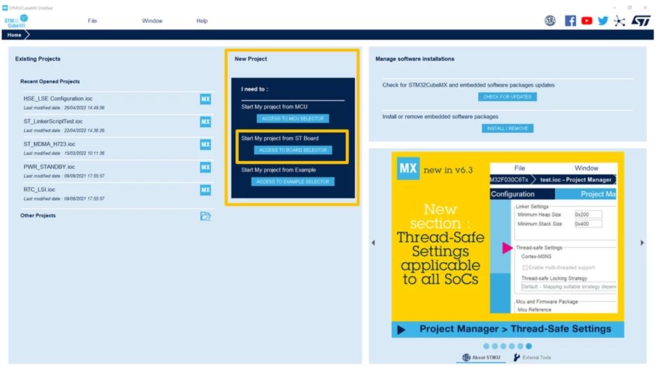

Step 1. Navigate to the board selector tool, under the New Project section in STM32CubeMX.
Step 2. Start typing the part number in the Commercial Part Number field, and you should see a list of available boards with the STM32F7 populate. Scan the populated list to see if the STM32 part number you’ve entered matches any of ST’s existing hardware boards.

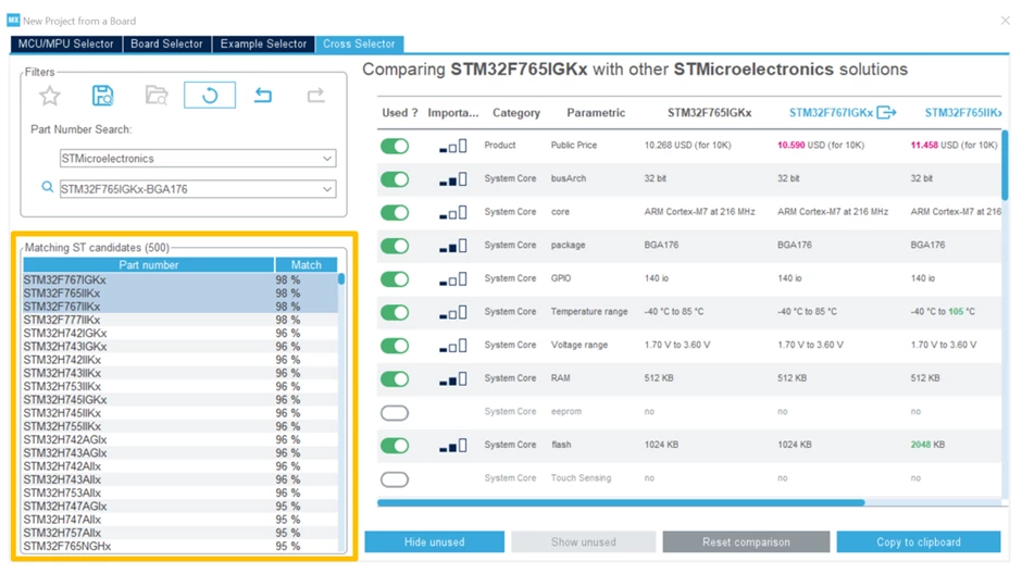

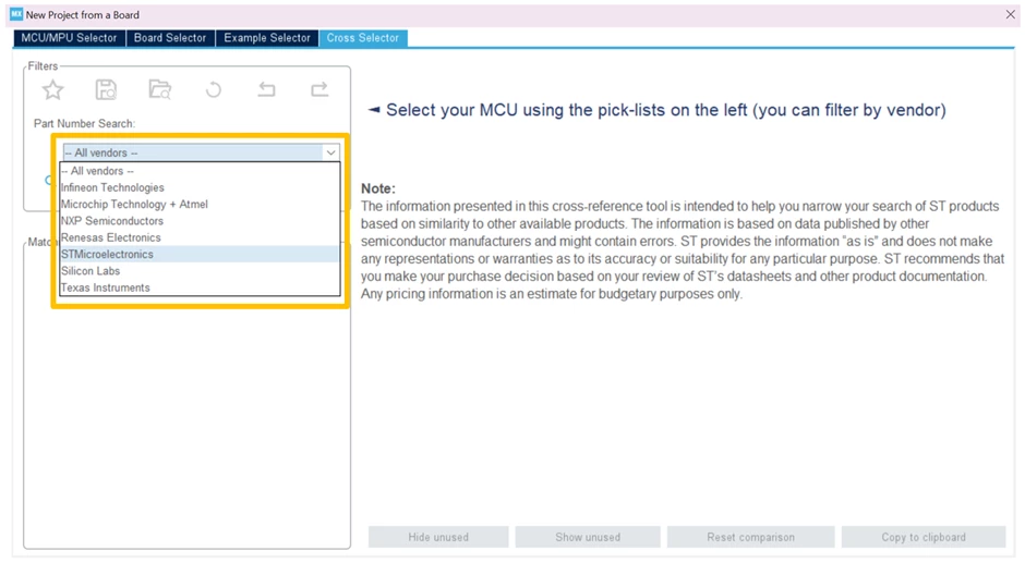

Step 5. Click on the – All Vendors – drop down menu, and select STMicroelectronics.

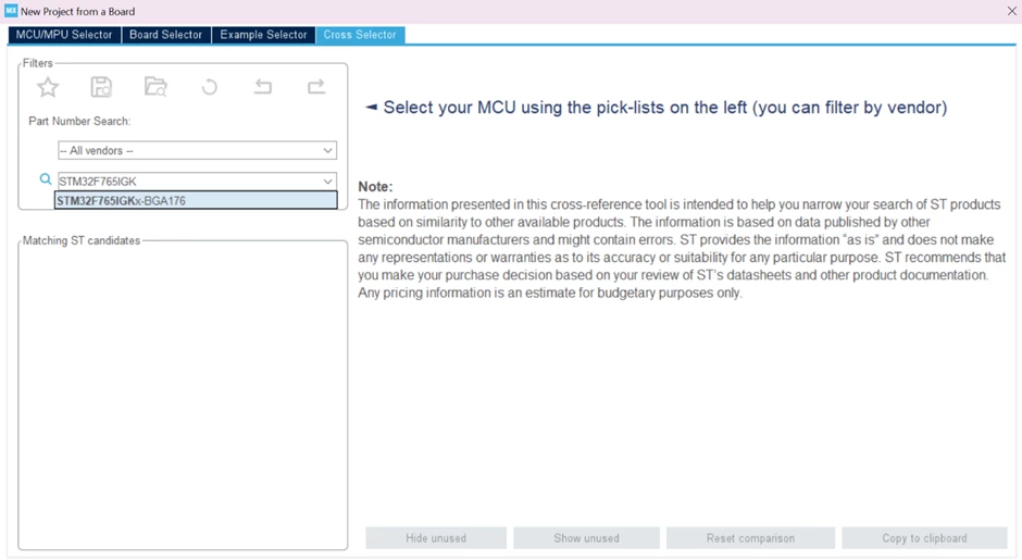

Step 6. Enter in your STM32 part number in the second search box below and select the part number from the populated list.

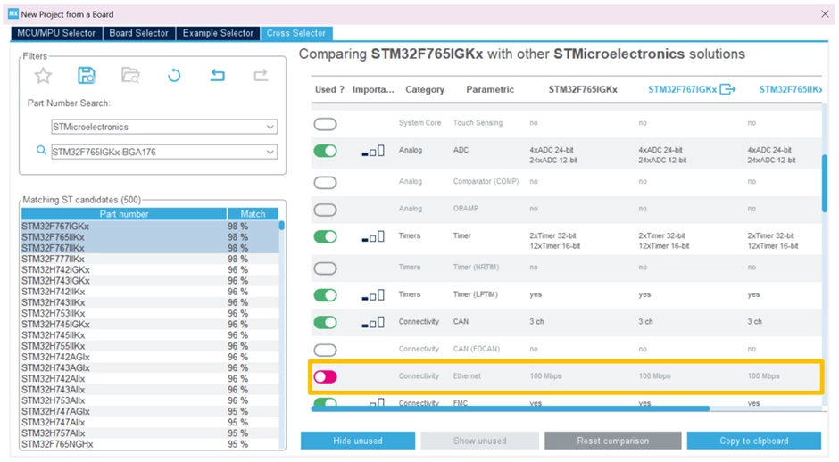

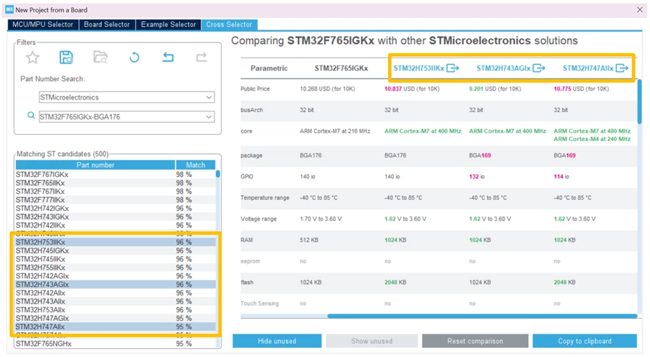

Step 7. Below the Part Number Search section, you will see a list of other comparable STM32 part numbers and their similarities in terms of a match percentage.

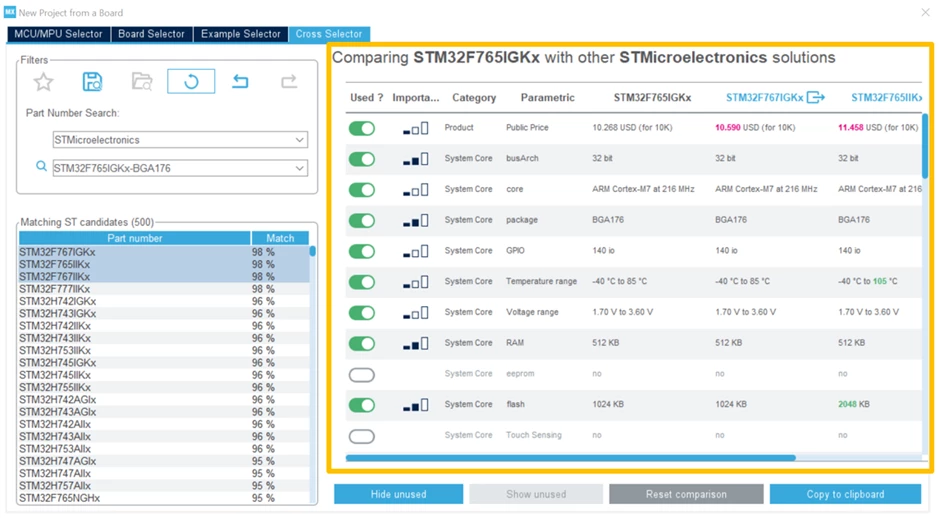

On the left-hand side of the Part Number Search and Matching ST Candidates sections, you will see a chart comparing the STM32 part number you’ve selected with it’s similar STM32 part number candidates. In this chart, you will find details and comparisons between the various features pertaining to each unique STM32.
This chart is dynamic, so you can include or exclude certain features that are important to you and your use case. To do so, simply toggle the button under the “Used?” category.

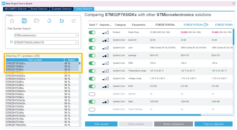

By default, the top three similar part numbers are selected for comparison. However, you also have the ability to do a comparison to other STM32 part numbers with less of a percentage match. To do so, select and highlight one or more part numbers you’d like to see comparisons for.
Step 8. Make note of the top 3 matching ST candidates. In this case, the part numbers closest to our selected STM32F765IGK6 are:
  • ​​​​​​STM32F767IGKx
  • STM32F765IIKx
  • STM32F767IIKx

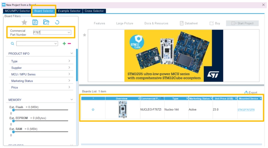

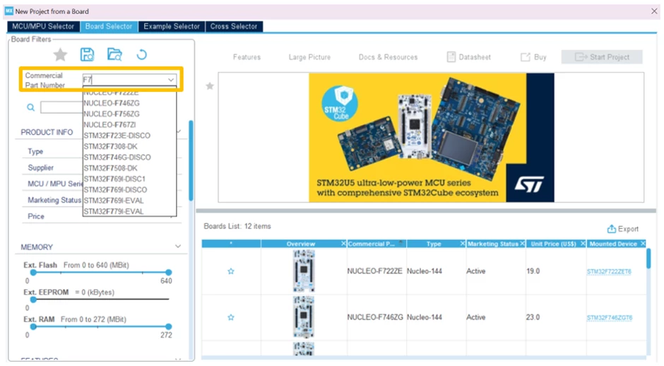

Step 9. With these comparable STM32 part numbers handy, repeat step 2. Once again, we will select the board selector tab and enter in the STM32 part number “F767” which is the first match on Matching ST candidates list from the previous step.
Congratulations! Although there are no ST hardware boards that match our STM32 part number exactly, we’ve found a similar enough board to kick start the application development process and prototyping.
