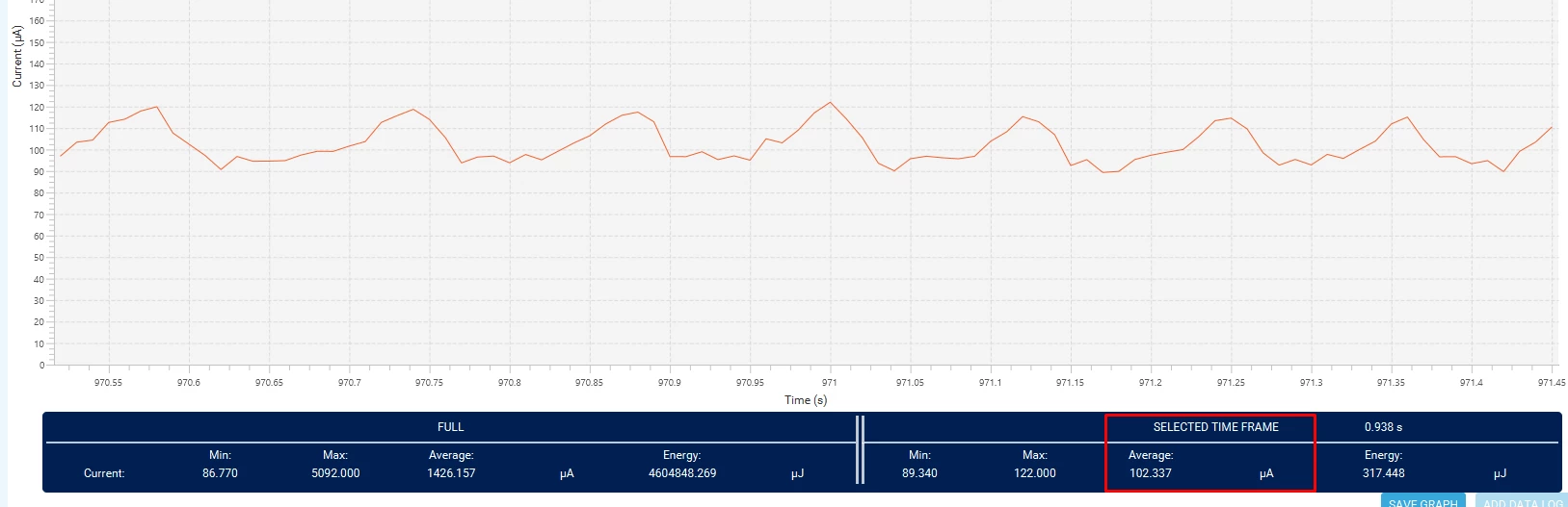

When comparing your current measurements to those listed in the datasheet, it is important that you are only measuring the current going into the VDD lines of the MCU. This is an obvious statement, but it is worth mentioning. It is common for custom PCBs not to be designed with a series break for an ammeter on the VDD line. By making changes in the firmware you will of course still see reductions in the consumption of the system.  However, by not having the isolated current of the MCU, you can never be sure that the low-power modes are implemented optimally. Our development boards usually have a jumper to allow you to place an ammeter in series with VDD. You can always use that to verify that the firmware is working optimally. If your application really needs to optimize power consumption, consider having a way to measure the current of the just MCU.

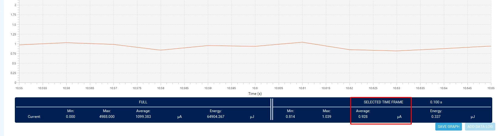

Assuming we are measuring only the MCU current, there is still another important aspect to getting accurate measurements. Always remove the debug probe and power cycle before measuring current. Even when the debug pins are disabled in firmware, if the debug probe was previously connected, there is still some debug silicon active in the MCU that takes up energy. By removing the debug probe and power cycling, you should see numbers that are in line with the datasheet. After flashing and attaching the debugger, the current sits at a little over 100uA in stop mode
After detaching the probe and power cycling, the current is down to under 1uA
It is simple to see this when measuring the isolated MCU current. In a system seeing the 100uA drop could appear random if one was not aware of this phenomenon.

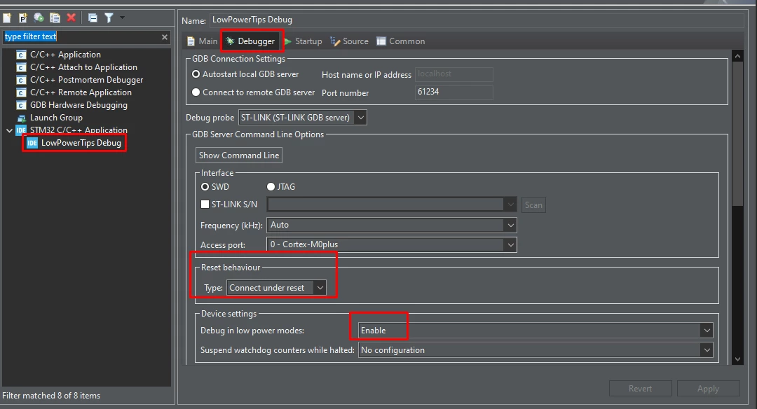

2.4 Debugging low-power modes
For debugging low-power applications, there are two debug configurations that you should be aware of. In the CubeIDE debug configuration for your project, under the debugger tab:
The "Reset behavior" configuration is important because if your firmware has previously set the debug pins to analog mode, the "Reset Behavior" must be set to "Connect under reset."
"Debug in low power modes" allows for the debugger to stay attached in low-power modes (assuming you have not set the debug pins to analog mode). This allows you to have breakpoints set in multiple ISRs while the device is in a low-power mode. This can be useful for understanding which ISRs are being hit, and in what order. Adding any new breakpoints during execution or stopping execution also counts as an interrupt from the perspective of the core. It causes the MCU to exit the low-power mode.
When you find that your peripherals work in run mode but are not working in stop mode, one of the key points to check would be the clock source for that peripheral. Since stop typically shuts off all oscillators that are not low speed oscillators, it is possible that the peripheral you are using is taking its clock source from a clock that was shut off. For example, this LPTIM allows for configurations that would prevent it from running in stop mode, so you would need to select either LSE or LSI as the clock source.
Or sometimes there are specific features for a particular MCU that allow certain peripherals to use high speed internal oscillators exclusively in stop mode. These kinds of implementations are MCU specific, so you need to refer to the reference manual for your chosen MCU. Generally, LSE and LSI oscillators are always available in stop mode.
