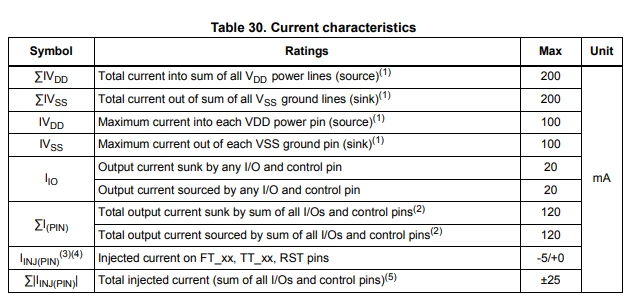

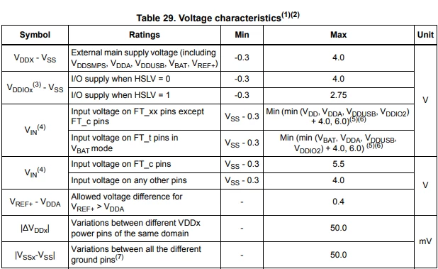

You can find below an example of absolute maximum ratings values for STM32U575 mentioned in DS13737.
