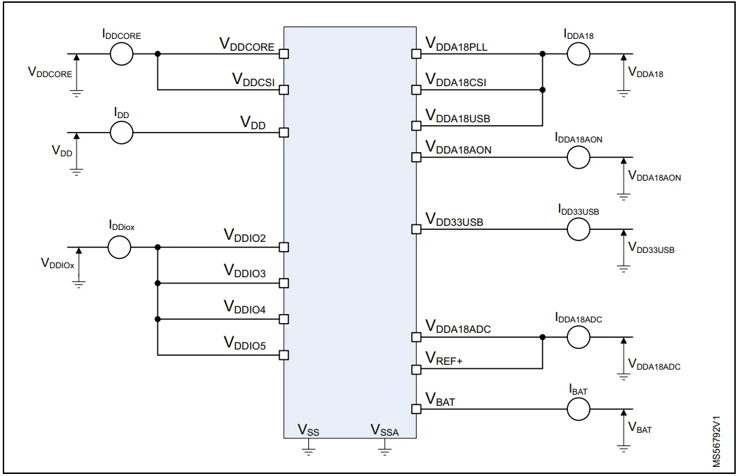

1. Low-power modes overview
The STM32N6 series microcontrollers are not low-power. However, they are designed to optimize power consumption while maintaining performance. These devices, based on the Arm Cortex®-M55 CPU and Neural-ART accelerator, support various low-power modes to balance power savings and functionality.

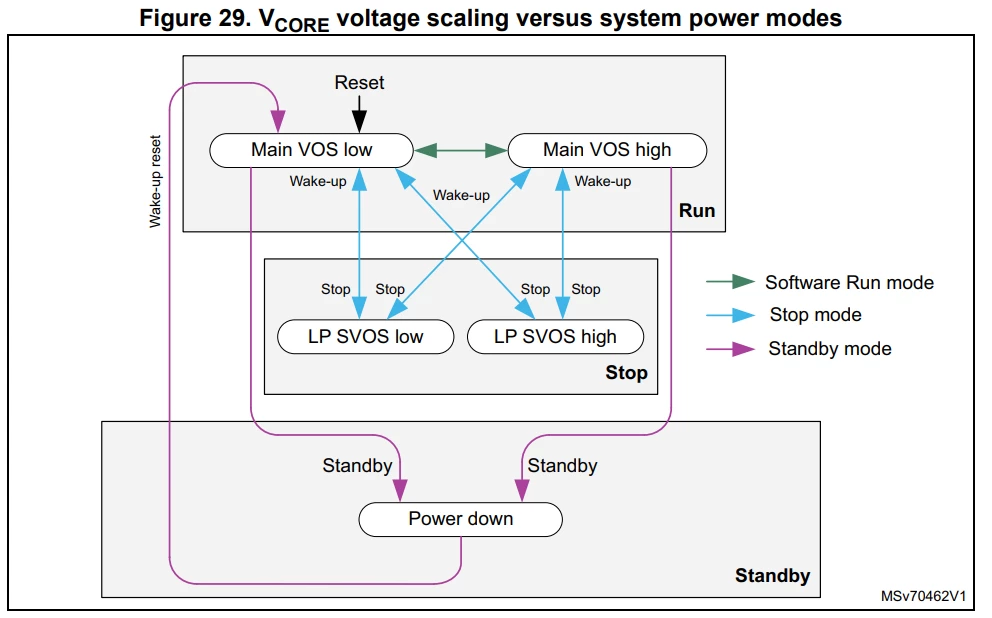

The diagram available in Figure 29 of the RM0456 shows how the device manages transitioning between different voltage scaling states and power modes, optimizing for either performance or power savings as needed.

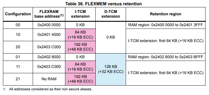

All internal SRAM is erased except for 80 Kbytes of SRAM1, depending on the FLEXMEM setting. Backup SRAM, I-TCM, and D-TCM RAM can also be retained. Table 36 from reference manual 0486 provides a clear view on the configuration and the RAM memories that are retained:

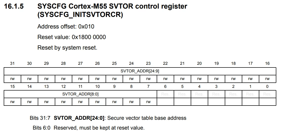

The software restarts based on the location of the secure vector table address, as written by the application in the SYSCFG_INITSVTORCR register before entering Standby mode. Refer to reference manual 0486 for more details.

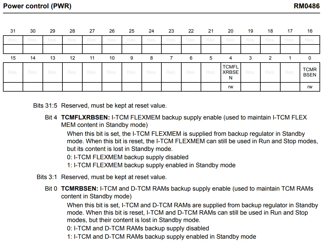

By default, the contents of TCM RAMs and I-TCM FLEXMEM are not retained in standby mode. Before entering standby, the demo enables them by setting the TCMRBSEN bit in the PWR_CR4 register using the HAL_PWREx_EnableTCMRetention() function. Additionally, the TCMFLXRBSEN bit, also in the PWR_CR4 register, using the HAL_PWREx_EnableTCMFLXRetention() function, which allows the content of these memories to be retained even in Standby mode.
The demo code also ensures the secure vector table (VTOR) address is properly set in SYSCFG_INITSVTORCR. This is done in the <system_stm32n6xx_s.c> file, in the SystemInit() function.

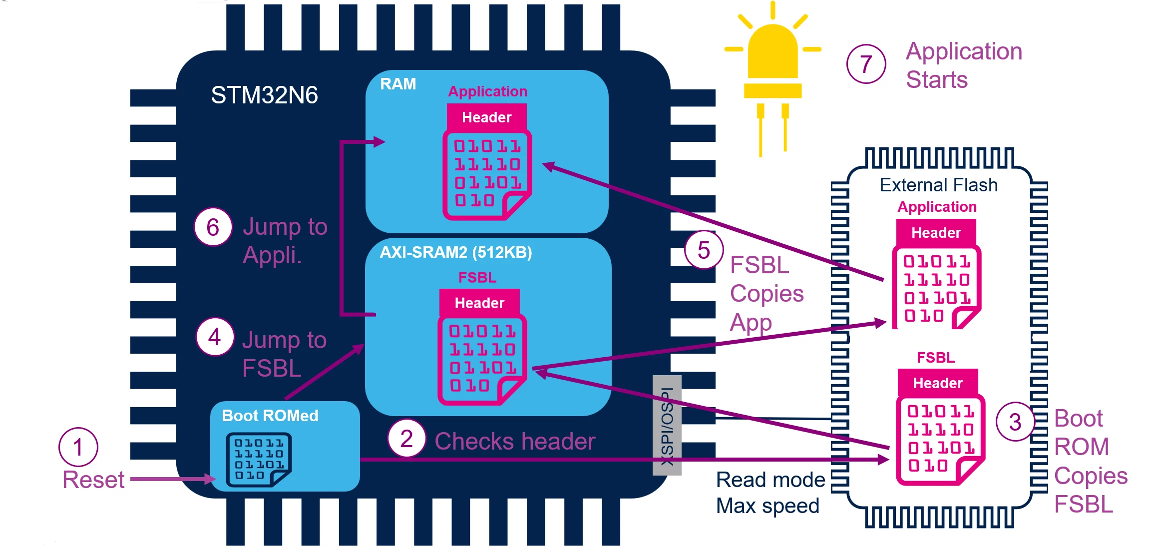

2.4 Demo execution flow
  • Power ON: Boot ROM execution, FSBL project copied from external FLASH to internal SRAM2. Represented as steps 1 to 4
  • FSBL execution: Full application binary copied from external FLASH to internal SRAM1. Given the application is <80 KB, the application is fully retained. Represented as step 5
  • Application execution: PC jumps to application code in SRAM1. Represented as steps 6 and 7.
The code example performs the basic configuration, including the clock settings, the green and red LED, and the PC13 (user button) as a wake-up pin. There is a minor logic to verify if the MCU woke up from the Standby by checking the power flag and configuring the system initialization in case it is true. After that, the demo enables the TCM and ITCM retention and enters Standby mode.
Once the wake-up event is created, the STM32N6 software resets and starts from SRAM1 instead of entering in the boot ROM area. The exit from Standby mode is identified and the hardware configuration is performed, including the clock settings, since no FSBL was executed after Standby wake up. The device enters again Standby mode and the process repeats itself.
If the application had exceeded the 80 KB that can be retained at SRAM1, a copy of the FSBL or a custom loader should be present at the AXISRAM1 instead. This ensures it will either copy the entire application code from the external serial flash memory to internal RAM and perform the jump after waking up from SRAM1. Alternatively, configure the serial FLASH in execution in place mode and jump to it.

The application project enables the memory retention in main.c at lines 153 and 154:
/* enable memory retention to keep application in Standby */
HAL_PWREx_EnableTCMRetention();
HAL_PWREx_EnableTCMFLXRetention();
The function SystemInit() in system_stm32n6xx_s.c is the one responsible for configuring the INITSVTORCR register.

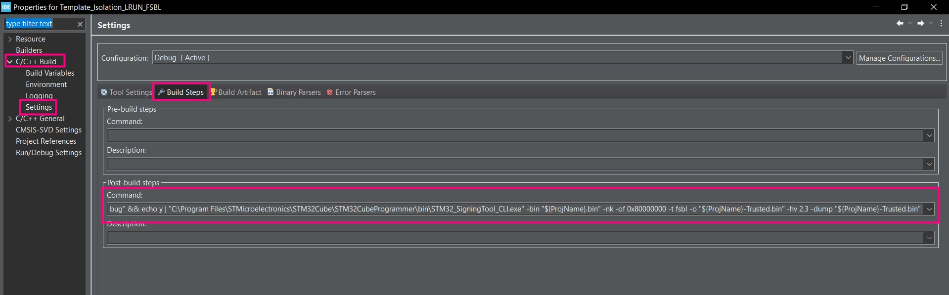

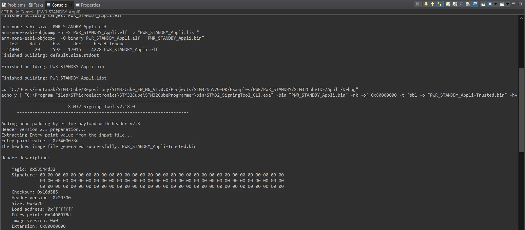

3.3 Adding a post build command and build
To facilitate the demo execution, add this post build command on both projects to add the header in the binaries. This command assumes the STM32CubeProgrammer is installed in its default path. Starting from STM32CubeProgrammer version 2.21.0, a new parameter is needed at the end "-align". Please make sure you use the updated command, as follows:
cd "${ProjDirPath}/Debug" && echo y | "C:\Program Files\STMicroelectronics\STM32Cube\STM32CubeProgrammer\bin\STM32_SigningTool_CLI.exe" -bin "${ProjName}.bin" -nk -of 0x80000000 -t fsbl -o "${ProjName}-Trusted.bin" -hv 2.3 -dump "${ProjName}-Trusted.bin" -align
This command can be added as a post build by entering in the Project Properties, C/C++ Build → Settings → Build Steps:
Once this post build is added to both projects, press [Ctrl] + [B] to build both. Notice the commands being executed in the Console tab:

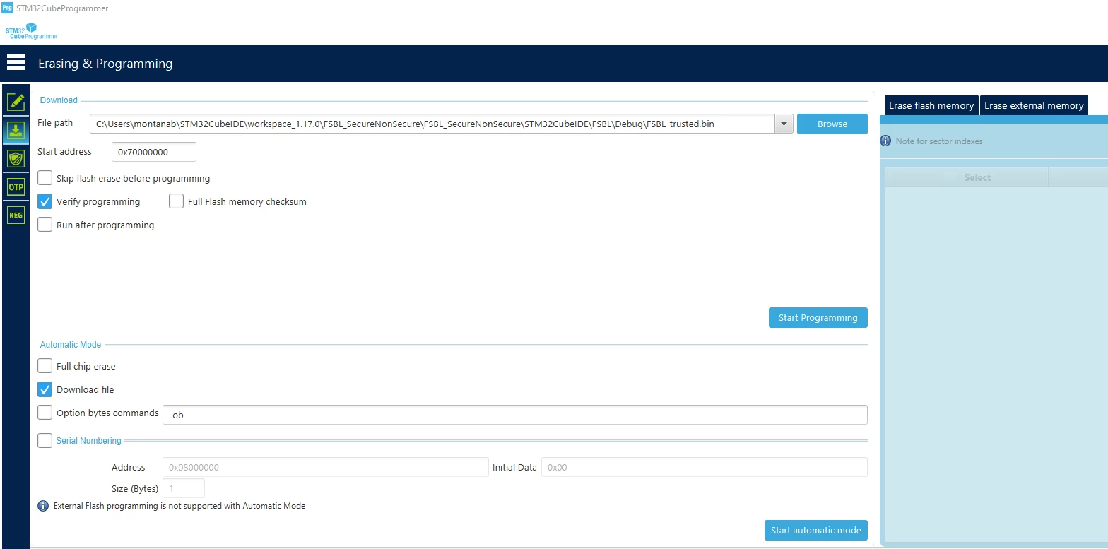

3.4 Programming the binaries
On the STM32N6570-DK board, change BOOT1=H (DEV_BOOT) and connect it to the PC using the USB Type-C® cable.

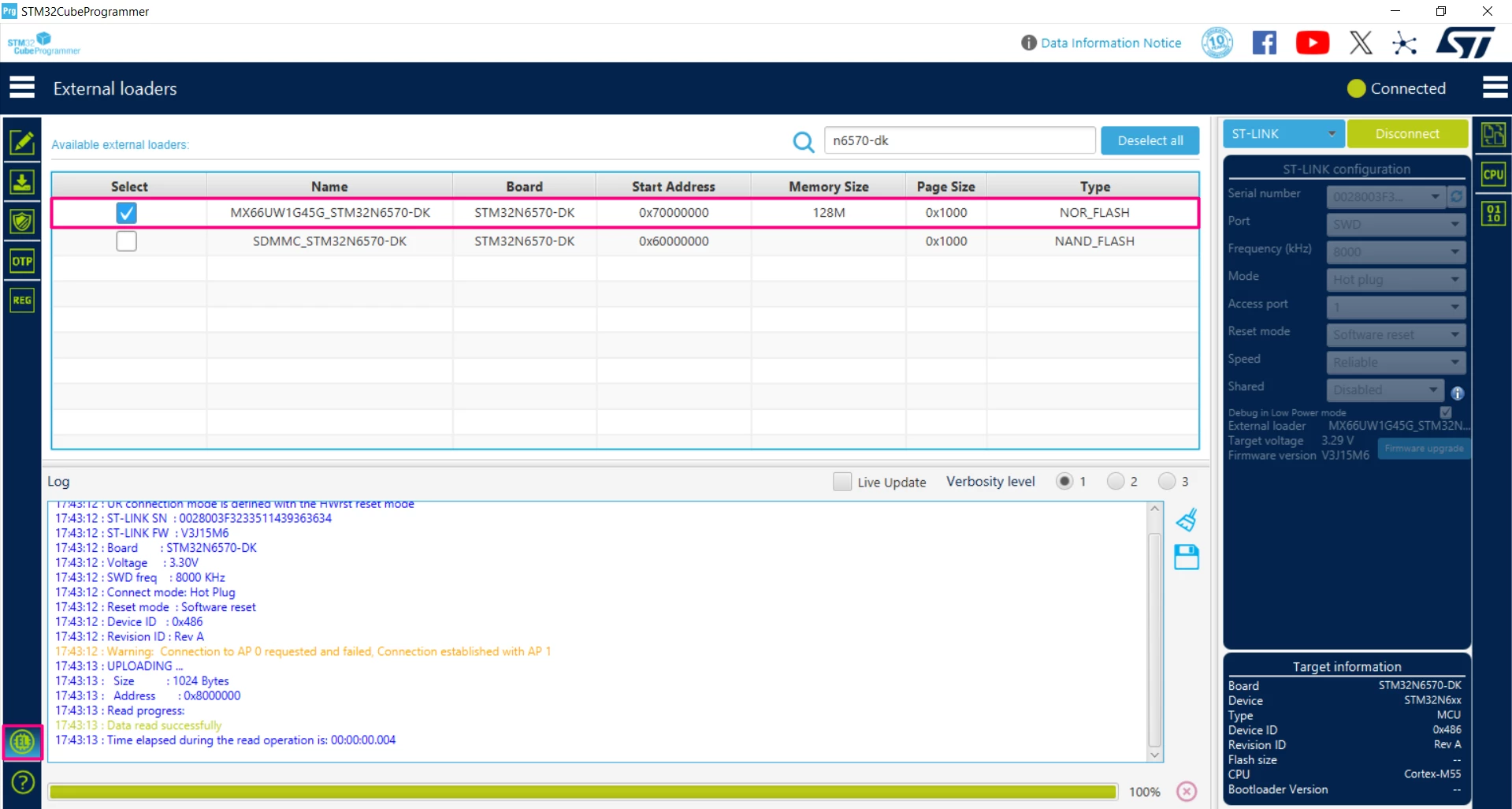

Using the STM32CubeProgrammer, make sure the external loader for the flash enabled:
Use the address [0x7000 0000] to program the FSBL binary and the [0x7010 0000] to program the secure application binary.
TIP: You might need to power cycle the board in case a failure message appears when clicking [Start Programming] and ensure it is positioned in DEV boot mode.

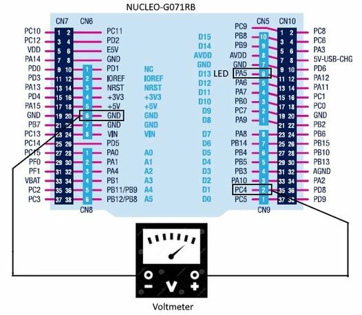

For an application I am using a STM32G071RB MCU in low-power Standby Mode with a output pin in pull-down mode. I share the solution below, hoping that it helps someone in the ST Community.
The following code snippet shows how the output pin PC4 is pulled down (0V) in the low-power Standby Mode of the STM32G0 MCU. A NUCLEO-G071RB board was used for developing and testing the code, which is based on the ST example PWR/PWR_STANDBY. The ST example was modified and expanded. These are the main steps:
  • Determine if the MCU wakes up from Standby mode then resets the appropriate flags and registers.
  • Configure and set the test GPIO output pin to HIGH. (The output will later be pulled down for verification).
  • Use the PWR_PDCR register for controlling the GPIO output state (pull down to LOW) in Standby Mode.
  • Enter the low-power Standby mode.
  • Wake up from Standby Mode by pulling the WKUP pin2 HIGH.
The output voltage before and after entering Standby Mode was measured with a voltmeter (Figure 1).
Figure 1. Pinout of the NUCLEO board
