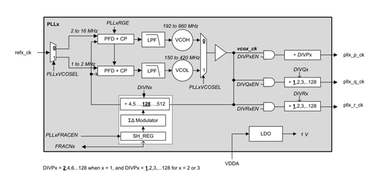

STM32H7 series have a PLL fractional (phase-locked loop) which can be updated from a DMA buffer driven by a timer.
Figure 1. STM32H7 PLL fractional block diagram from the reference manuals PLL description chapterFigure 1. STM32H7 PLL fractional block diagram from the reference manuals PLL description chapter

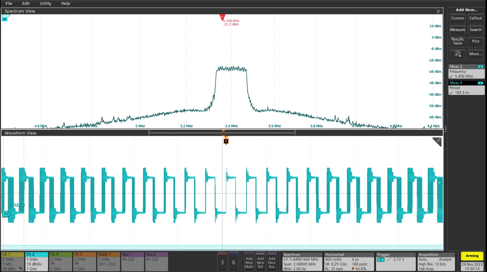

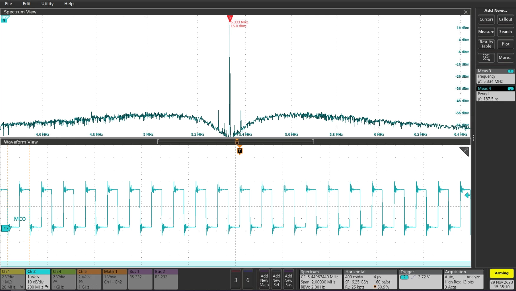

Figure 3. Clock spectrum observation on MCO output (narrow carrier)Figure 3. Clock spectrum observation on MCO output (narrow carrier)
Figure 4. Clock spectrum observation on MCO output with SSCG enabled (wide carrier)Figure 4. Clock spectrum observation on MCO output with SSCG enabled (wide carrier)

Thanks to the STM32H7 PLL fractional, timer, and DMA peripheral it’s simple to implement and shape a spread-spectrum clock generation feature. This allows to reduce the peak energy on the fundamental frequency, as well as its harmonic frequencies, keeping in mind that the generated jitter shape may not be compliant with communication standard like USB.
