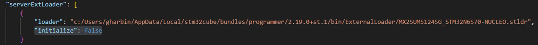

serverExtLoader object:
Field Type Description
loader string Path to the external loader file (.stldr).
initialize boolean Whether to initialize the loader at session start.

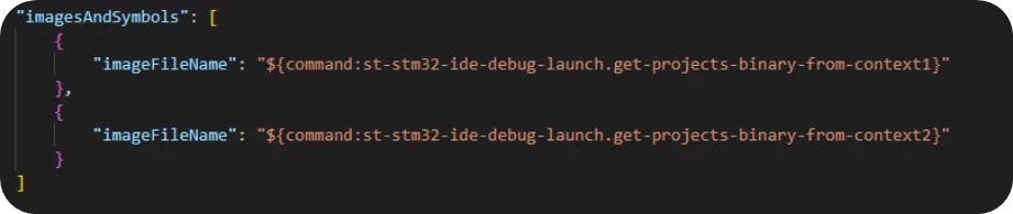

imagesAndSymbols object:
imageFileName string Path to the binary/ELF file to load.
symbolsFileName string Path to the symbols file (optional, if separate from image).

 "serverExtLoader": [
 "loader": "C:/Users/gharbin/AppData/Local/stm32cube/bundles/programmer/2.21.0-a10/bin/ExternalLoader/MX25UW25645G_NUCLEO-H7S3L8.stldr",
 "initialize": false
 "imagesAndSymbols": [
 "imageFileName": "${command:st-stm32-ide-debug-launch.get-projects-binary-from-context1}"
 "imageFileName": "${command:st-stm32-ide-debug-launch.get-projects-binary-from-context2}"

  1. Create a launch.json.
  2. Add a second image to be loaded.
  3. Change the context for the new created image.
  4. When launching the debug, the selected bin must follow the order nonsecure then secure.
  5. Save your presets for later use if needed.

5.3 How to debug a project with an external loader
  1. In your current launch.json, add a "serverExtLoader" parameter to configure the external loader.
  2. Add "loader" in "serverExtLoader" and set the extloader path.
  3. Keep "initialize" set to false.
