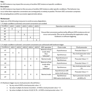

STM32G491xx STM32G4A1xx
ES0523 Rev6
(Jun 2024)
Update section: 2.5.11 An ADC instance may impact the accuracy of another ADC instance at specific conditions
Expected:
Jun 2026

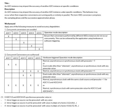

STM32G431xx
STM32G441xx
ES0431 Rev9
(Jun 2024)
STM32G471xx
STM32G473xx
STM32G474xx
STM32G483xx
STM32G484xx
ES0430 Rev9
(Jun 2024)
Update section: 2.7.11 An ADC instance may impact the accuracy of another ADC instance at specific conditions
Expected:
Jun 2026
