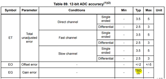

STM32H735xG
DS13312 Rev 4
(Nov 2023)
Table 89. 12-bit ADC accuracy
Expected:
EG Typical = +/-2 LSBs
EG Max = +/-5 LSBs
May 2024

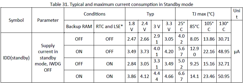

STM32H735xG
DS13312 Rev 4
(Nov 2023)
Table 31. "Typical and maximum current consumption in Standby mode"
Current:
The max values are present for “RTC and LSE” ON
Expected:
The max values for “RTC and LSE” should be placed for “RTC and LSE” OFF
Aug 2024
