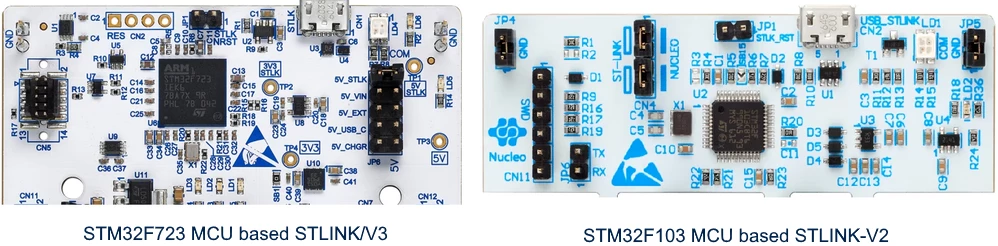

FDCAN communication needs the usage of an accurate clock source such as a crystal. NUCLEO boards were used to run FDCAN @ 8 Mb/s example. Since most of the used NUCLEO boards do not have a crystal connected to the target MCU HSE pins, STLINK MCO output is used in this case with HSE in bypass mode.
Some NUCLEO boards have STLINK/V2 while others have STLINK/V3 (see figure 1 below). For the STLINK/V2 boards, the STLINK MCO output clock is generated from the external Crystal connected to the MCU managing the STLINK/V2 (STM32F103 MCU) generating 8MHz.
For the STLINK/V3 boards, the MCO is configurable and the default clock source is generated from HSI/2 = 8 MHz (managed by the STM32F723 MCU) which is not recommended in CAN communication. In this case, we need to modify the STLINK-V3 MCO output frequency using STM32CubeProgrammer or STLINK firmware upgrade tools. Refer to this article on how to use STLINK-V3 MCO output on NUCLEO boards as a precise clock source for STM32.
Figure 1. Nucleo STLINK modulesFigure 1. Nucleo STLINK modules
To run the examples correctly, you need first to check if the NUCLEO is having ST-LINK/V2 or V3 version to set the correct frequency value for HSE.

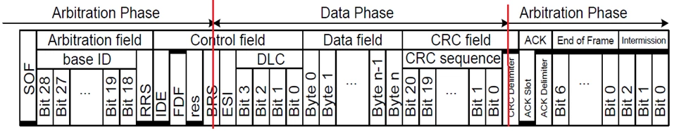

2. FDCAN bit time configuration
The CAN FD frame has two bitrates on each phase: arbitration phase and data phase (See figure 2).
Figure 2. CAN FD frame and the different phasesFigure 2. CAN FD frame and the different phases
Source for figure 2:
Hartwich, F. (2013). Bit Time Requirements for CAN FD. Robert Bosch GmbH.
Retrieved from https://www.bosch-semiconductors.com/media/ip_modules/pdf_2/papers/icc14_2013_paper_hartwich_1.pdf
In the arbitration phase, nominal bitrate is used, while in the data phase, data bitrate is used.

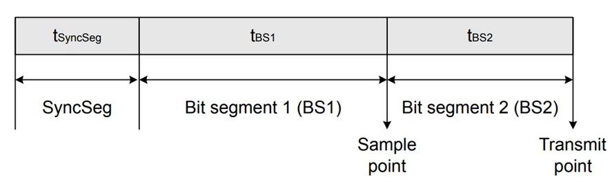

The CAN bit time is the inverse of the bitrate: bitrate = 1 / bit time. The bit time is the sum of three components like shown in the figure 3.Figure 3. CAN bit timeFigure 3. CAN bit time
Source for figure 3: AN5348, Rev 4: Introduction to FDCAN peripherals for STM32 MCUs.
CAN bit time is the sum of different segments:
CAN bit time = tSyncSeg + tBS1 + tBS2
Where:
tSyncSeg = 1 tq (fixed)
tBS1: Bit time segment 1 = DataTimeSeg1 (in Cube HAL)
tBS2: Bit time segment 2 = DataTimeSeg2 (in Cube HAL)

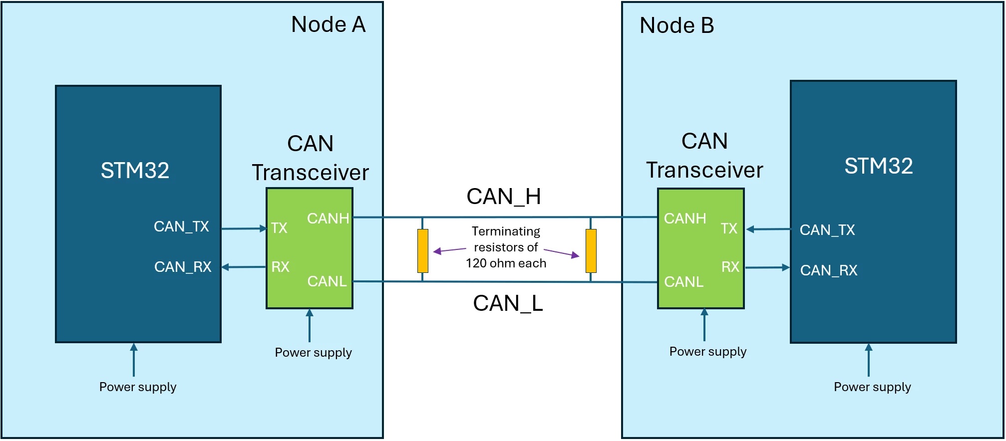

3. Hardware setup
A basic CAN bus structure needs to be used to run the examples (figure 4). Two nodes are connected to the CAN bus with FDCAN transceivers.
Figure 4. CAN bus structure used with the exampleFigure 4. CAN bus structure used with the example

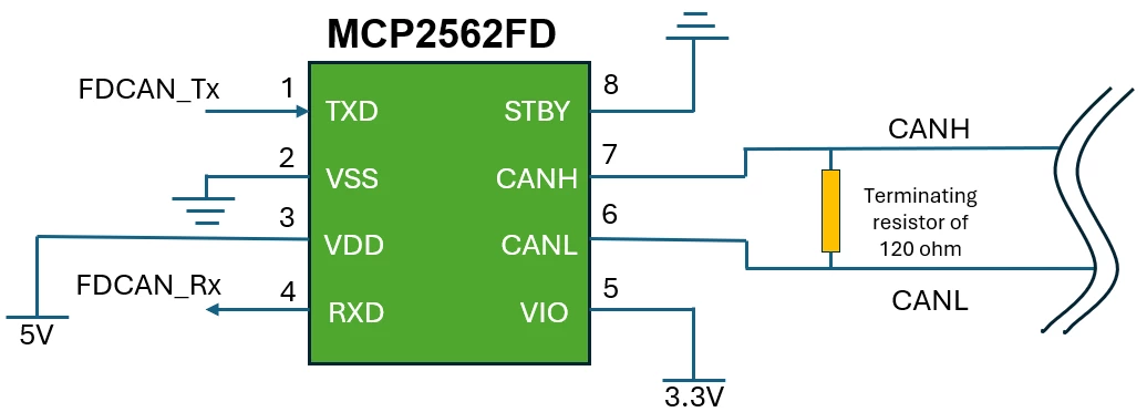

The transceiver that has been used to run the FDCAN examples at 8 Mb/s is the MCP2562FD. It supports a CAN communication bitrate up to 8 Mb/s (see figure 5 for the hardware used). Note that if the transceiver does not support the communication bitrate to be used, the communication fails. So, please ensure to use the adequate FDCAN transceiver and refer to the transceiver datasheet.
Two terminating resistors of 120 ohm are connected on both ends of the bus.
The examples have been tested using two meters of twisted-pair wires.
Figure 5. Transceiver schematics using the MCP2562FDFigure 5. Transceiver schematics using the MCP2562FD

2 replies
debugging
Lead
Jan 4, 2025 2:18 AM UTC
Pin 5 should be Vio
mƎALLEm
mƎALLEmAuthor
Jan 7, 2025 10:57 AM UTC
@debugging
Thank you for raising the issue. It's updated now.
