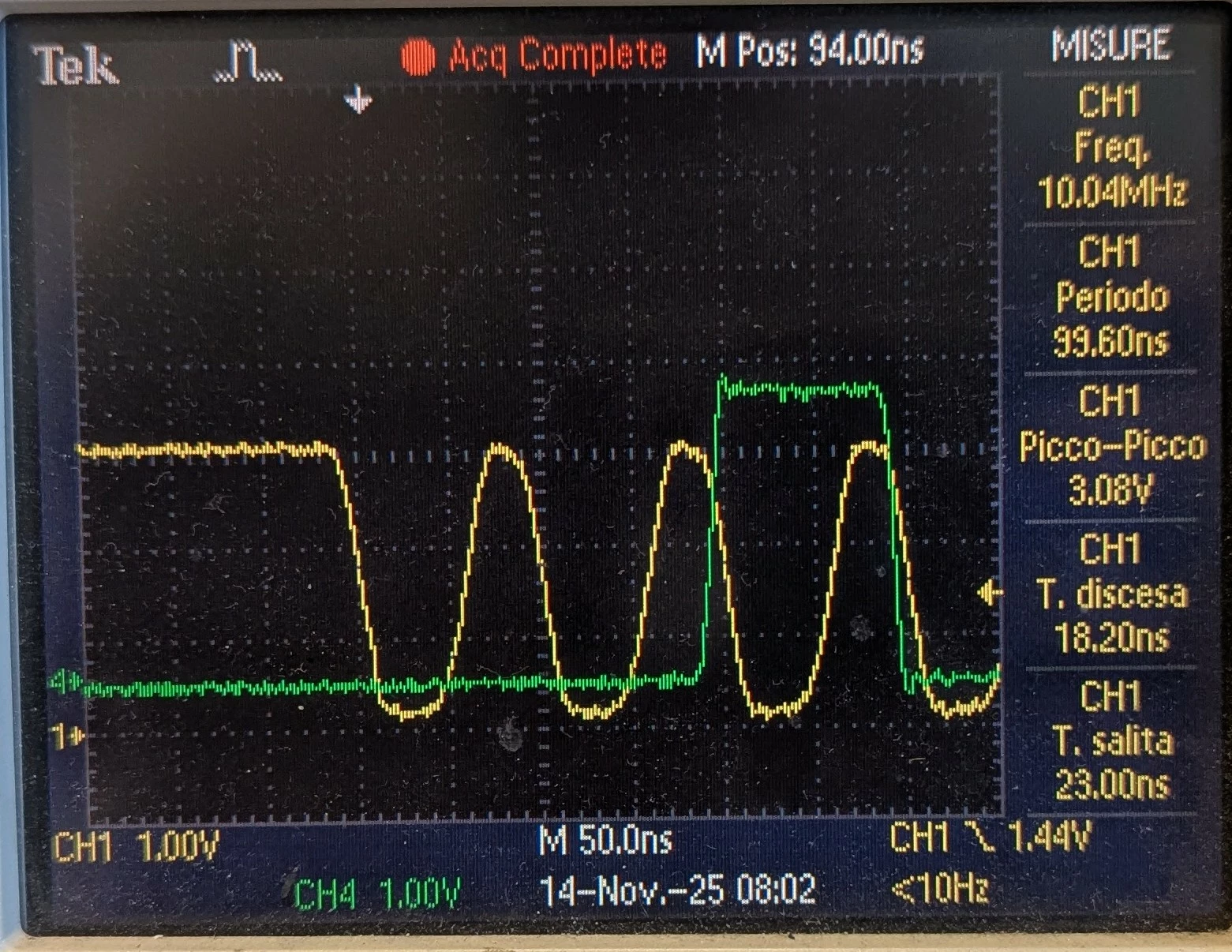

Nov 14, 2025 9:28 AM UTC
I’m using STM32H523RCT6 with SPI2_SCK on PB13.
I just discovered this issue on this post.
My SCK is configured to 10MHz and this is the result.
CH1 – YELLOW – SPI2_SCK (PB13)
This SPI is used to drive a 2 inch display 176 * (RGB) * 220 Dots with ST7775R so I’d like to keep the frequency as high as possible.
I’ve done some basic tests writing bmp images to the screen and I see no issue even though the SCK is very dull.
What problems should I expect in the long run if I keep this configuration?

Nov 14, 2025 9:37 AM UTC
1. set pin speed hi.
2. use 10:1 probe at scope (+ adjust/calibrate probe!)
If already done this way, i would try using other pin (PB10 ? ) - or accept the slow pin speed. From ds should be good only up to 3 MHz....

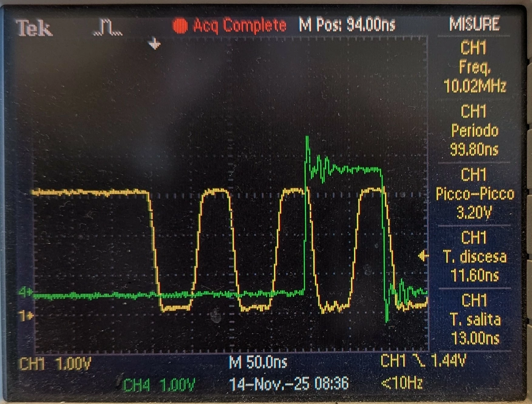

ACots.2
Nov 14, 2025 9:59 AM UTC
thanks for the reply.
1. Indeed my pin speed was GPIO_SPEED_FREQ_LOW, now I set it to GPIO_SPEED_FREQ_VERY_HIGH
2. The probe was already x10
I see some improvement.
But now I'm curious, so the issue on this post that PB13 can go maximum at 3MHz is not true?
Can I push it to 10MHz witout future issues even though the signal is not perfect?

Nov 14, 2025 10:08 AM UTC
now looks better .
You cannot use PB10 on your design? (alternative pin)
As pin is ft_c ->
it should be no problem. (is it just for yourself or a design to be sold in large quantities ? Then i wouldnt do it.)
