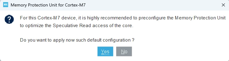

5.1 Configuring Cortex®-M7 with STM32CubeMX
When starting a project in STM32CubeMX with a product having Cortex®-M7 core, for example STM32H7xx or STM32F7xx, the tool proposes and recommends to the user to configure the MPU unit. This is to prevent any speculative access to the uninitialized external memories as shown in figure 1.
Figure 1. CubeMX pop-up for MPU configuration
If the user clicks yes, STM32CubeMX generates the MPU_Config() function, relative to MPU configuration, in the main.c file. It generates in fact a background MPU configuration.

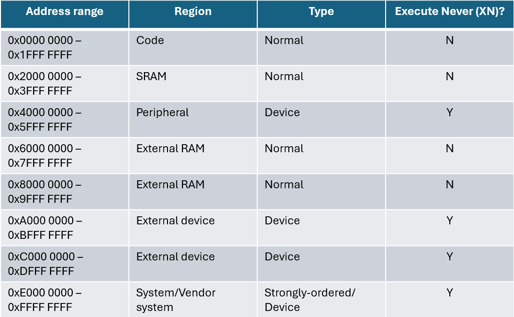

5.1.1 Explanation
Table 1 below shows the default memory attributes of the Cortex®-M7.
Table 1. The default memory attributes of the Cortex®-M7
The “External RAM” (0x6000 0000 – 0x9FFF FFFF) memory region is critical, since it is by default normal memory type and executable (XN=N). So, the Cortex®-M7 may perform speculative reads to this area, even when there is no external memory connected.

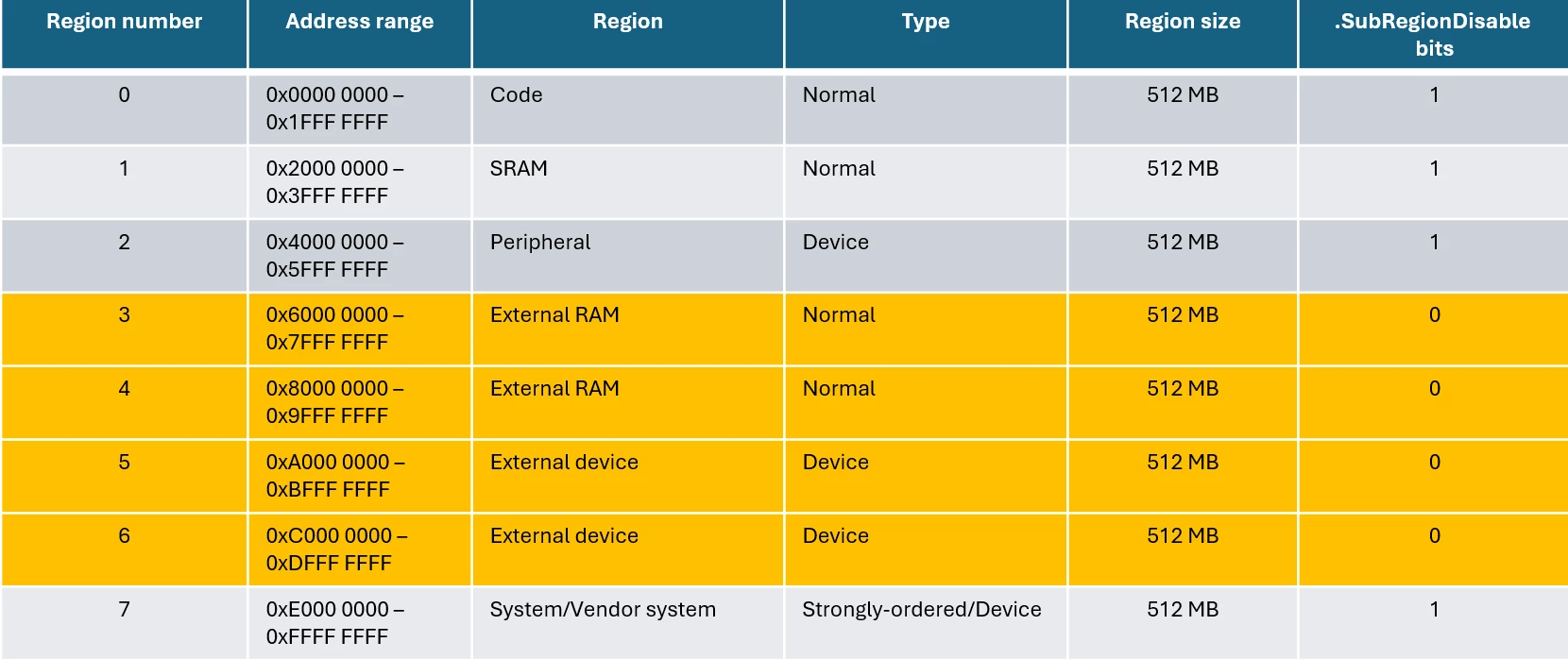

The idea is to create a safe background region (region 0), where memory the attributes of the “External RAM” memory region are changed to strongly-order to prevent any speculative access to that region.
This MPU configuration makes 4 GB (the total memory address range seen by the core) not accessible except subregions set to 1 in MPU_InitStruct.SubRegionDisable structure member.
Table 2. Memory regions to deactivate the access for the CPU with MPU background configuration

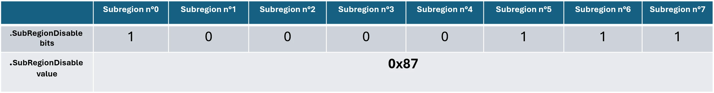

The SubRegionDisable means do not apply the MPU setting to the subregions having bits set to 1. In a given MPU configuration, a region is divided into 8 subregions of equal size. If you examine the default Arm MPU memory map covering the full 4 GB address space, notice that it is split into eight 512 MB address ranges (see Table 2).
As a result, four 512 MB subregions are selected by this MPU configuration over the range 0x6000 0000 to 0xDFFF FFFF (marked with yellow in table 2). It corresponds to the external memory interfaces such as FMC, QSPI, OSPI, and others.
MPU_InitStruct.SubRegionDisable = 0x87 = 0b1000 0111 means each bit set to 1. Do not apply the current MPU config to that subregion. Refer to Table 3 of the subregion’s summary.
Table 3. The subregion disable value to be set
If the application needs an external memory to be used, the user must configure and enable a new MPU region to allow access to that memory address range. Knowing that the previous background region number is set to 0. The user needs to start the new MPU region from region number 1.

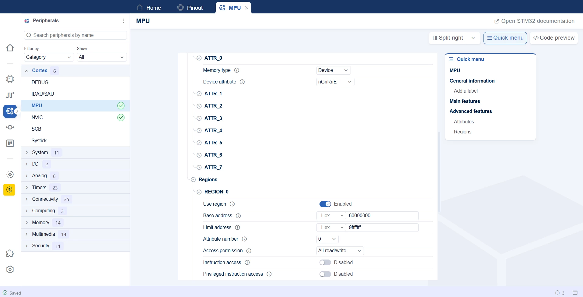

5.2 Configuring Cortex®-M85 with STM32CubeMX2
As the Cortex®-M85 implements a memory protection unit (MPU) based on PMSAv8, the previous code from Cortex®-M7 should be changed to adapt with the new implementation. Cortex®-M85 MPU does not allow regions that overlap (no background region can be defined as for Cortex®-M7 example). However, the new implementation allows having a flexible start and size for the region. For more details, refer to: Armv8-M Memory Model and Memory Protection User Guide
STM32CubeMX2 configures attributes for external memory to prevent speculative access. It uses attribute index 0, configured as Device-nGnRnE (Device memory type, no Gathering, no Reordering, and no Early write acknowledgment) equivalent to strongly-ordered in Cortex®-M7.
Figure 2 shows the default configuration applied by STM32CubeMX2 for Cortex®-M85
Figure 2. MPU configuration to prevent speculative access in CubeMX2 for Cortex®-M85
CubeMX2 generates mx_cortex_mpu_init() function in the mx_cortex_mpu.c file as follows:
HAL_CORTEX_MPU_SetDeviceMemAttr(HAL_CORTEX_MPU_MEM_ATTR_0,
HAL_CORTEX_MPU_DEVICE_MEM_NGNRNE);
This helps define external memory as a device type region, reducing speculation issues. A typical MPU region configuration for external memory protection may look like this:
p_region_config.base_addr = 0x60000000;
p_region_config.limit_addr = 0x9FFFFFFF;
p_region_config.access_attr = HAL_CORTEX_MPU_REGION_ALL_RW;
p_region_config.exec_attr = HAL_CORTEX_MPU_EXECUTION_ATTR_DISABLE;
p_region_config.priv_exec_attr = HAL_CORTEX_MPU_PRIV_EXECUTION_ATTR_DISABLE;
p_region_config.attr_idx = HAL_CORTEX_MPU_MEM_ATTR_0;
HAL_CORTEX_MPU_SetConfigRegion(HAL_CORTEX_MPU_REGION_0, &p_region_config);
HAL_CORTEX_MPU_EnableRegion(HAL_CORTEX_MPU_REGION_0);
5.2.1 Explanation
Region 0 configuration applies protection to the external memory range from 0x60000000 to 0x9FFFFFFF by allowing read and write access while disabling instruction execution and privileged execution. In addition, apply the device memory attribute defined in attribute index 0, nGnRnE.
This is a common and effective method for reducing the risk of speculative access to external memory. If the application needs to use external memory for code execution or as regular data memory, the MPU region base address and limit must be adjusted to permit access to the required address range. An additional MPU region may also be necessary to protect the portion of the external memory that is not in use.
