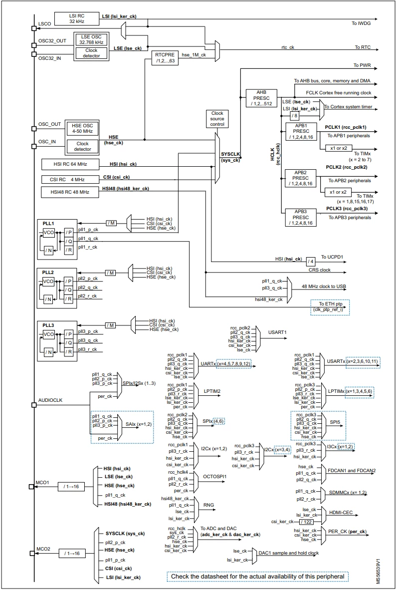

Generally, you can find information about clock sources in the datasheet, in the electrical characteristics paragraph or in the clock tree of your product's reference manual:
Clock TreeClock Tree
  1. High-Speed External (HSE) Clock: An accurate external oscillator with frequencies ranging from 4 MHz to 50 MHz
  2. High-Speed Internal (HSI) Clock: A 64 MHz internal RC oscillator, less accurate than HSE but with a faster startup time
  3. Low-Speed External (LSE) Clock: A 32.768 kHz external oscillator, typically used for real-time clock (RTC) applications
  4. Low-Speed Internal (LSI) Clock: A 32 kHz internal RC oscillator, used for low-power operations
  5. Clock Security System (CSI): A 4 MHz internal RC oscillator, balancing power consumption and startup time
  6. HSI48: A 48 MHz RC oscillator, primarily used for USB and RNG peripherals

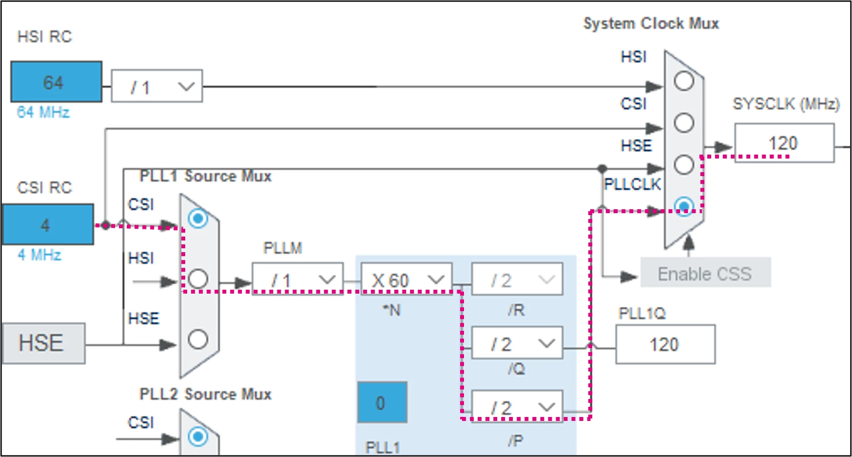

In this example, we try to achieve a SYSCLK of 120 MHz using different configurations.
Starting from the STM32CubeMX clock configuration:
STM32CubeMX clock configurationSTM32CubeMX clock configuration
Configuration 1: CSI (4 MHz) → Divider (/4) → Multiplier (x240) → Divider (/2) → SYSCLK = 120 MHz
Configuration 2: CSI (4 MHz) → Divider (/1) → Multiplier (x60) → Divider (/2) → SYSCLK = 120 MHz
Configuration 3: CSI (4 MHz) → Divider (/2) → Multiplier (x240) → Divider (/4) → SYSCLK = 120 MHz
All above configurations yield the same SYSCLK frequency, but their performance and power consumption may differ.

The primary consideration when choosing a configuration is the jitter and stability of the PLL. Higher multiplication factors can introduce more jitter, which is detrimental to the performance of analog peripherals like ADCs and DACs.
Configuration 2, with a lower multiplication factor (x60), is likely to have better jitter performance compared to other configurations (x240).
