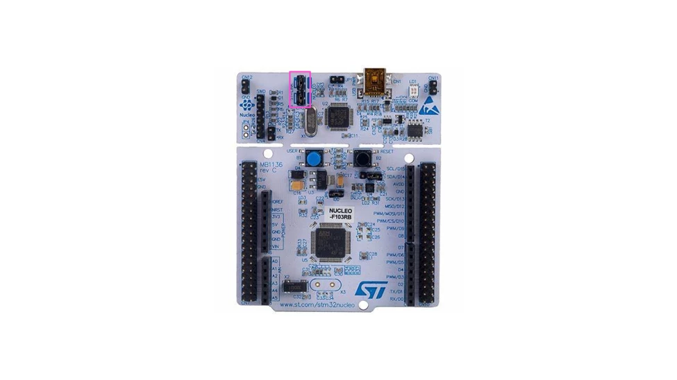

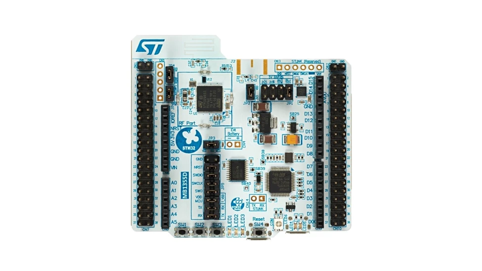

On the NUCLEO-WB55RG, we have an embedded ST-LINK/V2-1. However, for several reasons, users may want to use an external ST-LINK for debugging or programming. In this article, I demonstrate a simple use case of programming an STM32WB55RG Nucleo board with the on-board ST-LINK/V2-1 of a NUCLEO-F103RB.
1. Boards used

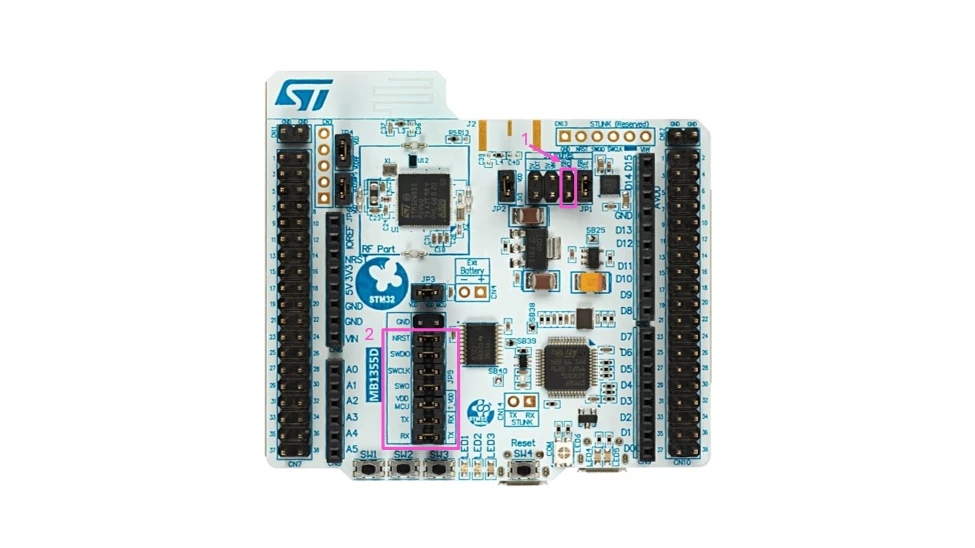

A STM32WB55RG that we program:

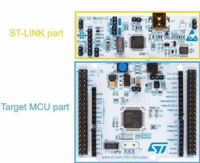

The ST-LINK part of a Nucleo board with the reference MB1136 (NUCLEO-F103RB in this case):

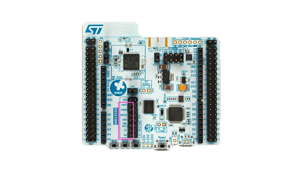

First, we need to disconnect both jumpers of the CN2 of our NUCLEO-F103RB.
Fit the jumper JP1 of the NUCLEO-WB55RG to select the USB MCU as 5 V source. Remove all the jumpers from the JP5.
Finally, connect the pins from the CN4 of the NUCLEO-F103RB to the pins of the JP5 of the NUCLEO-WB55RG. Follow the description in the table below.
GND GND
NRST NRST
SWDIO PA13
SWCLK PA14
SWO PB3
VDD_TARGET VDD
Important note
Use the pins on the right of the JP5 (the STM32WB pins). Do not use the on-board ST-LINK pins (the pins on the left of the NUCLEO-WB55RG).STTwo32_4-1729838572996.png
