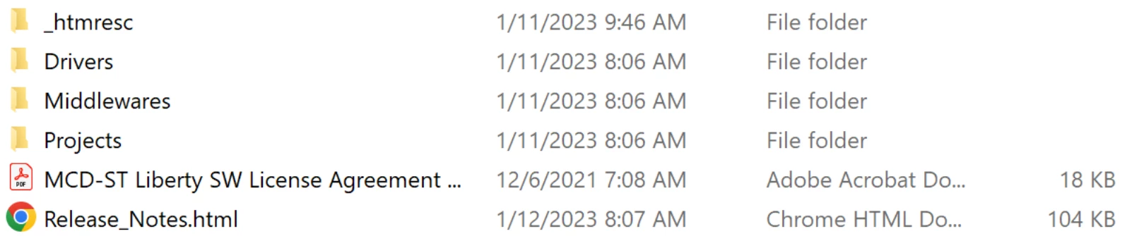

1. Package Directory Structure
The package is broken up into three major folders: drivers, middlewares, and projects.
The drivers folder contains the HAL and LL drivers for the various devices. The middlewares folder contains that EEPROM emulation software. The projects folder contains premade projects that are ready to run on STMicroelectronics development boards.
The projects folder is useful for understanding how to interact with the EEPROM emulation API. However, it does not provide insight into how to include the EEPROM emulation software into your particular project.

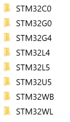

The porting folder contains subdirectories that contain the files necessary for working with a specific family of MCU:
Each one of these MCU specific folders contains two files, flash_interface.c/.h
This defines how the package interacts with the internal flash memory, and thus is different different for each MCU family, unlike the source code found in the Core folder.
