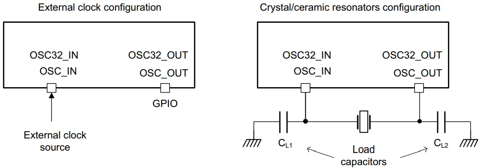

1. HSE, also known as "high-speed external clock." External clock can be derived from two sources:
Source one:
The external clock can be fed to the MCU through the OSC_IN pin and OSC_OUT can be left as high-Z or used as a GPIO. For example, an IC chip with an integrated oscillator circuit (that is, not using MCU’s internal oscillator circuit) and a resonator can feed the clock to theOSC_IN pin. This solution is convenient because it saves you the effort of designing an external resonator circuit. A more specific example of such a system is the NSC5004A-25M. In this mode, the internal MCU oscillator is bypassed.
Source two:
The external clock can be generated by an external resonator and be interfaced with both the OSC_IN and OSC_OUT pins. For this solution, you design an external resonator circuit that interfaces with the internal oscillator circuit of the MCU. You can refer to the section 2.4 "oscillator circuit design" below for more details.
Figure 1: RM0492: Example of external clock source and external resonator circuit clock. Resonator and load capacitors must be picked by the hardware designer. Refer to AN2867.

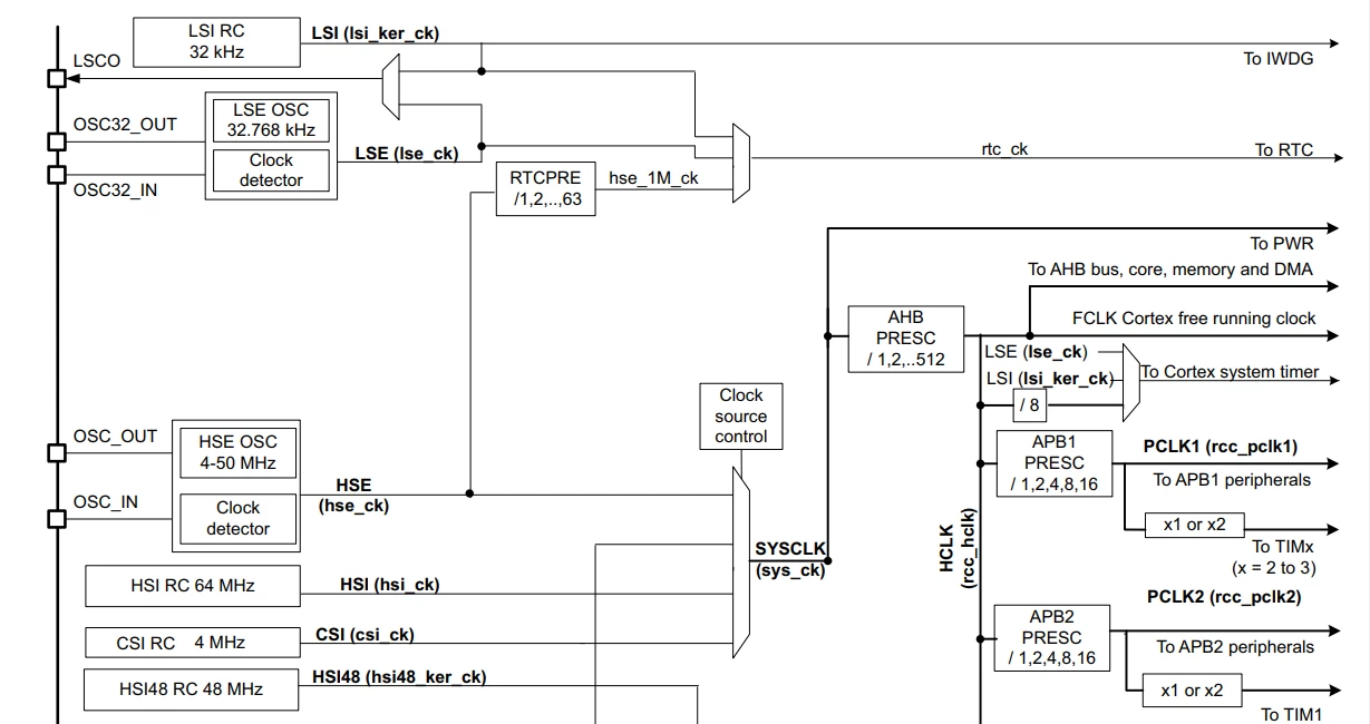

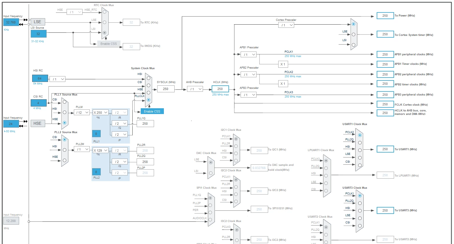

3. Clock tree
3.1 STM32H503 Clock Tree
Figure 2 shows the clock tree diagram as found in the STM32H503 reference manual, RM0492. The tree diagram depicts all system clock distributions. It stats from the source and moves through PLL and the prescalars, then ends at the consumer (bus and peripherals).
For most applications, the clock frequencies provided by the resonators are not sufficient, therefore we must use another module to increase the clock speed. The PLL (clock feedback control system) increases the clock frequency to satisfy the peripheral clock speed requirement.
Figure 2: RM0492: Clock tree diagram that is typically found inside the reference manual of any STM32.

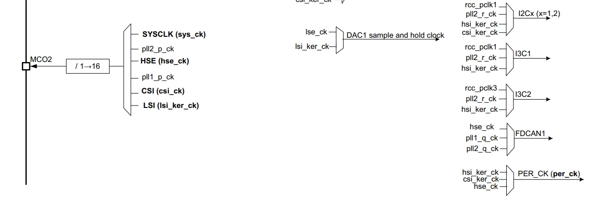

MCO1
Output
This pin is used to direct the clock to an output pin. See the clock tree for details about which clock sources are connected to this pin.
MCO2
Output
Same as MCO1.

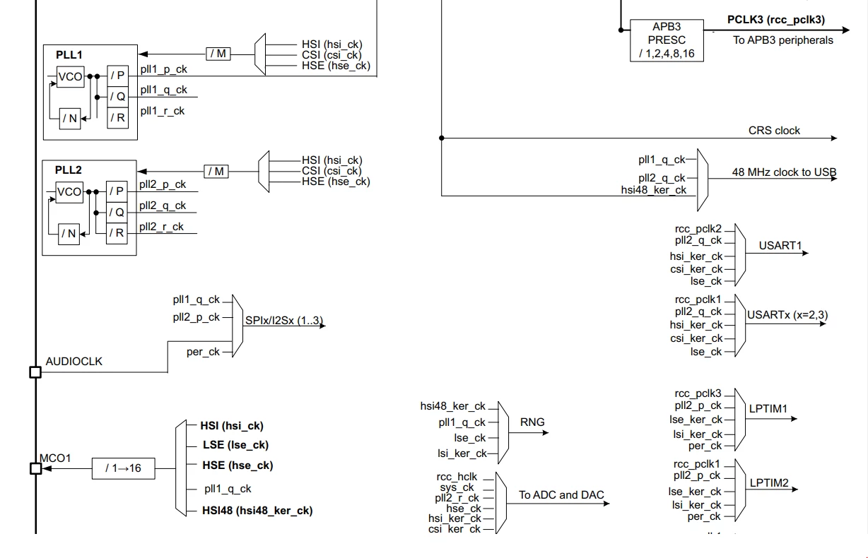

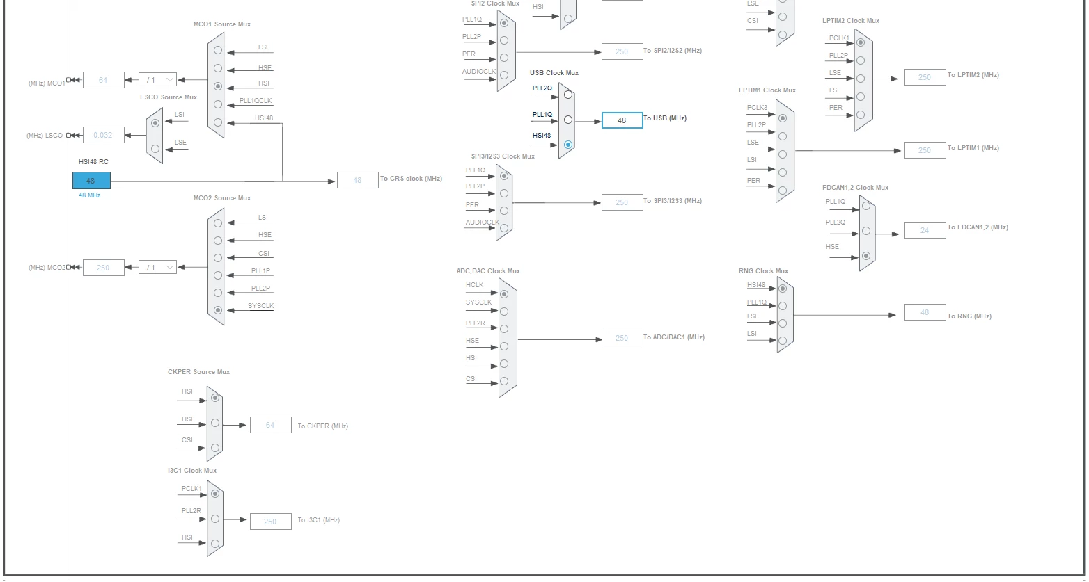

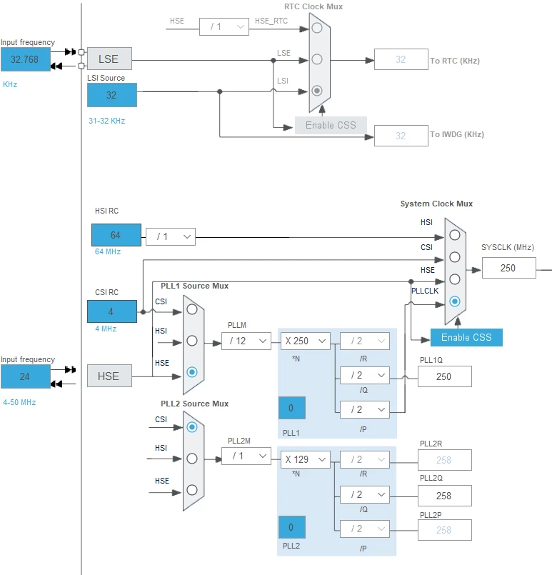

Figure 3 illustrates an example of the STM32H503RB MCU clock tree, which can be found under the “Clock Configuration” tab of STM32CubeMX "configurator." A convenience regarding the clock configurator is that you do not have to perform any calculations for your desired clock speed. Any potential clock conflicts are automatically resolved by this tool.
Figure 3: STM32CubeMX clock configurator tab for the STM32H5: Clock tree diagram as shown in STM32CubeMX interface.
In figure 3 above, the CPU clock is configured by the blue HCLK box near the top of the STM32CubeMX clock configuration tree.

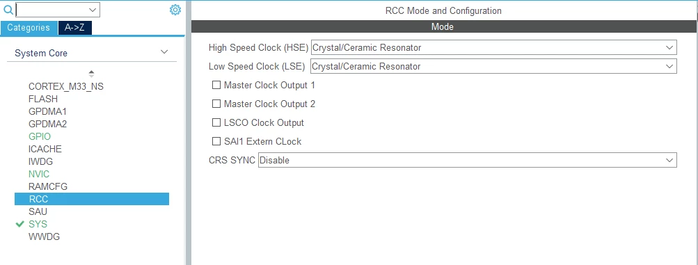

To enable external resonators, we must select the “Crystal/Ceramic Resonator” option inside the RCC peripheral. Through RCC, we can also output the generated clock from the clock tree through master clock output 1, 2, LSCO, and SAI1 extern clock. Clock recovery system (CRS) is used to trim the frequency (up or down) when a resonator frequency leaves a set threshold.
Figure 4: STM32CubeMX configurator: enable HSE and LSE through RCC peripheral.

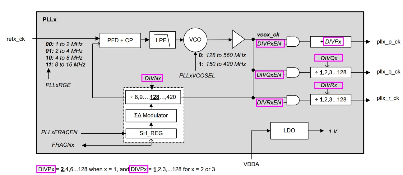

An example of a generalized view on one of the PLL modules is shown in figure 5. In the case of STM32H503, there are two PLLx modules (PLL1 and PLL2). PLL1 is generally used to provide the clock to the CPU and some of the peripherals. PLL2 is used to generate the kernel clock. See section 8 "kernel clock" for more details on kernel clock for the peripherals.
Figure 5: PLL feedback control system used to increase resonator clock speed.
Figure 6 shows the PLL module configuration inside the STM32CubeMX clock configuration tab. Through the parameters M, N, R, Q, P, we can increase or decrease resonator clock speed in fine increments.
