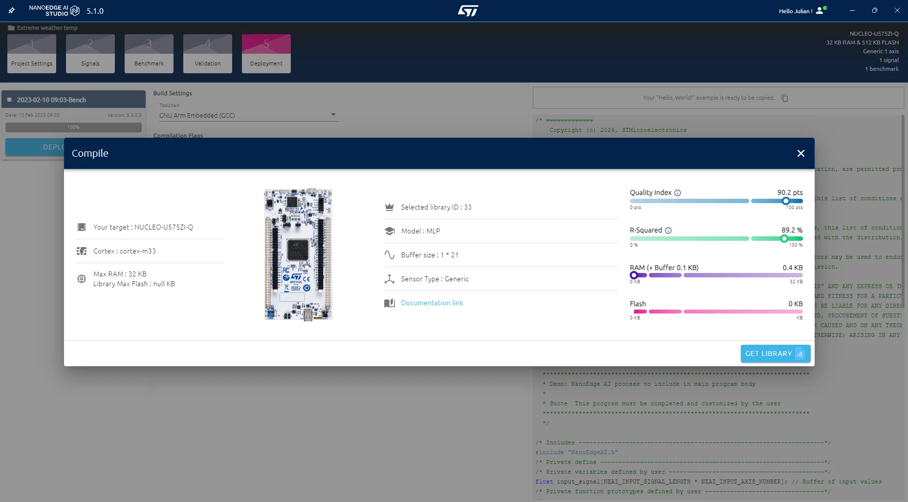

In NanoEdge AI Studio, first compile all the libraries you need in the Deployment step.
Note: you need to unzip the generated files and put each library into its own folder.

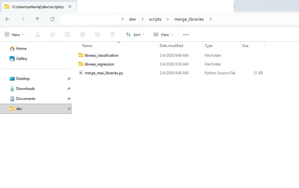

In this example, we use 2 libraries:
  • An extrapolation library
  • A classification library
Then open a terminal and run the following command:

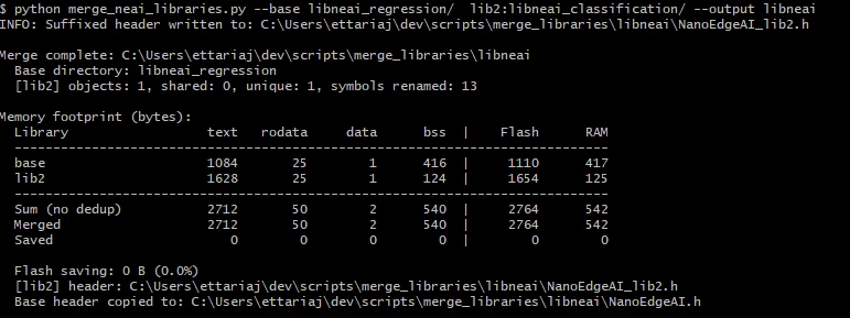

python merge_neai_libraries.py --base libneai_regression/ lib2:libneai_classification/ --output libneai
You should get this output:

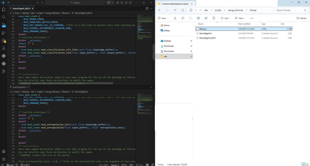

Finally, you get a new folder containing a single libneai.a, which is the result of merging all the libraries, and a .h header file for each library containing the functions to use in your embedded project.
