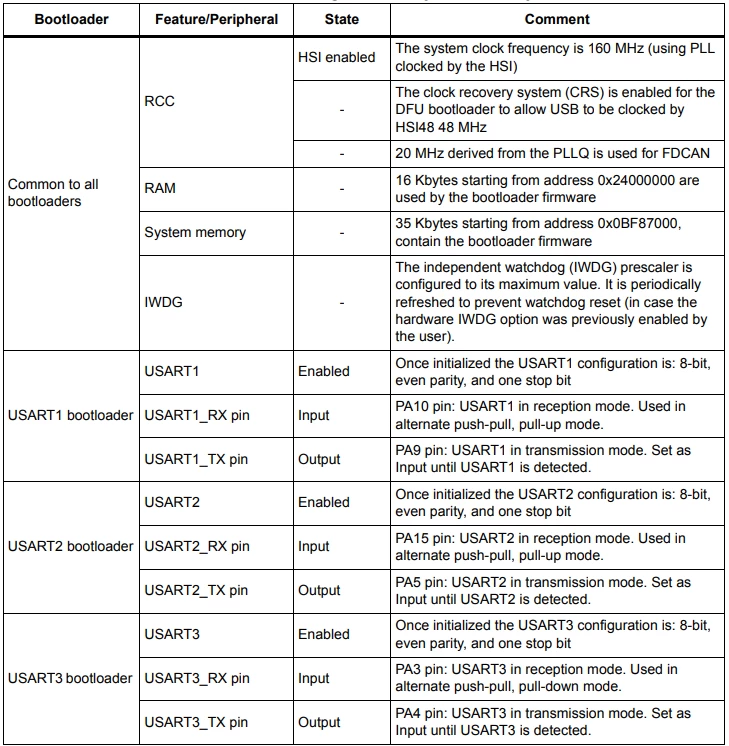

4. Booting into the UART/USART system bootloader

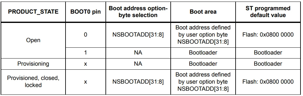

First determine the requirements for booting into the system memory where the bootloader is located. To use the system bootloader, we set the BOOT0 pin to 1 as shown below in table 1. NOTE: Some STM32 series have a slightly different method of accessing the system memory. For example, option bytes might have to be changed. Be sure to see the reference manual of your MCU for how to boot into the system memory.
Table 1: Reference manual: STM32H503 boot modes
We use the Nucleo-H503RB, however, you can use other STM32 series (keep in mind the process of booting into the system bootloader is different for every STM32 series).

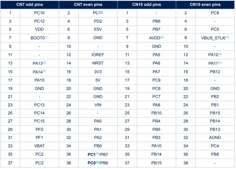

Table 2: User manual: The first column (CN7) shows where “BOOT0” is located on the Nucleo board. “VDD” is located on pin 5 of CN7 on the Nucleo board.
 Figure 1: User manual: Nucleo-H503RB pin numbered at the back side of the MCU.
To set BOOT0 to 1, we will simply short pin "BOOT0" to pin "VDD" (locate the pins on your sample board using the figure 2 schematic). You can use the provided spare jumpers on your Nucleo board, from CN11 or CN12 to short the pins.

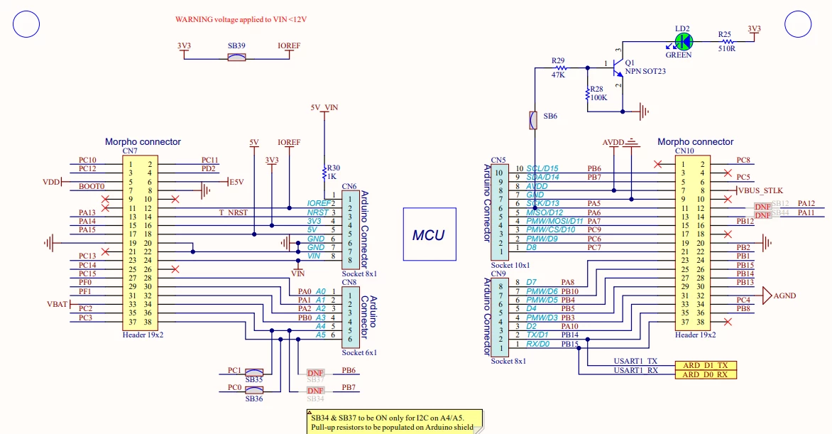

 Figure 2: Nucleo-H503RB board pin schematic found on the STMicroelectronics website [5].
Completing the above step (jumping into the bootloader), we are now ready to use the application note AN2606 [1] to activate the system bootloader. Using table 3, we will arbitrarily (and for ease of access to the pins) pick one of the USART interfaces for system bootloader communication. In this case, we choose the USART2 bootloader as our communication interface. Notice the comment section for "USART2" - later, we transfer these settings to our serial terminal software (i.e "AccessPort").

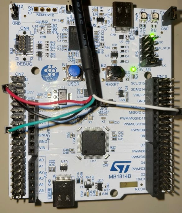

For establishing communication with the bootloader via the PC, we use the Adafruit 954 USB to TTL serial cable. For this cable, there are four wires: red power, black ground, white Rx into the USB port, and green Tx out of the USB port. The power pin provides the 5 V @ 500 mA direct from the USB port. The Rx/Tx pins are 3.3 V level for interfacing with the most common 3.3 V logic level chipsets.
Table 4: Nucleo board to USB/TTL serial translator.
Nucleo board GPIO column MCU pin location TTL/USB serial translator wire
CN7  PA15 (Rx) Green (Tx)
CN10 PA5 (Tx) White (Rx)
CN7  VDD Red
CN7 GND Black
 Figure 3: USB to TTL translator connected to the Nucleo board. USB end connected to PC with serial terminal.

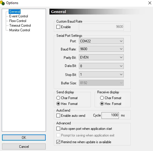

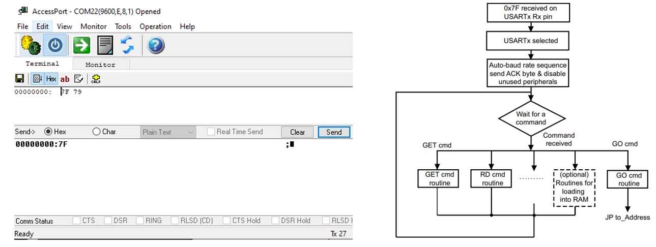

Launch the AccessPort program and click on the "configuration" tab with the yellow and green gear icon as shown. Make the settings (aside from the "Port") similar to figure 4.
You can choose any baud rate (see the accepted max and min baud rate in the application note AN3155 [2]). The rest of the settings are derived from table 3.
Figure 4: AccessPort: UART communication settings.
It is important to firstly activate the UART bootloader, before calling any bootloader commands as shown in figure 5 below. The start byte "7F" is sent from the serial terminal to activate the USART/UART bootloader. The bootloader responds with "7F 79" where "79" indicates we have now activated the USART/UART system bootloader.
Figure 5: AccessPort: On the left image, We initiate communication with THE UART bootloader by sending “7F” start byte to the MCU and the MCU responds back with “79” (ACK). Flow chart is from AN3155 [2].
After observing the "79" ack response, we are now ready to send commands to the system bootloader.
