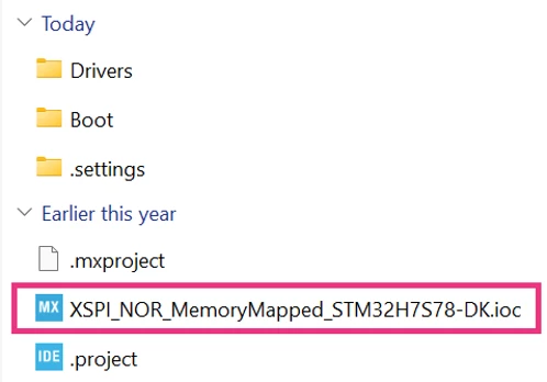

Step 2: Extract the file and open the “.ioc” file

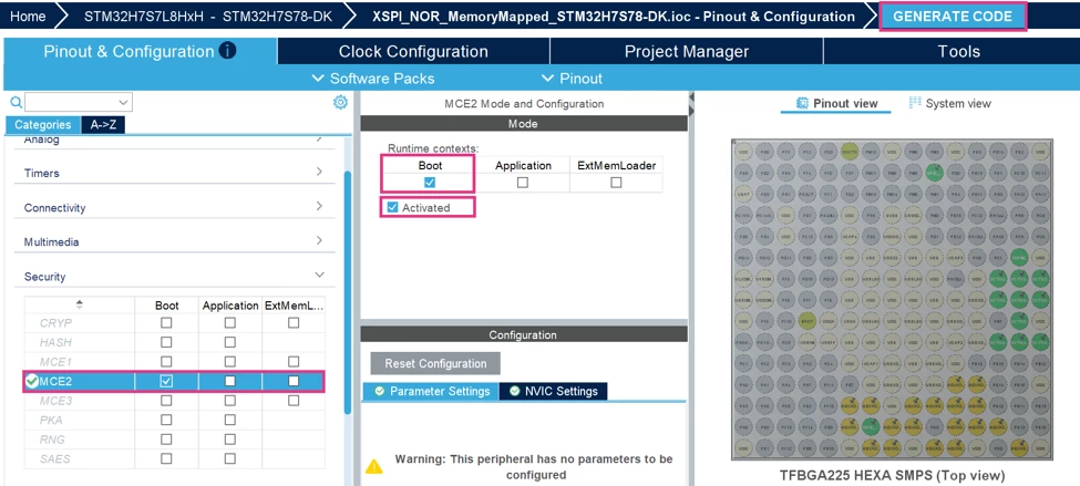

Step 3: MCE mode, configuration and generate code
Activate MCE2 as shown in the screenshot below.

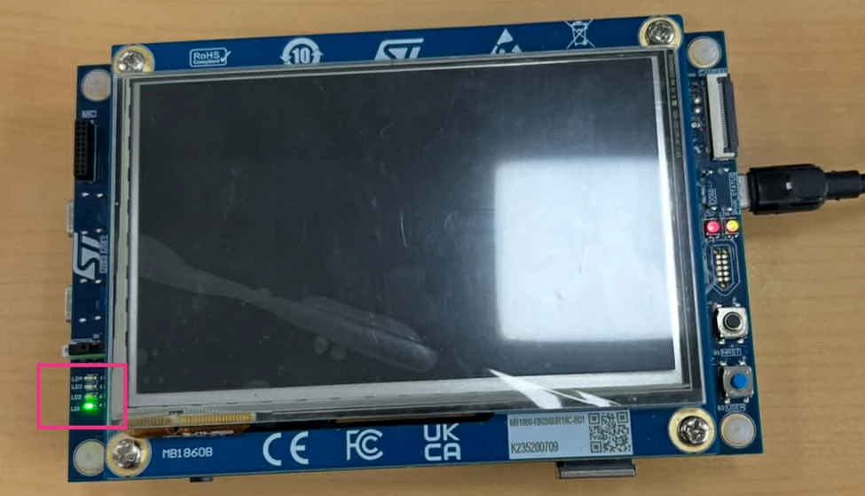

In addition, the result is visible on the board: The green LED turns on. This confirms that the data written to the external flash memory is read back correctly. Also, the MCE2 encryption and decryption mechanism works properly, as shown in the screenshot below.

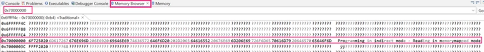

For more verification:

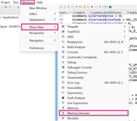

- Click on [Window], then select [Memory Browser]. Enter the corresponding address of the memory-mapped external flash, accessed through XSPI2. The address is “0x70000000”, as shown in the screenshot below.

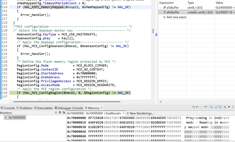

Set breakpoints on the following instructions to pause execution at specific stages to verify external flash access and MCE configuration:
- if (HAL_XSPI_MemoryMapped(&hxspi2, &sMemMappedCfg) != HAL_OK),
click [Resume]. Then, use [Step Over] to check that the external flash memory is correctly accessible in memory-mapped mode. Confirm that the expected data is present at the mapped address.
Here, it can be observed that the raw data stored in external memory becomes directly accessible and visible at this address once the application enters memory-mapped mode.

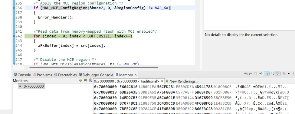

- if (HAL_MCE_ConfigRegion(&hmce2, 0, &RegionConfig) != HAL_OK), click [Resume]. Then use [Step Over] to verify the encrypted region managed by the MCE peripheral, as shown in the screenshot below.
Once the MCE region is configured, the data stored in the protected memory area is no longer handled as plain text. This confirms that the encryption mechanism managed by the MCE is correctly applied.

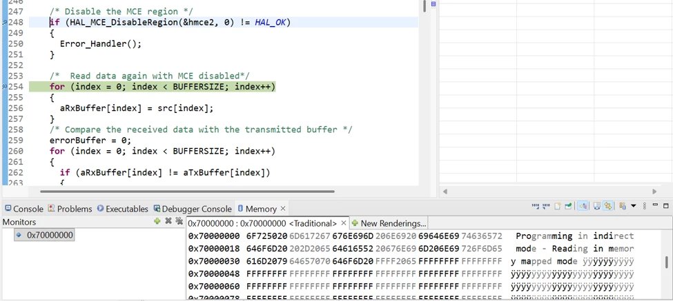

• if (HAL_MCE_DisableRegion(&hmce2, 0) != HAL_OK), click [Resume]. Then, use [Step Over] to verify that the encrypted region is returned to clear data.
Once the MCE region is disabled, the protected memory content returns to clear data. This confirms that the encryption mechanism is no longer applied.
