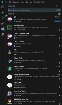

First, you’ll need to download the STM32VSCode extension. This is done through the VS Code application with your PC connected to the internet.
1. In the VS Code application, open [Extensions] (Ctrl + Shift + X).
2. Install the [STM32 VS Code Extension]. It will look like this picture below.

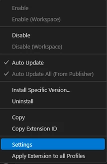

3. Navigate to the [Extensions] tab (Ctrl + Shift +X)
4. Select the cogwheel [Settings] icon for the VS Code Extension.
5. After selecting the icon, select [Settings] from the dropdown menu.

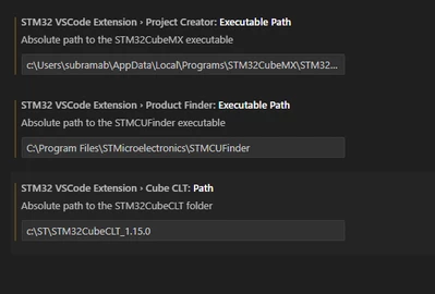

6. Add the paths of the below applications installed on your PC.
  • STM32CubeCLT_1.15.0
  • STM32CubeMX.exe
  • STMCUFinder.exe

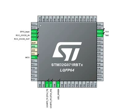

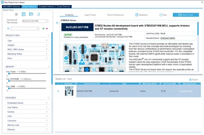

2. Select the board that you would like to develop with. In this article, we use the NUCLEO-G071RB.
3. Configure the peripherals for your application. You won’t need to change any configurations for this demonstration but note that PA5 is connected to the green LED.

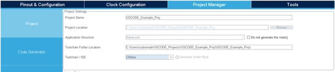

4. Once you have finished configuring your peripherals, select the [Project Manager] tab.
Here, you can name and designate a folder for your project. Make sure to select [CMake] for [Toolchain/IDE].
5. To generate the files needed for the project, select [Generate Code].

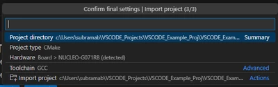

6. Once you’ve generated the CMake project, return to the VS Code IDE. Under the STM32 VS Code extension, select [Import CMake Project] and select the folder you created in STM32CubeMX.
7. After selecting the folder, you’ll have to specify your [Project type] as [CMake] and specify the hardware as NUCLEO-G071RB. Then you can select [Import Project] to finish importing the CMake project to VS Code.

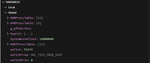

The [Variables] window can help you keep track of the values of different variables while debugging.

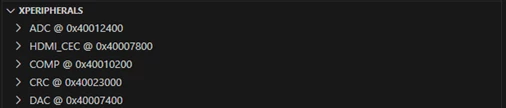

The [Xperipherals] window allows you to monitor peripherals by displaying their configuration registers and address space.

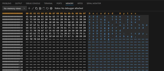

The [Memory Viewer] allows you to monitor memory contents while debugging.
