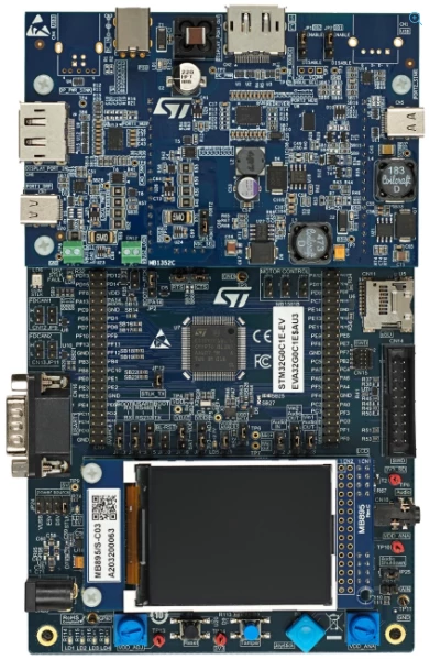

    • STM32G0C1E-EV Evaluation board
2. Getting Started
The ST Open Bootloader is part of the STM32Cube Library package. This example uses the STM32G0C1 eval board and the Open Bootloader can be found here:

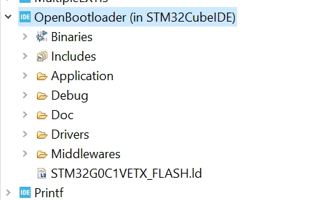

Within Windows File Explorer, double click on the STM32CubeIDE project filename, ".project" for ST Open Bootloader located in the STM32CubeG0 Library that was downloaded and unzipped at this location:
STM32Cube_FW_G0_V1.5.0\Projects\STM32G0C1E-EV\Applications\OpenBootloader\STM32CubeIDE
The project will then appear in the Project Explorer like this:

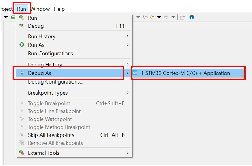

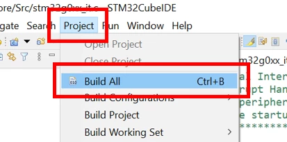

  1. Build the project, enter debug mode and run the code
Enter Debug session: this programs the code into the flash and then starts the debug session
Exit the Debug Session by terminating it.

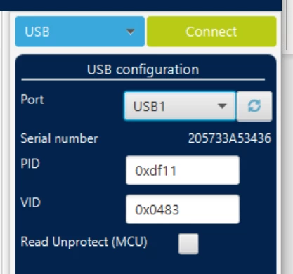

Plug in the USB Type C cable to the CN7 daughter board that is connected to the STM32G0 mother board. The USB host will begin communications enumerating the board as a USB DFU Device as confirmed in the Device Manager:

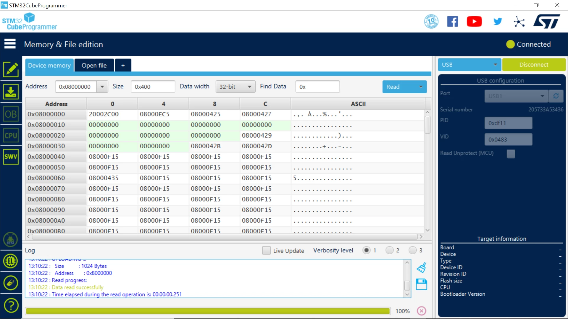

Open STM32CubeProgammer and select the USB Interface in the STM32CubeProgrammer to establish the connection through USB:
Confirm the USB connection is established as shown below. If it is not, click on the refresh button 1918.png:
Now, connect by clicking on the Connect button:
Once the connection is made, the content of the flash will be displayed as shown below:
While the flash can now be read, erased or written, the primary objective is to upload a new application image into the STM32G0.

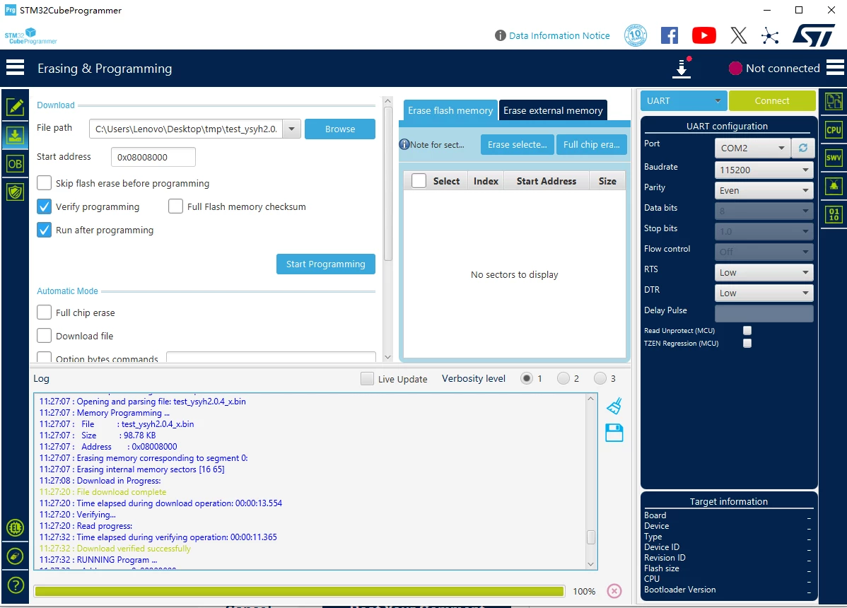

Hello @ST AME Support NF , @Laurids_PETERSEN ,
I have tried the tutorial of youtube video from the links of
https://github.com/STMicroelectronics/stm32wl-openbl-apps
with a stm32g474 eval board.

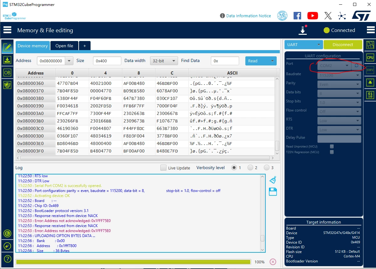

I can get connected with a uart1 (a usb-uart bridge) to the board from stm32 programmer as below
and i prepared an APP program and set the flash address to 0x8008000.
then I use stm32 programmer to download the APP bin file to 0x8008000.

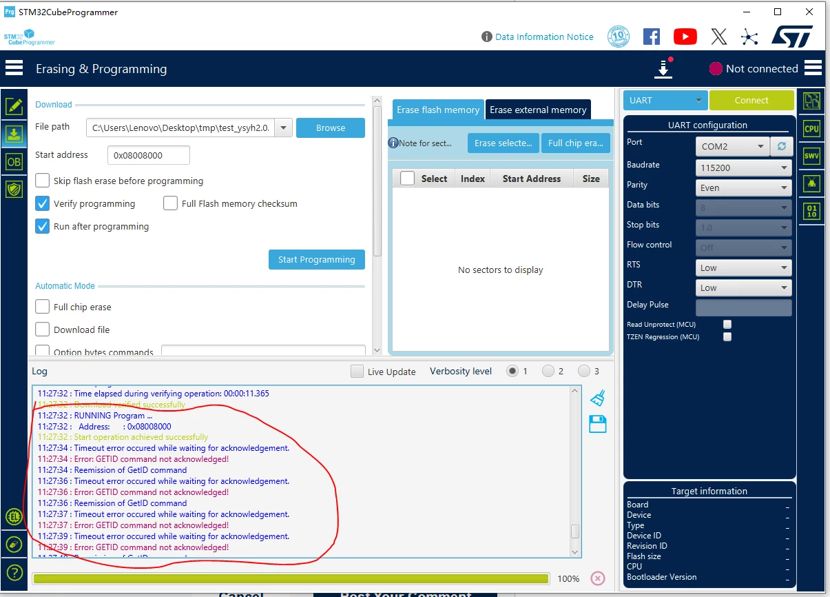

it can be downloaded but can not run exactly as below.
after I reset the board, the program start from 0x08000000, it can not start from 0x08008000.
so what is the problem?
Thanks.
