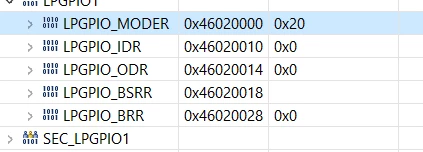

LPGPIO example provided is not working @Sarra.S

Hello @Gautham19,
Could you elaborate on what doesn't work exactly?
I would be happy to help!
Sep 13, 2023 12:30 PM UTC
@Sarra.S  I have tried it with Nucleo board u575, when tried to debug. When the code reaches the
MX_LPDMA1_Init(); the debugger connection is lost and no response I tried to track the pin PA1 pin with logic analyzer but pin state is not toggled.
Sarra.SAuthor
Sep 13, 2023 1:29 PM UTC
Hello @Gautham19
Make sure debug pins PA14 and PA13 are not set to analog.
Then reset your board and try stepping through the code
Sep 13, 2023 5:30 PM UTC
Hello @Sarra.S ,
Thanks for the debug pin configuration . I made changes with the Debug pin, it is set as analog earlier now I changed to Debug pin.
But the pin toggle is not working, it remains the same.
Sep 15, 2023 6:38 AM UTC
Hello @Sarra.S ,
I have configured LPGPIO_PIN_5 as output it is updated in LPGPIO1->MODER, but during run time the LPGPIO1->ODR, LPGPIO1->BSRR, LPGPIO1->BRR is not  getting updated.
