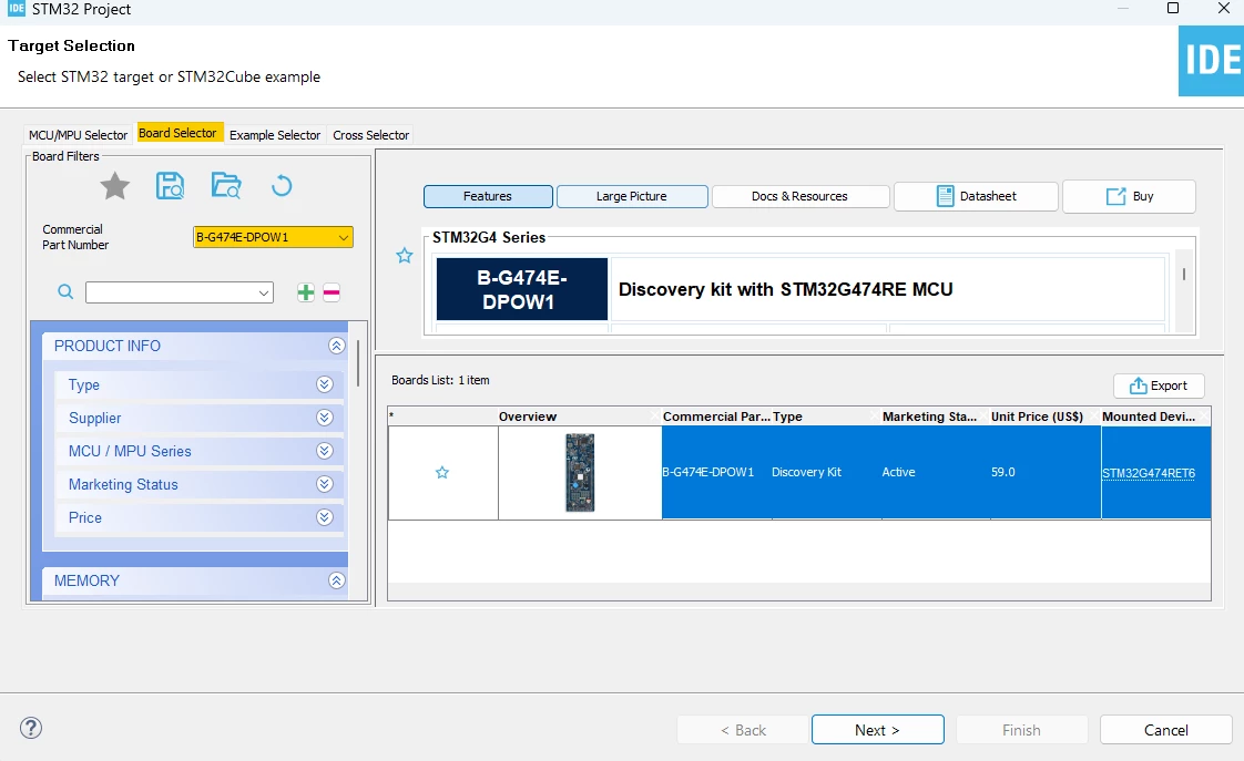

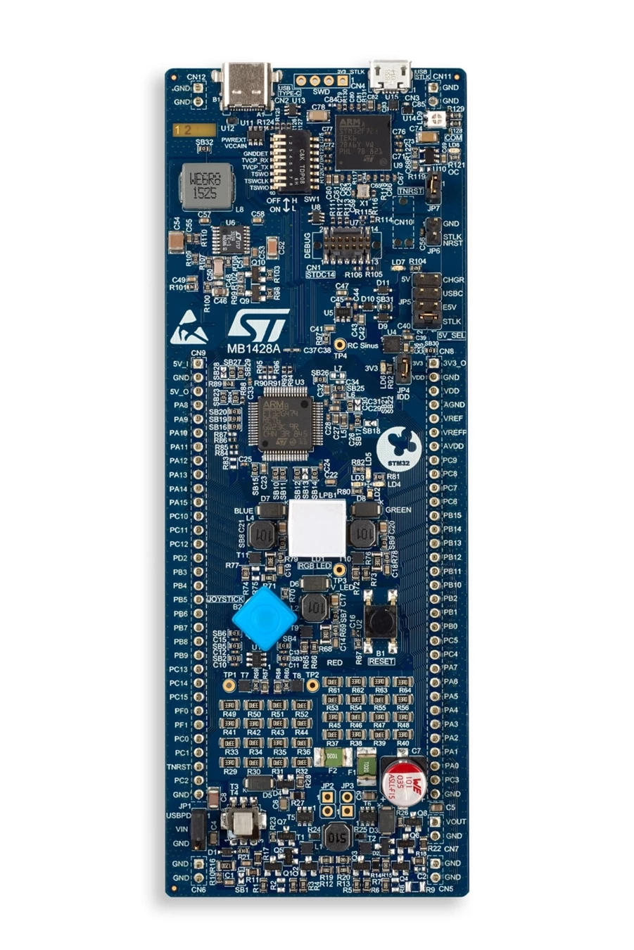

We start this demonstration by creating a new project for the B-G474E-DPOW1 discovery board using STM32CubeIDE, configuring the clocks and the HRTIM peripheral. Here are the steps to perform the initial configurations.
  • Open the STM32CubeIDE application.
  • Choose [File] -> [New] -> [STM32 Project].
  • Search for B-G474E-DPOW1 under board selector tab and click on the shown board selection and then click [Next].

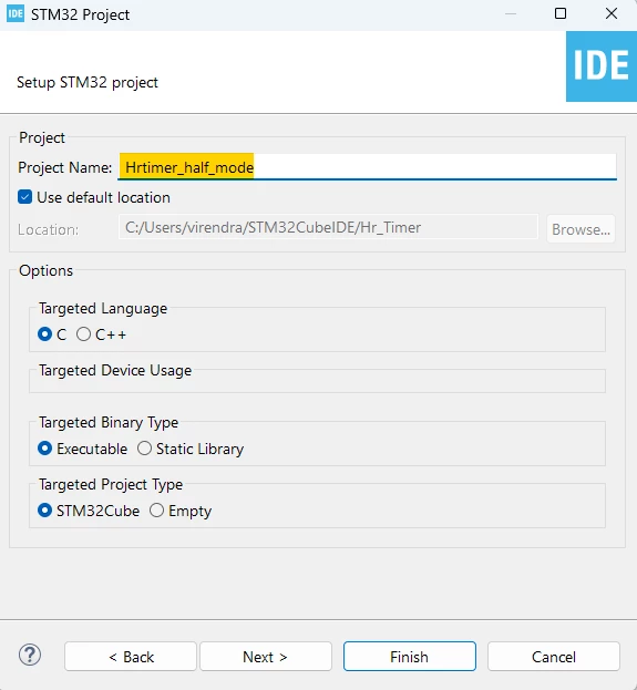

  • Choose a name for the project and click on [Finish].

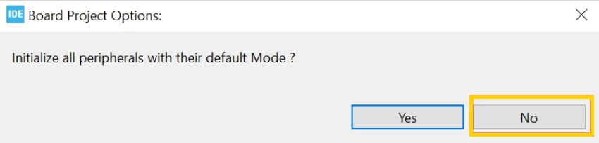

  • A popup appears, click on [No] to deny keeping all the peripherals present on the board in their default mode

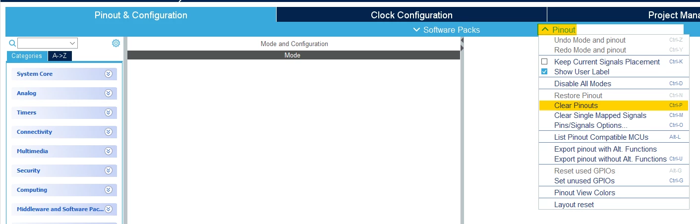

  • Once the .ioc file is open, click on [Clear Pinouts] under the [Pinout & Configuration] drop-down menu to start the peripheral initialization from scratch.

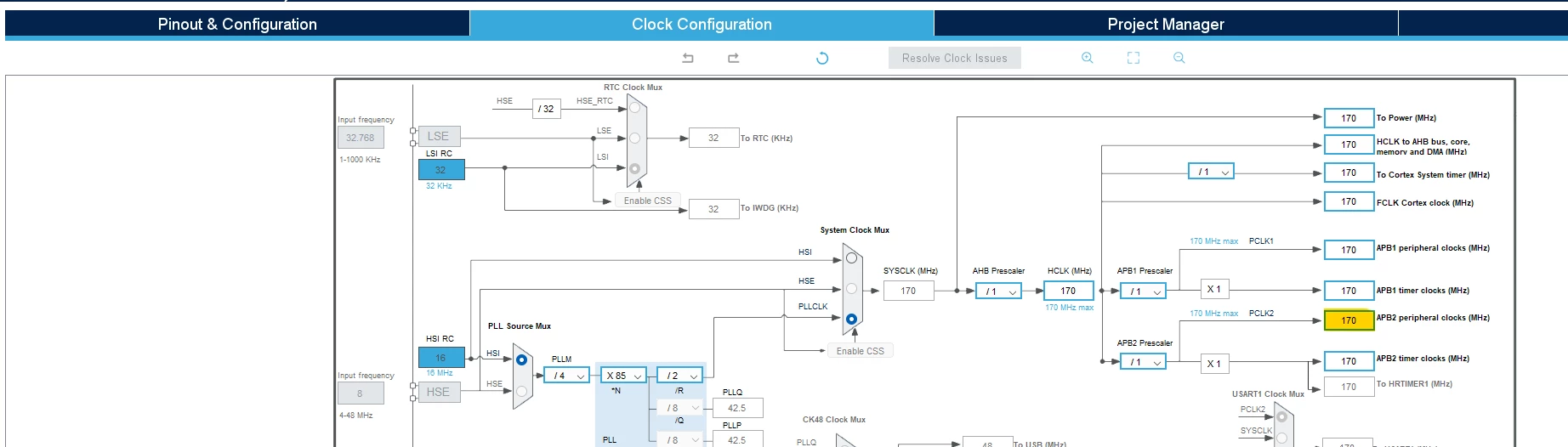

  • Navigate to the clock configuration settings and ensure that the APB2 peripheral clocks, which the HRTIM is connected to, is set to run at 170 MHz.

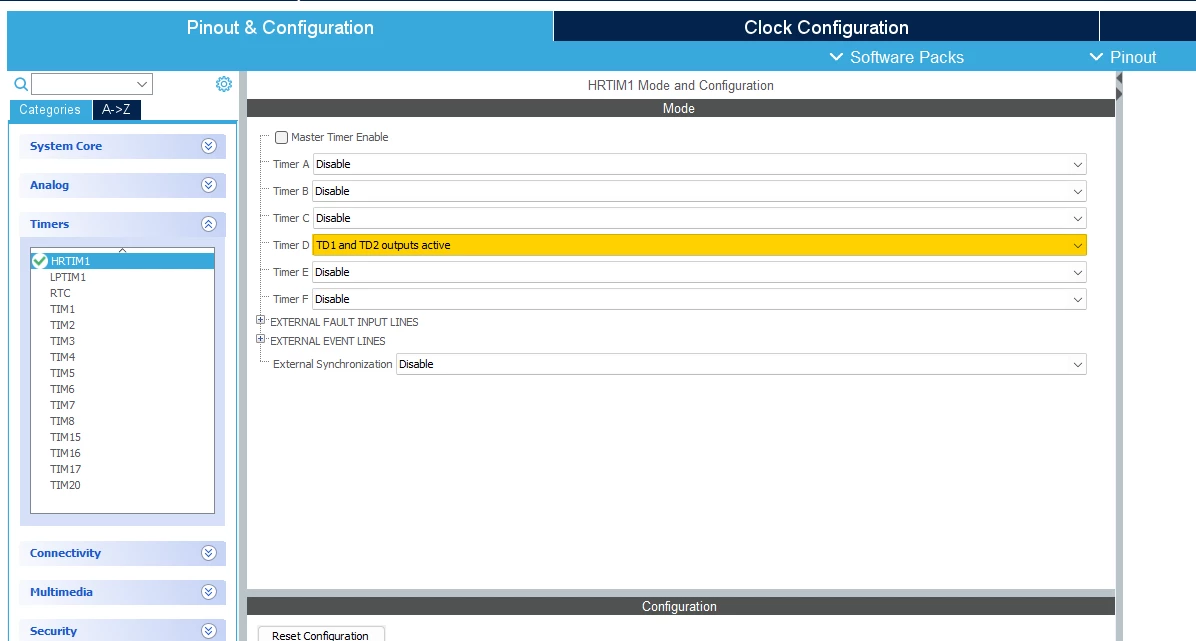

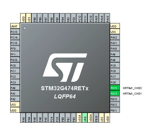

  • In the [Pinout & Configuration] tab, navigate to the timers drop-down menu, click on HRTIM1, and activate the timer D outputs.
  • By doing this, pins PB14 and PB15 are configured to serve as Channel 1 and Channel 2 for timer D.

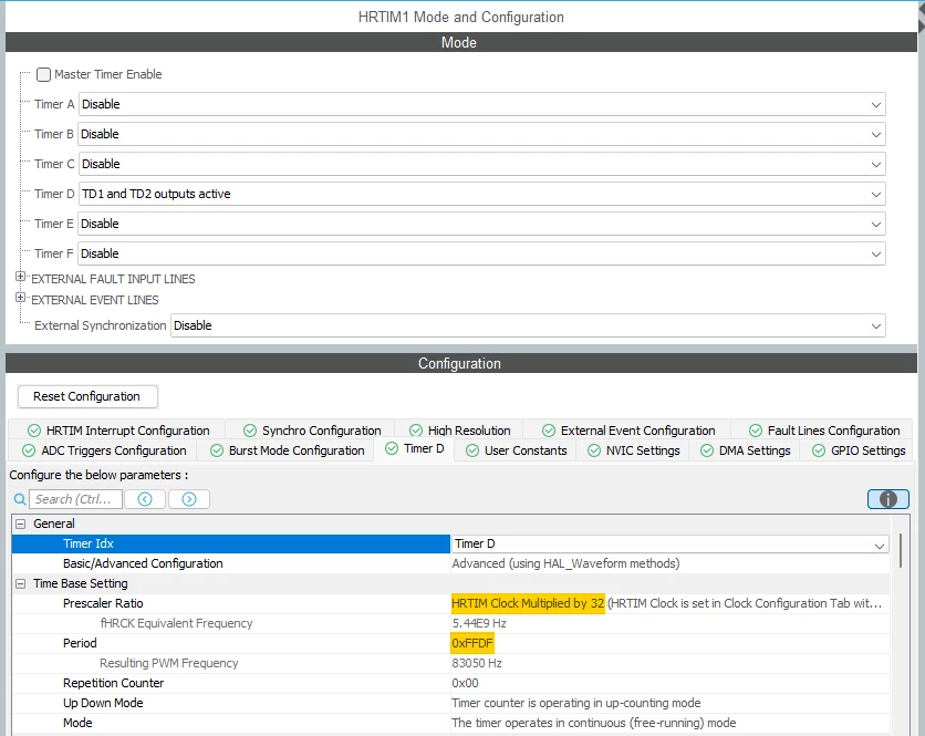

1.4.1 Clock configuration
The HRTIM can be clocked at a maximum clock of 170MHz using the APB2 bus. It supports a clock prescaler that can multiply the APB clock value by 1, 2, 4, 8, 16, or 32, or divide the APB clock value by 2 or 4. Therefore, the maximum fHRTIM clock achievable is 5.44 GHz when using a multiplication prescaler of 32 with an APB2 base clock of 170 MHz. Conversely, the lowest frequency attainable, given an APB2 clock of 170 MHz, is 42.5 MHz when using a prescaler divider of 4.
In this example, we run the HRTIM at the maximum frequency by using a multiplier prescaler of 32.
  • APB2 clock frequency = 170 MHz
  • fHRCK (high resolution equivalent clock) = 170 x 32 MHz = 5.44 GHz
  • Timer resolution: 1 / 5.44 GHz = 184 ps

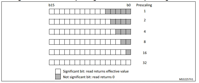

The maximum value that the period register can support varies when using multiplication prescaler values, as the least significant bits become insignificant.
The maximum programmable period values for each multiplication factor are shown in the table below

In this example, since we are using a multiplier prescaler value of 32, the maximum period value is 0xFFDF. We use the period value as 0xFFDF which results in the following PWM frequency:
  • Resulting PWM frequency =   fHRCK / Configured_period_value = 5.44 GHz / 0xFFDF = 83050 Hz

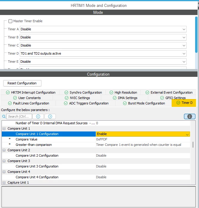

Continue configuring the HRTIM by selecting [Enable] in Compare Unit 1 under the [Timer D] tab.

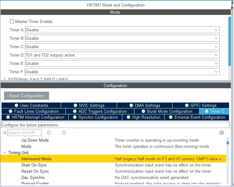

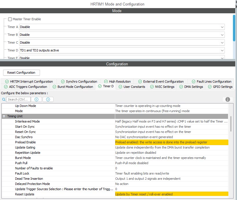

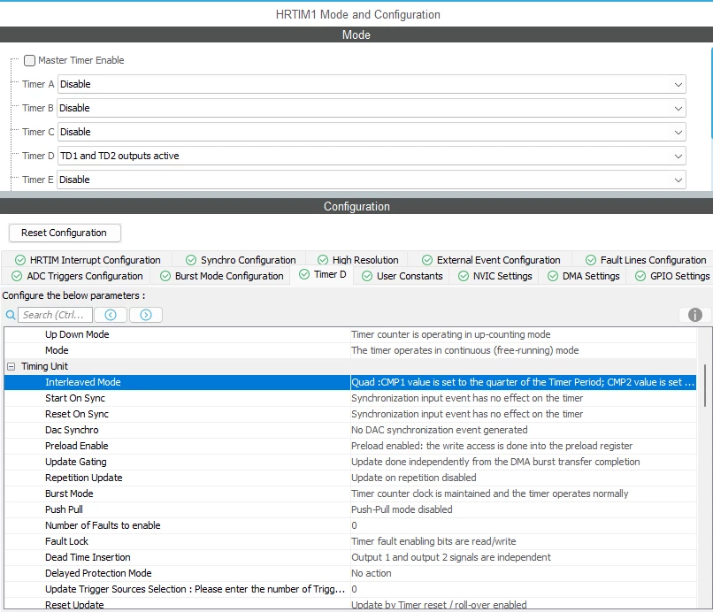

Next, we configure timer D to operate in half mode. This setting can be enabled under the Interleaved Mode option in the Timing Unit section. Note that half mode can only be activated if Compare Unit 1 is enabled. Otherwise, the option is grayed out and unavailable.  Additionally, it is normal for the compare value to disappear from the Compare Unit 1 section, as the value is automatically computed internally.
Since we are updating the period value in real time, we enable the preload feature. Keep in mind that when preload is enabled, all writes to the HRTIM_PERxR register are made to the preload register, not the active register. Therefore, an update event must be enabled to transfer the content from the preload register to the active register.
Although HRTIM supports various update events, for simplicity, we use the [Update by Timer reset/roll-over enabled] option.

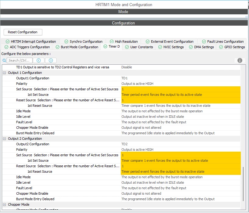

Screenshot 2024-12-04 123543.pngNext, we configure the set and reset events for the outputs TD1 and TD2. Consider TD1 and TD2 to be complementary outputs.
OUTPUT Set event Reset event
TD1 Timer D period  Timer D compare unit 1 event
TD2 Timer D compare unit 1 event Timer D period
Change the number of active set and reset sources to 1, and assign the set/reset events accordingly, as demonstrated in the table above.

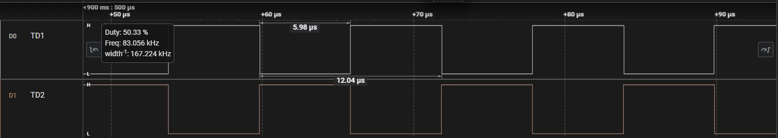

1.6 Results
Connect your board to the PC using a USB cable. Compile, load and debug the binary file by clicking on the button shown below. The programming process should complete without any errors.

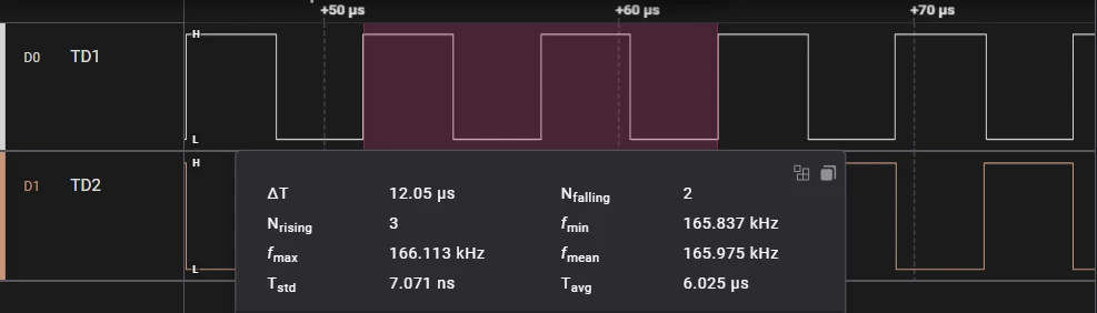

Connect the logic analyzer or oscilloscope probes to pins PB14 and PB15. Then, click on the [Run] icon to start the process.
Now, when you analyze the scope captures, you observe that the PWM signal has approximately 50% duty cycle.
Period value Resulting PWM frequency in Hz (170Mz / period value) Resulting PWM time period in μs (1 / PWM frequency) 50% duty cycle time period in μs
0xFFDF / 65503 83050 12.04 6.02
0x2710 / 10000 544000 1.8 0.9
Scope capture at the start:
Scope capture after 5 seconds:

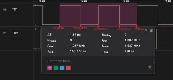

This mode is used to implement interleaved topologies, which are commonly used in power electronics to improve the performance of power converters. The available modes are:
  1. Triple interleaved (120°): Three phases with 120-degree phase shift.
  2. Quad interleaved (90°): Four phases with 90-degree phase shift.
The specific compare registers and their corresponding values are automatically calculated based on the chosen interleaved mode.
Compare register values
Triple interleaved
120°
Quad interleaved
90°
CMP1 value
Period / 3
Period /4
CMP2 value
2x (period /3)
Period /2
CMP3 value
Not affected
3 x (period /4)

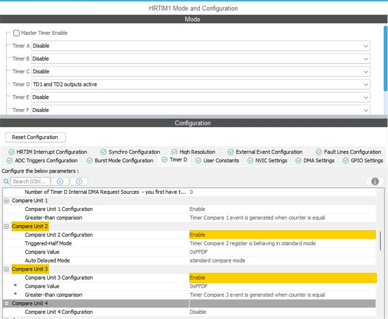

We utilize the previously demonstrated half-mode project in this article to showcase the dynamic behavior of quad interleaved mode. This involves observing how the HRTIM automatically recalculates different compare register values in response to changes in the value of `HRTIM_PERxR`.
  • Open the .ioc file while keeping the clock configurations the same, and make the following changes to the .ioc configuration file.
In the HRTIM1 section, enable Compare unit 2 and 3 of timer.

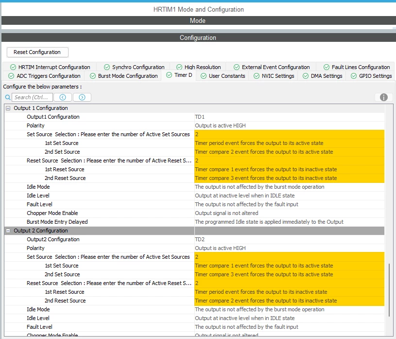

Change the interleaved mode to [Quad]. Similar to the configuration of half mode, the compare value portion of the compare units now disappears. These values are computed internally and not required to be manually updated on our end.
TD1 and TD2 are complementary outputs and change the active Set/Reset sources as shown below.
Screenshot 2024-12-04 162242.pngWith all configurations complete, we can now generate the code by clicking on the [Device Configuration Tool Code Generation] icon.

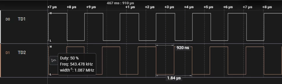

Lionking_2-1733341770491.pngThe scope captures give us the results as expected.
  • For the first 5 seconds, the period is around 12.06 μs.
  • For the first 5 seconds, the period is around 1.84 μs
