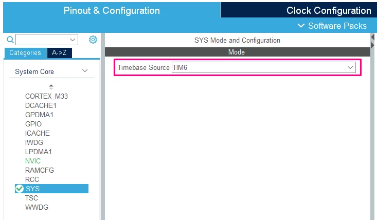

After its creation and naming, open the SYS tab. Under System Core, selecta timer as Timebase Source, TIM6 was arbitrarily selected. This step is needed since the SysTick timer is used by FreeRTOS™.

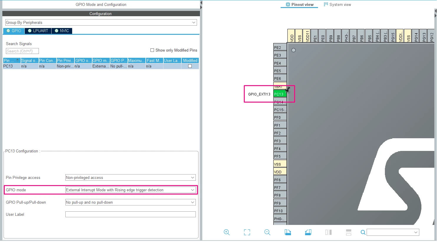

While in the System Core, locate the GPIO tab and set the PC13 as EXTI with External Interrupt Mode with Rising edge trigger detection. There is a push-button (active high) connected into this pin in NUCLEO-U575ZI-Q with a pull-down and a hardware debounce filter.

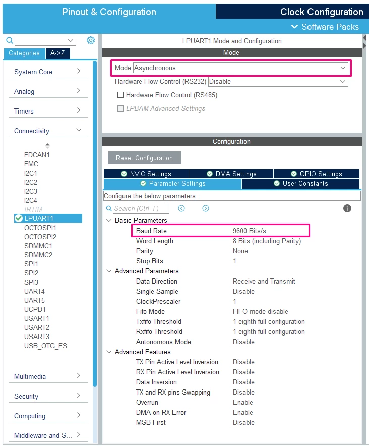

Under Connectivity tab, enable the LPUART1 as Asynchronous mode and apply your settings. In this tutorial, we use the standard UART settings (8/N/1), but with the 9600 bits/s for the baud rate.

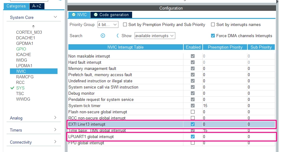

Back to the System Core tab, open the NVIC and enable both EXTI Line 13 and LPUART global interrupts.

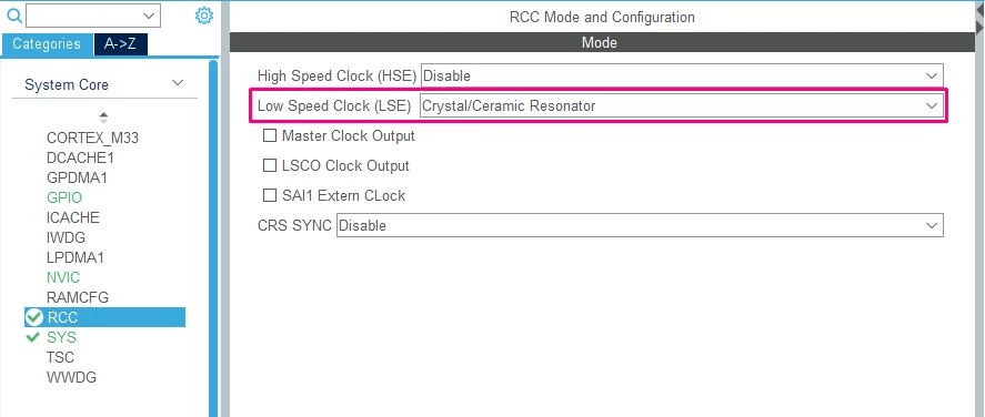

Enable the LSE clock source only if you intend to use the LSE as clock source for the LPUART1 while in STOP2 low-power mode. If this applies to your case, in RCC menu select the Crystal/Ceramic Resonator for the LSE.

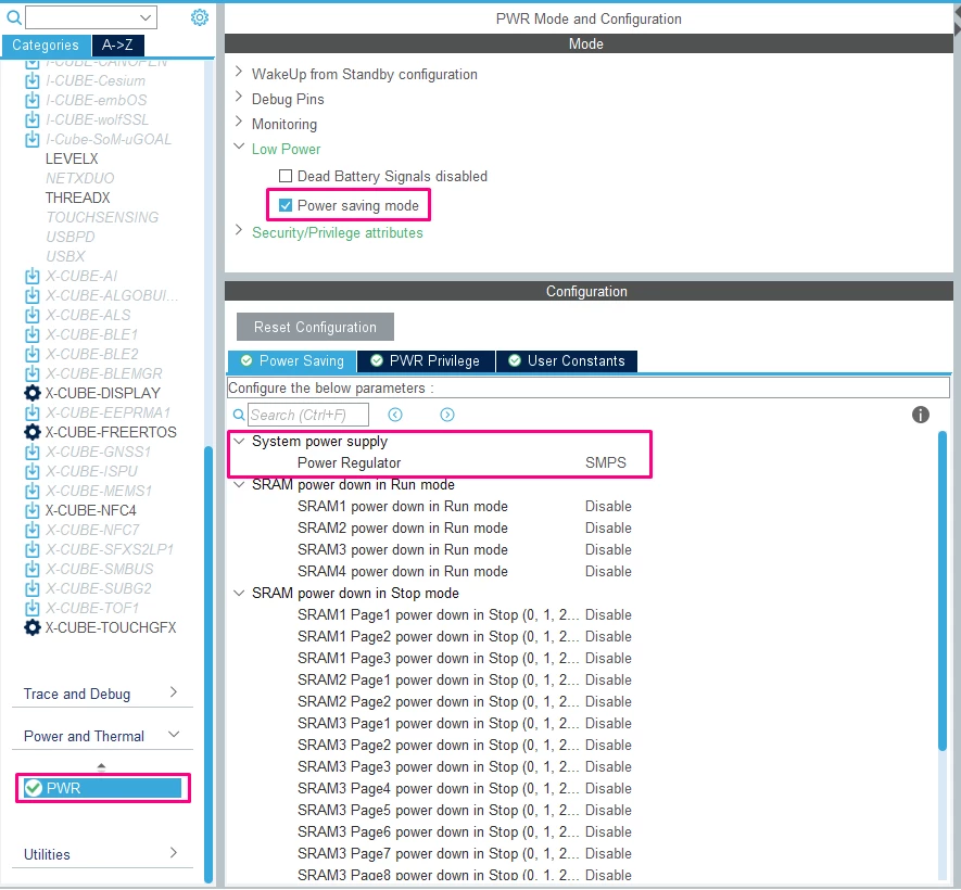

Change the Power Regulator to SMPS under PWR -> Power saving mode to achieve better current consumption values in low-power.

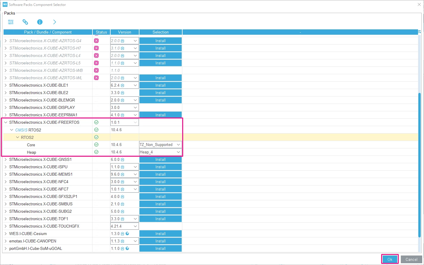

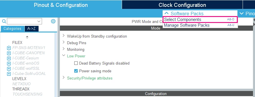

Now, all peripherals are set. Let’s add and configure the FreeRTOS in our application. For that, open the Select Components menu.
 Select the X-CUBE-FREERTOS with Heap_4, then click OK.

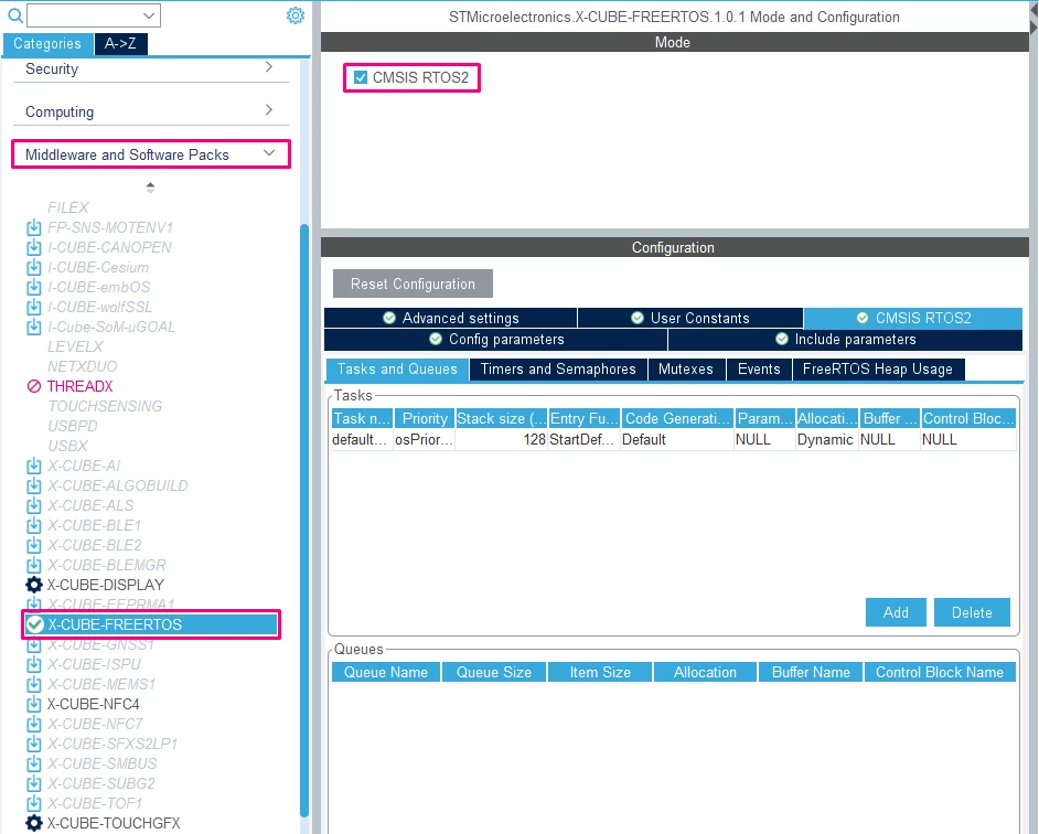

Returning to STM32CubeMX, enable the CMSIS RTOS2 under Middleware and Software Packs -> X-CUBE-FREERTOS tab.

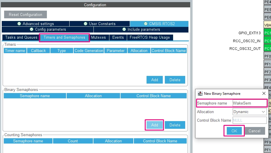

Create a semaphore to control the application flow. For that, go to the Timers and Semaphores tab, then click over the Add button under Binary Semaphores section. A menu called New Binary Semaphore appears. Give a name for the semaphore and click OK.

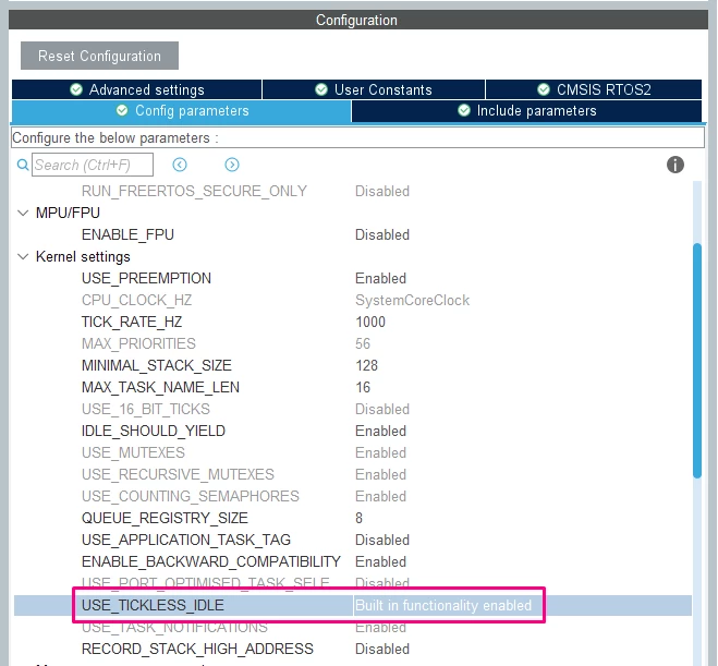

The last setting for the FreeRTOS is to enable the Tickless mode. For that, go to Config parameters tab
and enable the USE_TICKLESS_IDLE.

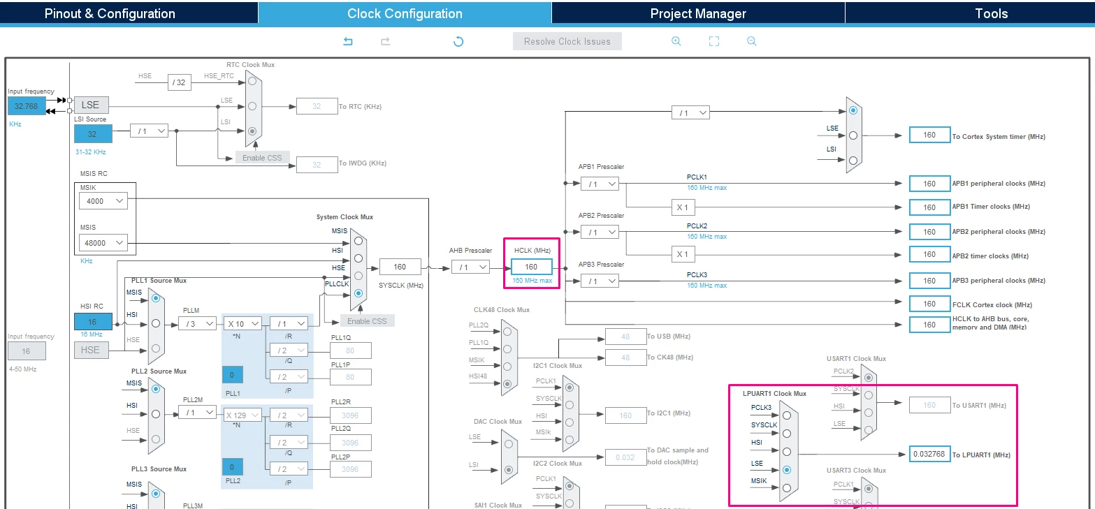

Now, let’s set the Clock Configuration. Increase the MCU clock frequency as needed by the application and change the LPUART1 clock source. This peripheral clock should be supplied by HSI, LSE or MSIK to allow it to work in STOP2. While the HSI allows higher baud rates, the LSE has lower power consumption. In the image below the LSE is used, but refer to the end of this article to see a power consumption comparison between these two clock sources.

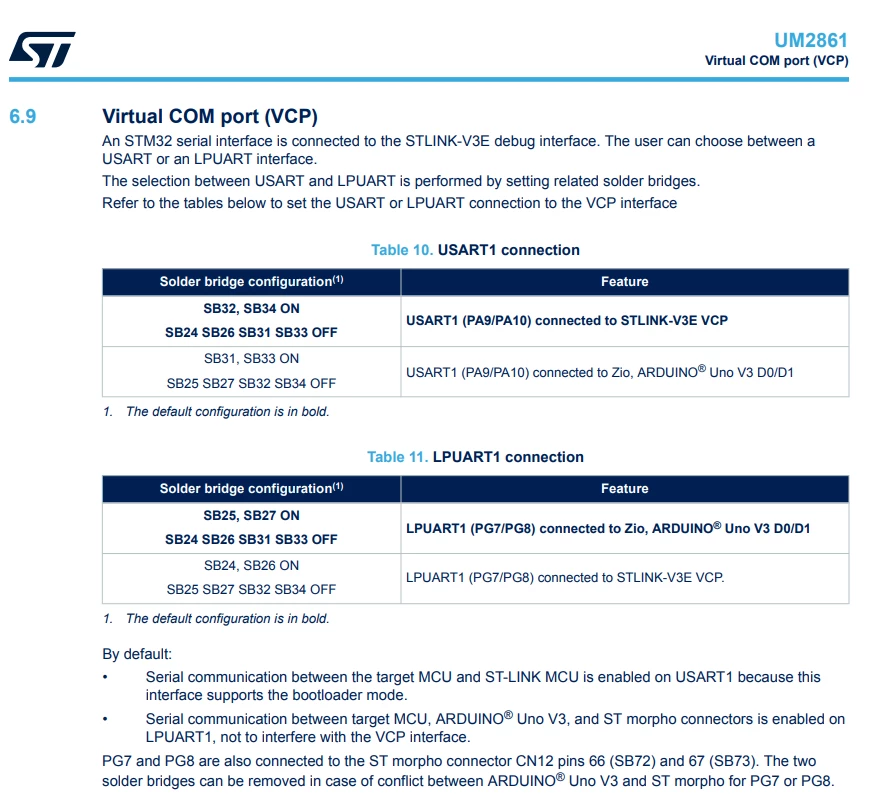

NOTE2: The LPUART1 is not the default connection to the ST-LINK VCOM embedded in NUCLEO-U575ZI-Q. You should connect this manually to a computer or change the solder bridges as illustrated in this image, extracted from the board’s user manual:

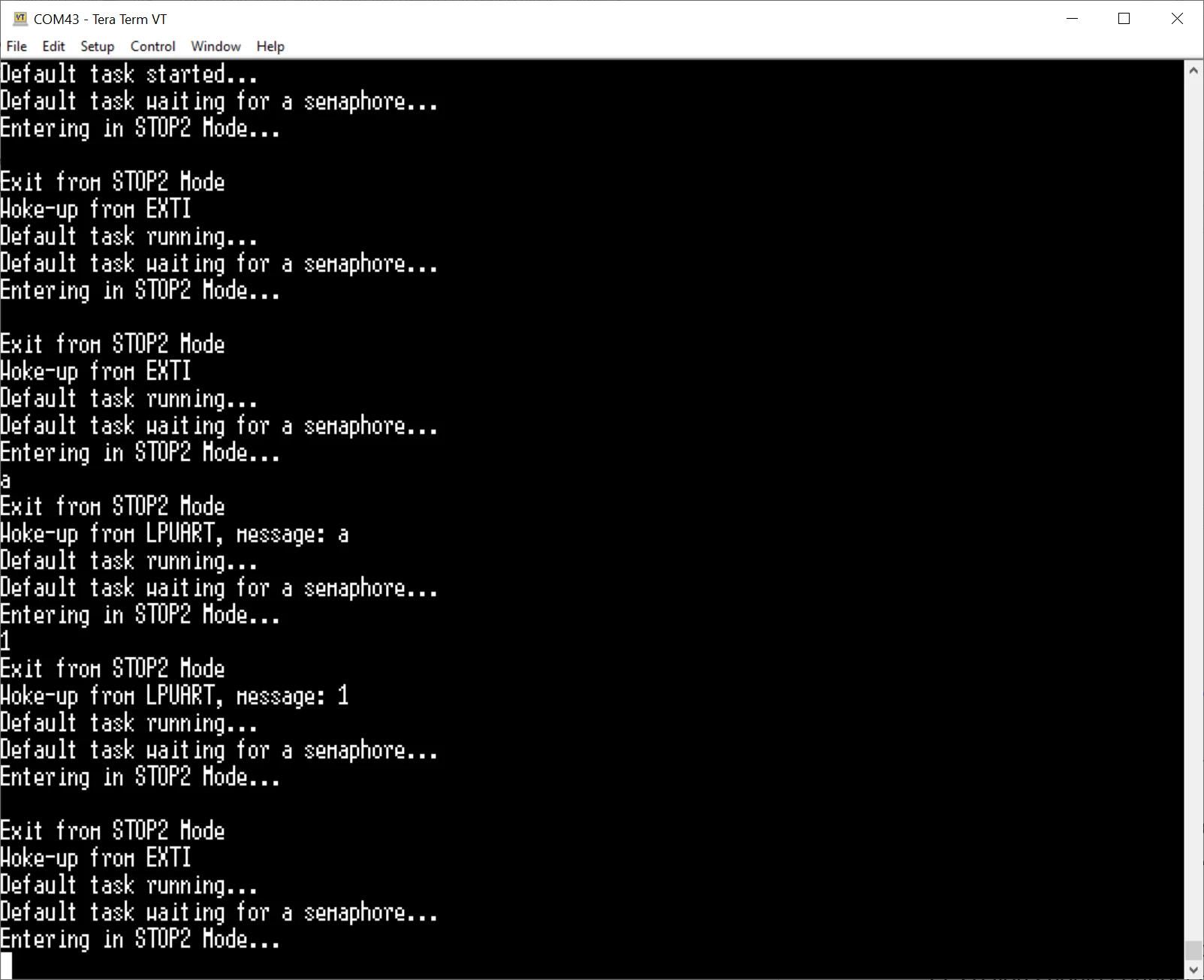

Results
When the application starts, the DefaultTask is started and runs until the osSemaphoreGet instruction. After that, the Idle task is started and the PreSleepProcessing function is called and the MCU can enter in Low-Power Tickless mode.
 As set in the project, there are 2 available wake-up interrupt sources. The LPUART1 that waits for a character to be received and the EXTI that waits for the button to be pressed. Whenever an interruption happens, the PostSleepProcessing function is called, where we have the code to prepare the MCU after waking up from STOP2 mode.
The interrupt calls the callback function (according to the wake up source used) which releases a semaphore, letting the DefaultTask back to run mode until the osSemaphoreGet instruction is detected again.
The expected application behavior is illustrated in the image below, showing the TeraTerm view and messages output:

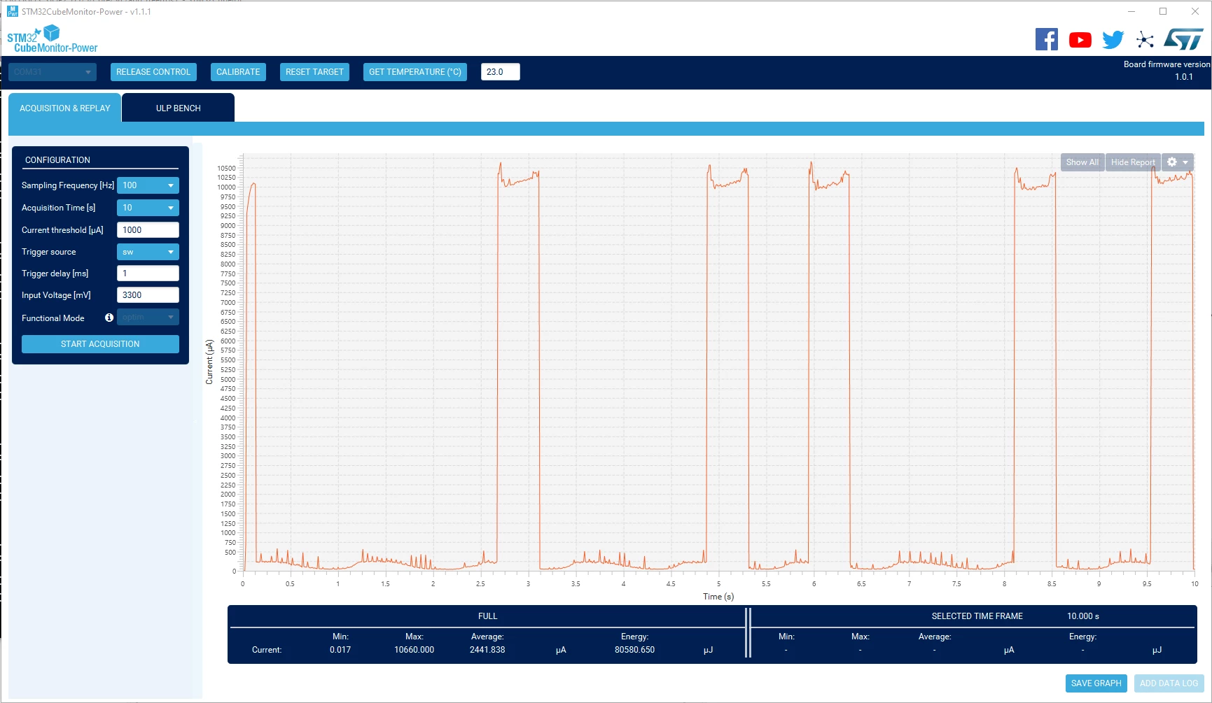

The power consumption can be monitored using the STM32CubeMonitor-Power 1.1.1 along with one of the available hardware for measurement, including: STLINK-V3PWR probe, the X-NUCLEO-LPM01A expansion board, or the energy meter of the STM32L562E-DK Discovery kit. The results are shown in the images below, starting with the LSE to supply the LPUART clock source, the lower consumption registered was around 8µA:
The occurrence of interruptions wakes-up the MCU and the entry of DefaultTask into run mode are indicated by the current peaks, while the low current consumption signifies the periods during which the MCU is in STOP2 Mode.
To offer a quick comparison between the consumption of LSE and HSI as clock sources for the LPUART, the following graph displays the application consumption while utilizing the HSI.
The average consumption of 165µA was observed when the LPUART used the HSI as its clock source, whereas the consumption was around 8µA when the LSE was utilized.
