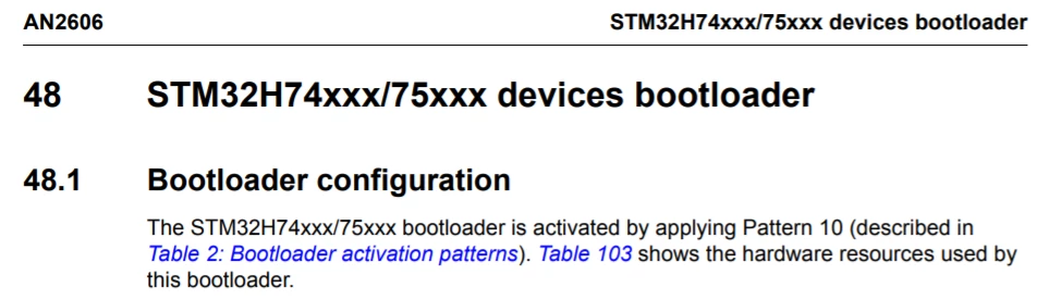

Step 1. Locate your STM32 device in AN2606. This reveals the activation pattern that you need to apply, the various available bootloader interfaces for your device and the hardware resources required by the bootloader.
Step 2.

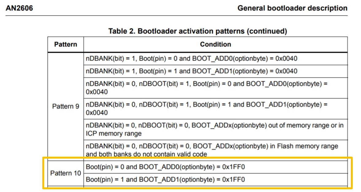

Locate the pattern denoted in your target MCU's bootloader configuration description and in the bootloader activation patterns table. Note that if there are multiple options for a pattern, you may select any option of your choice to apply.
In our example case, we must use pattern 10.
Step 3.

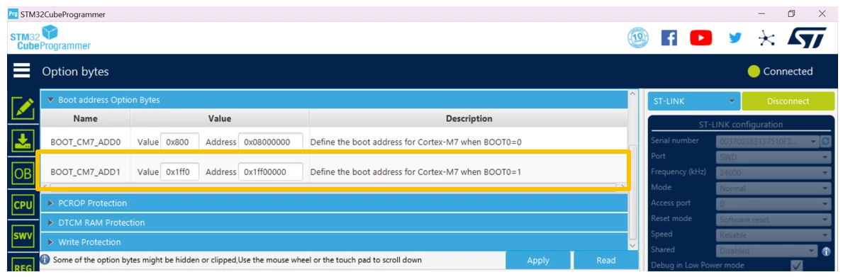

As pattern 10 has two options, we select the second pattern 10 option: Boot(pin) = 1 and BOOT_ADD1(optionbyte) = 0x1FF0. On my NUCLEO-H743ZI, I have verified that the BOOT_ADD1 in the MCU's option bytes is set to 0x1FF0 using STM32CubeProgrammer and have connected the BOOT0 pin (located on CN11) to VDD.

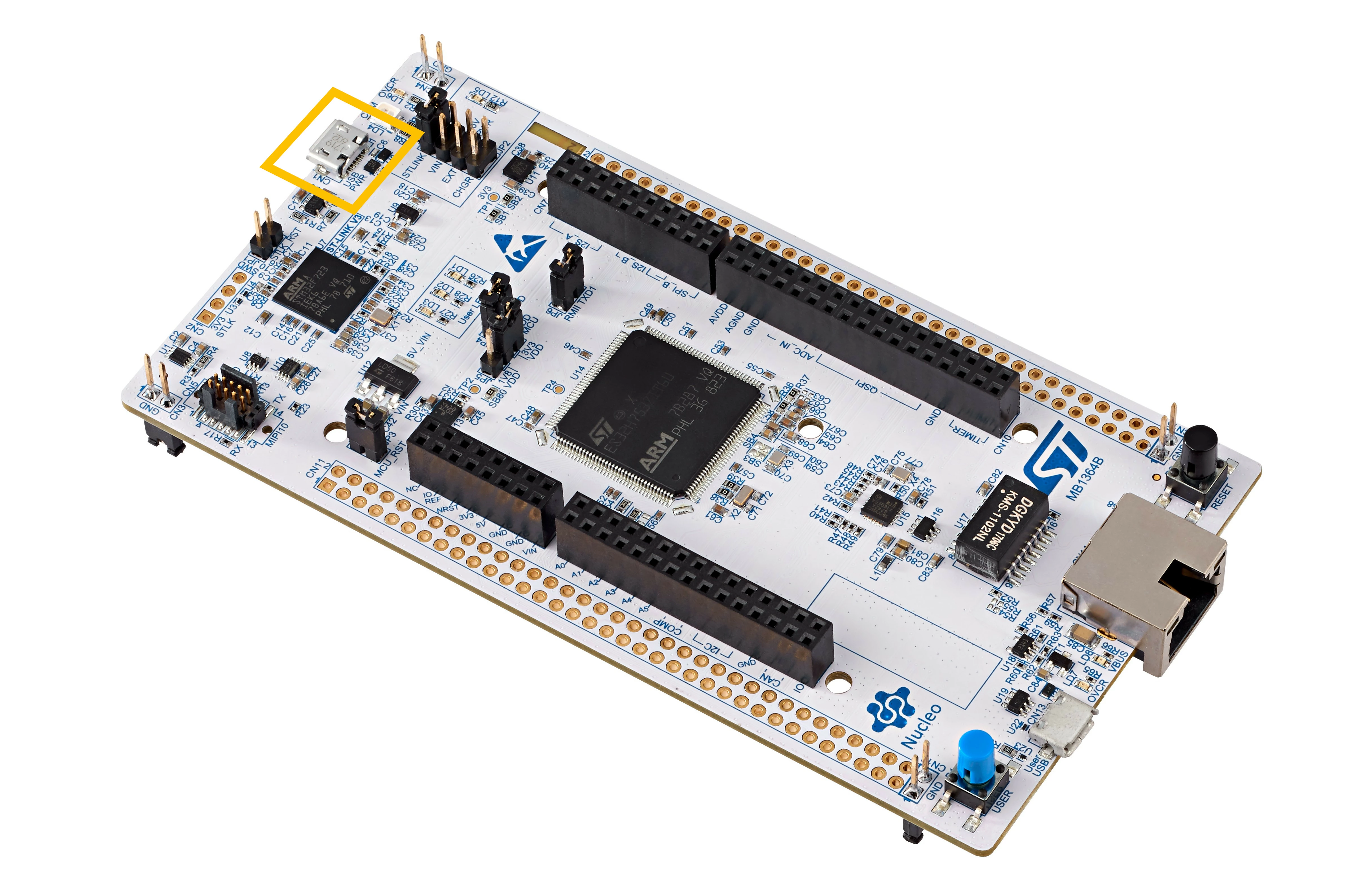

 Locate the ST-LINK USB port (CN1) on your board and attach the board to your host machine with a USB cable.

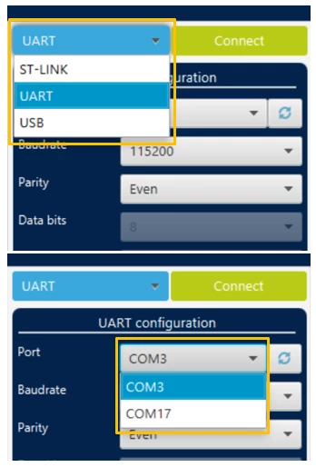

Select the UART connectivity option in STM32CubeProgrammer and make sure that you are selecting the appropriate COM port of the target MCU.

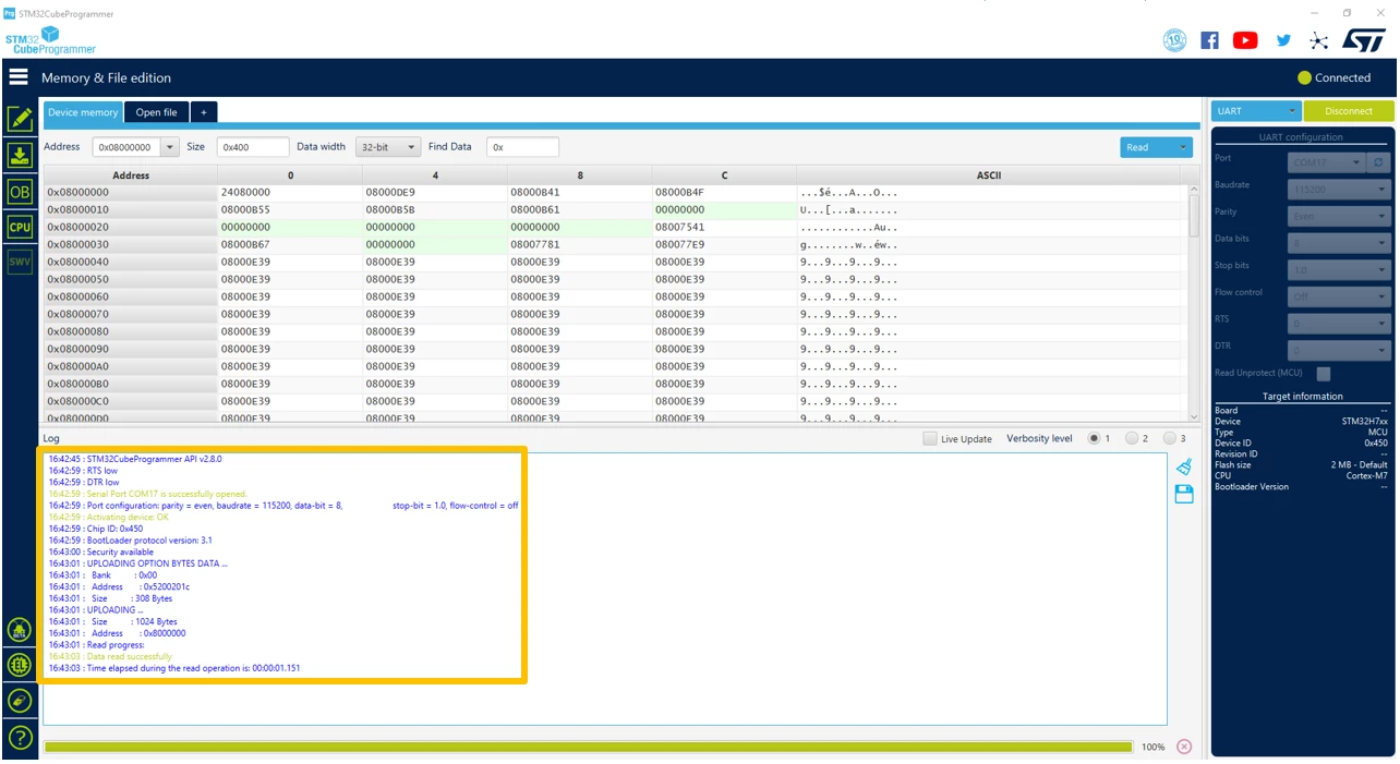

Click on the ‘Connect’ icon. Congratulations! We have successfully leveraged STM32CubeProgrammer to launch our NUCLEO-H743ZI's USART bootloader.

I however dont see the Boot address and Option Bytes in the Option Bytes tab.
Did you do something special to open this tab?
