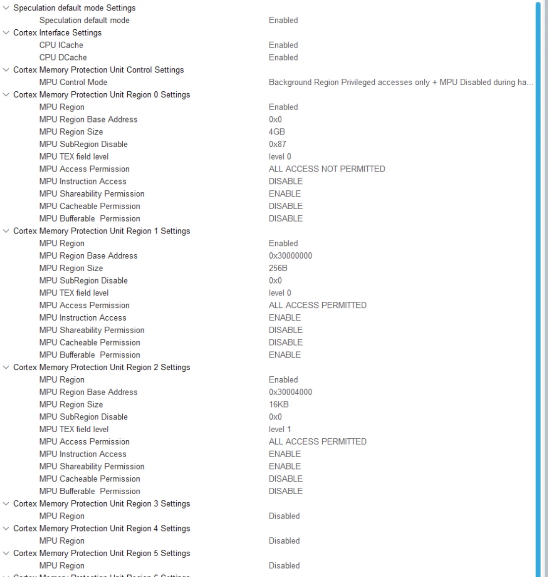

We must configure the memory protection unit on the CORTEX_M7 to prevent the speculation from interfering with the code execution. To accomplish that, enable both CPU caches, speculation default mode and set the MPU control mode as background region privileged access only + MPU disabled during hard fault, NMI, and FAUTMASK handlers.
MPU regions must be configured to specify the access to both Ethernet descriptors, such as in the picture below. More details about the MPU and Ethernet descriptors for the M7 core can be found here: Knowledge article: How to create a project for STM32H7 with Ethernet and LwIP stack working

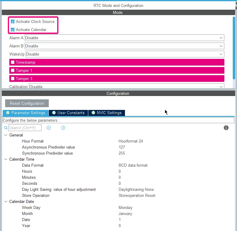

In the Timer tab, we’ll set up the RTC (real-time clock) peripheral. We can store the translated timestamp into human readable values into the embedded calendar of the MCU. Given this is just a simple demo, it will proceed and use the fairly inaccurate LSI. However, for real applications we recommend configuring the LSE as the clock source for the RTC to achieve better precision.

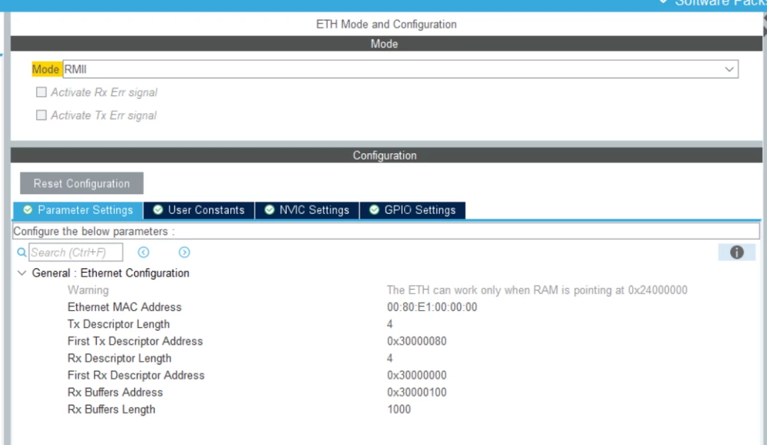

In the Connectivity tab, we’ll have both the Ethernet and USART3 peripherals that are used. Ethernet will be the focus of this application, and the serial port will be used for debug purposes, such as application progress, error, and IP address handling.
RMII Ethernet Mode must be enabled, configure the Rx buffers to 1000 and the first descriptor addresses must be set as such:

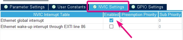

Still, in the Ethernet tab, navigate to the [NVIC Settings] tab and check the [Ethernet global interrupt] enable box.

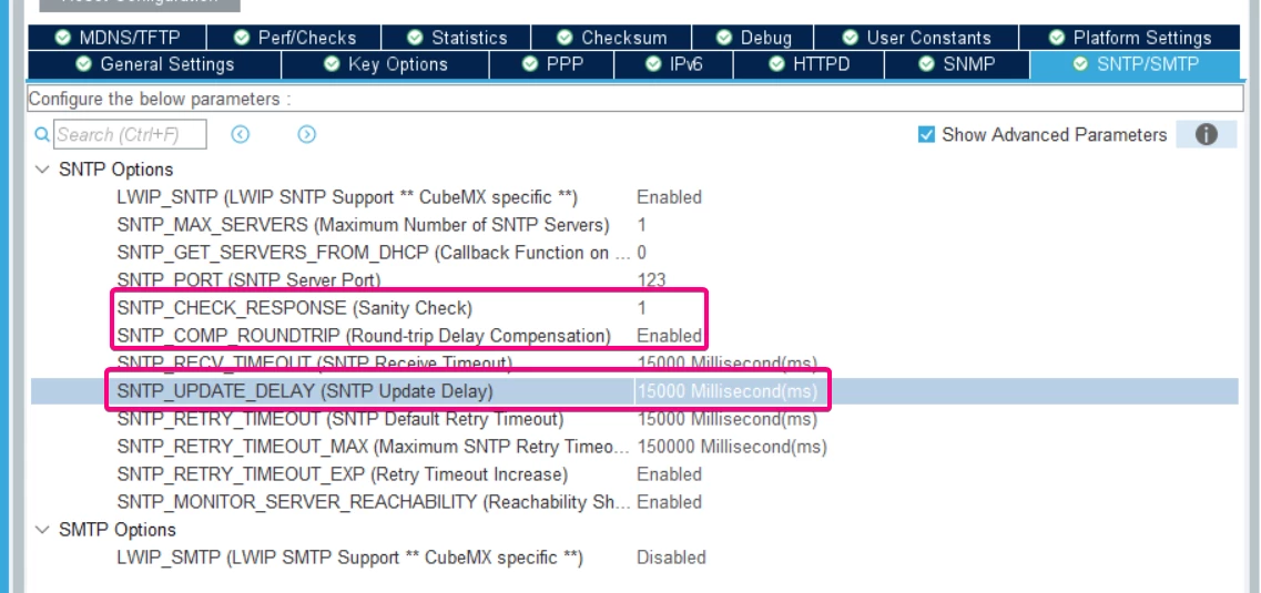

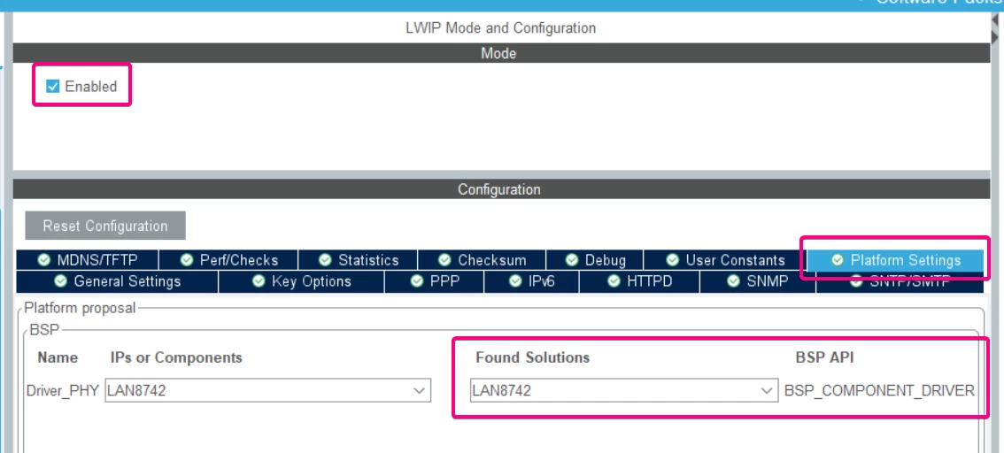

In the middleware tabs, the first step is to [Enable] the LwIP. Only then it's possible to move to the [Platform Settings] tab and proceed with the configuration, as shown in the image below:
Next, the [SNTP/SMTP] tab is accessed to configure the [Sanity Check] and [Round-Trip Delay Compensation]. Reduce the [SNTP Update Delay] for demonstration purposes only.

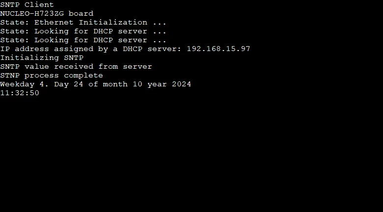

To ease the debugging and communication with the STLINK’s VCOM, the printf function will be configured. The following code must be inserted in the USER CODE BEGIN PFP section.
int __io_putchar(int ch) {
 HAL_UART_Transmit(&huart3, (uint8_t*) &ch, 1, 0xFFFF);
 return ch;
In the USER CODE 2 section, add a few debug messages to allow tracking the current firmware state as it executes. These debug messages are added throughout the entire application.
 /* USER CODE BEGIN 2 */
 printf("SNTP Client\r\n");
 printf("NUCLEO-H723ZG board\r\n");
 printf("State: Ethernet Initialization ...\r\n");
 /* USER CODE END 2 */

Follow-up with the SNTP process, created to initialize the protocol and print out the received information every 15 seconds. This is the rate at which the SNTP protocol will ask the server for an updated time stamp.
void sntp_process (void) {
 RTC_TimeTypeDef sTime = {0};
 RTC_DateTypeDef sDate = {0};
 if (sntp_enabled() != 1 && DHCP_state == DHCP_ADDRESS_ASSIGNED){
 printf("Initializing SNTP\n\r");
 ipaddr_aton("0xC8A007BA", &sntp_ip); // Set SNTP server IP
 sntp_setoperatingmode(SNTP_OPMODE_POLL); // Set SNTP operation mode to Polling
 sntp_setserver(0, &sntp_ip); // Set server 0 as the supplied ip address
 sntp_init(); // Start SNTP process
 if (unix != 0){
 printf("SNTP value received from server\n\r");
 sTime.Hours = timeinfo.tm_hour - 3;
 sTime.Minutes = timeinfo.tm_min;
 sTime.Seconds = timeinfo.tm_sec;
 sTime.DayLightSaving = timeinfo.tm_isdst;
 sTime.StoreOperation = RTC_STOREOPERATION_RESET;
 if (HAL_RTC_SetTime(&hrtc, &sTime, RTC_FORMAT_BIN) != HAL_OK)
 Error_Handler();
 sDate.WeekDay = timeinfo.tm_wday;
 sDate.Month = timeinfo.tm_mon + 1;
 sDate.Date = timeinfo.tm_mday;
 sDate.Year = timeinfo.tm_year - 100;
 if (HAL_RTC_SetDate(&hrtc, &sDate, RTC_FORMAT_BIN) != HAL_OK)
 Error_Handler();
 // Get's the time and dat from RTC
 HAL_RTC_GetTime(&hrtc, &sTime, RTC_FORMAT_BIN);
 HAL_RTC_GetDate(&hrtc, &sDate, RTC_FORMAT_BIN);
 printf("SNTP process complete\r\n");
 // Prints the RTC values
 printf("Weekday %d. Day %d of month %d year 20%d\r\n", sDate.WeekDay, sDate.Date, sDate.Month, sDate.Year);
 printf("%02d:%02d:%02d\r\n",sTime.Hours, sTime.Minutes,sTime.Seconds);
 unix = 0; // Waits for next reception to reset

3.2. Code run and web page opening
A terminal interface is required for IP address checking and code flow, as well as specific debug. You can either use your preferred terminal software or set up the built-in terminal in STM32CubeIDE. For more details on how to configure that, you can refer to this quick knowledge article:
Make sure to connect the board using an RJ45 cable to a router or switch then allow the code to run by pressing the resume button or the [F8] shortcut.
On the terminal, the following messages should display if all steps are done correctly, the IP address varying based on your network’s addressing and architecture.
This message output updates every 15 seconds with a new timestamp being received from the server. In the meantime, the value is saved into the internal RTC. It can be used by the application in a precise way, especially if the RTC was configured with the LSE. Given that a new update is received every 15 seconds, it can be used to adjust the time if a larger deviation is observed.
To reduce CPU load, it’s recommended to increase the SNTP delay to a full hour or more. This depends on the precision that you want to achieve with the application and the clock source used for the RTC.

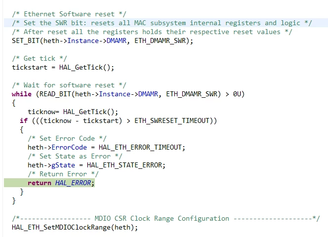

Thanks for the example. I implemented it in a STM32H7723ZG NUCLEO-144 board. The JP6 is installed so theoretically the Ethernet chip works. I checked the pinout against the schematics: it is perfect. I tried to follow your instructions, screen shots and crated the app. But the app is locked in Error_Handler().
After long time investigation I found the reason is that
low_level_init()
 in ethernetif.c library file get stuck in Error_Handler() because. This is because the
HAL_ETH_Init()
function (defined in stm32h7xx_hal_eth.c) times out when it tries to software reset Ethernet chip.
Can you post the H7237ZG project or at least the IOC file of the project?
Thanks,
Louis
In stm32h7xx_hal_eth.c, HAL_StatusTypeDef HAL_ETH_Init(ETH_HandleTypeDef *heth):
