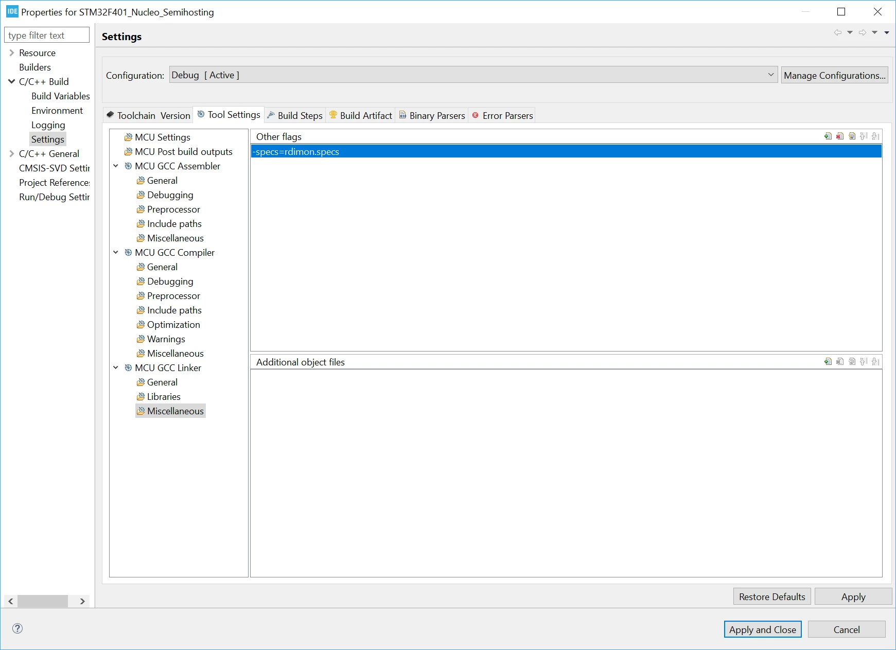

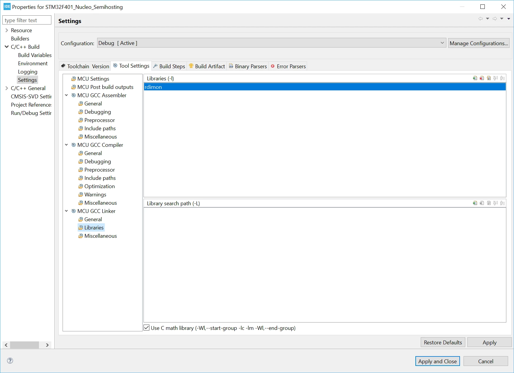

2.3. Update GCC Linker configuration
In Libraries add “rdimon” library.
In Miscellaneous add Other flags “-specs=rdimon.specs”

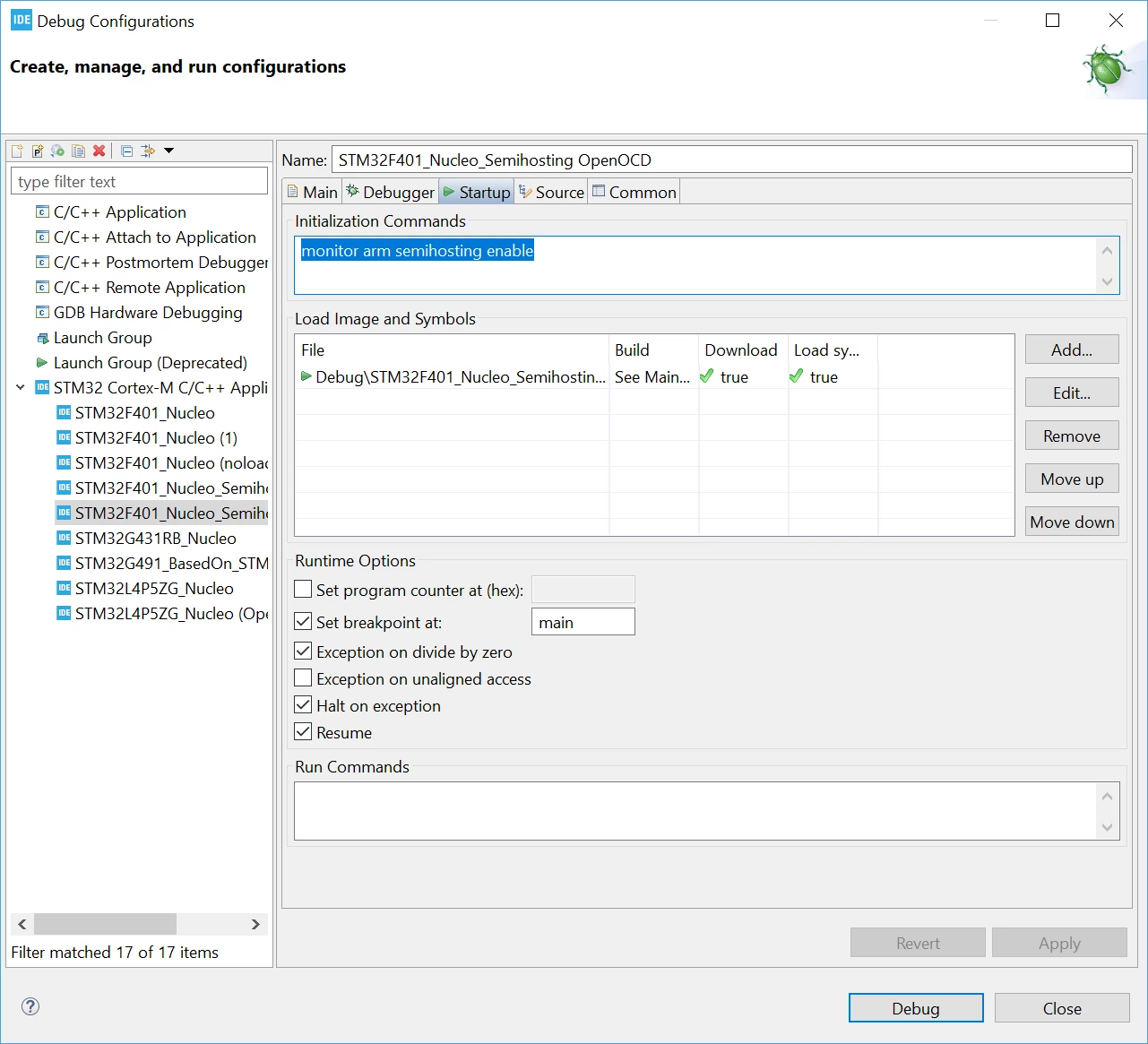

3.1. Create/Update OpenOCD debug configuration
Create a new debug configuration for the project or update an existing one. Make sure that OpenOCD is used.
Note: ST-LINK GDB server does not support semihosting.
Add “monitor arm semihosting enable” initialization command in Debug Configurations - Startup tab.
