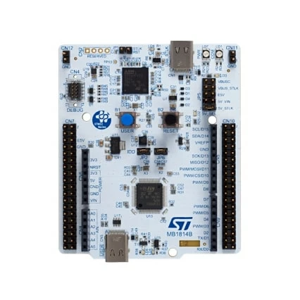

In this article, we cover the steps needed to use the Register callback's feature in STM32. The NUCLEO-H503RB (with an STM32H503RBT6 microcontroller) board is used, but the steps can be easily tailored to another MCU. All the implementation was done over the STM32CubeIDE v1.13.1 but can be implemented in any other version with minor step changes.
Figure 1 – NUCLEO-H503RB Source: Adapted from https://www.st.com/en/evaluation-tools/nucleo-h503rb.htmlFigure 1 – NUCLEO-H503RB Source: Adapted from https://www.st.com/en/evaluation-tools/nucleo-h503rb.html

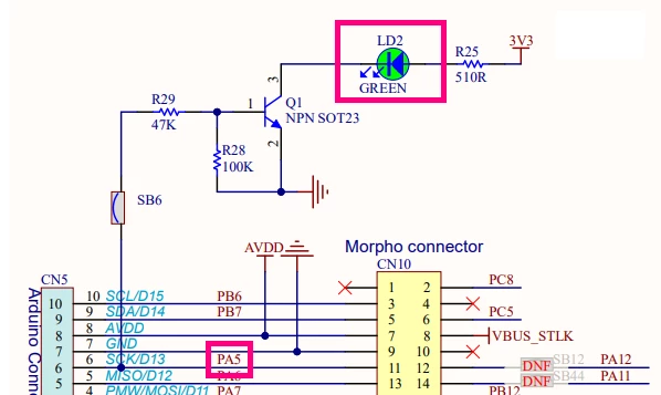

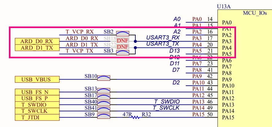

In this demonstration, we use the STLINK VCOM Port connected to the MCU's USART3 (figure 2). Furthermore, we use the TIM2 and the board’s user LED (figure 3). Two callbacks are registered: one for the UART_Tx and the other one for the timer overflow, also known as period elapsed interrupt. By the end of this article, you should have the necessary knowledge to do your own Register callback implementations in any kind of application. So, grab your coffee, settle into your chair, and let us start coding!
Figure 2 – Connection between MCU’s USART3 and ST-LINK's VCOM PortFigure 2 – Connection between MCU’s USART3 and ST-LINK's VCOM Port
Source: Adapted from https://www.st.com/content/ccc/resource/technical/layouts_and_diagrams/schematic_pack/group2/94/07/0d/de/30/11/4c/3b/mb-1814-h503rb-b02-schematic/files/mb1814-h503rb-b02-schematic.pdf/jcr:content/translations/en.mb1814-h503rb-b02-schematic.pdf
Figure 3 – User’s LED ConnectionFigure 3 – User’s LED Connection

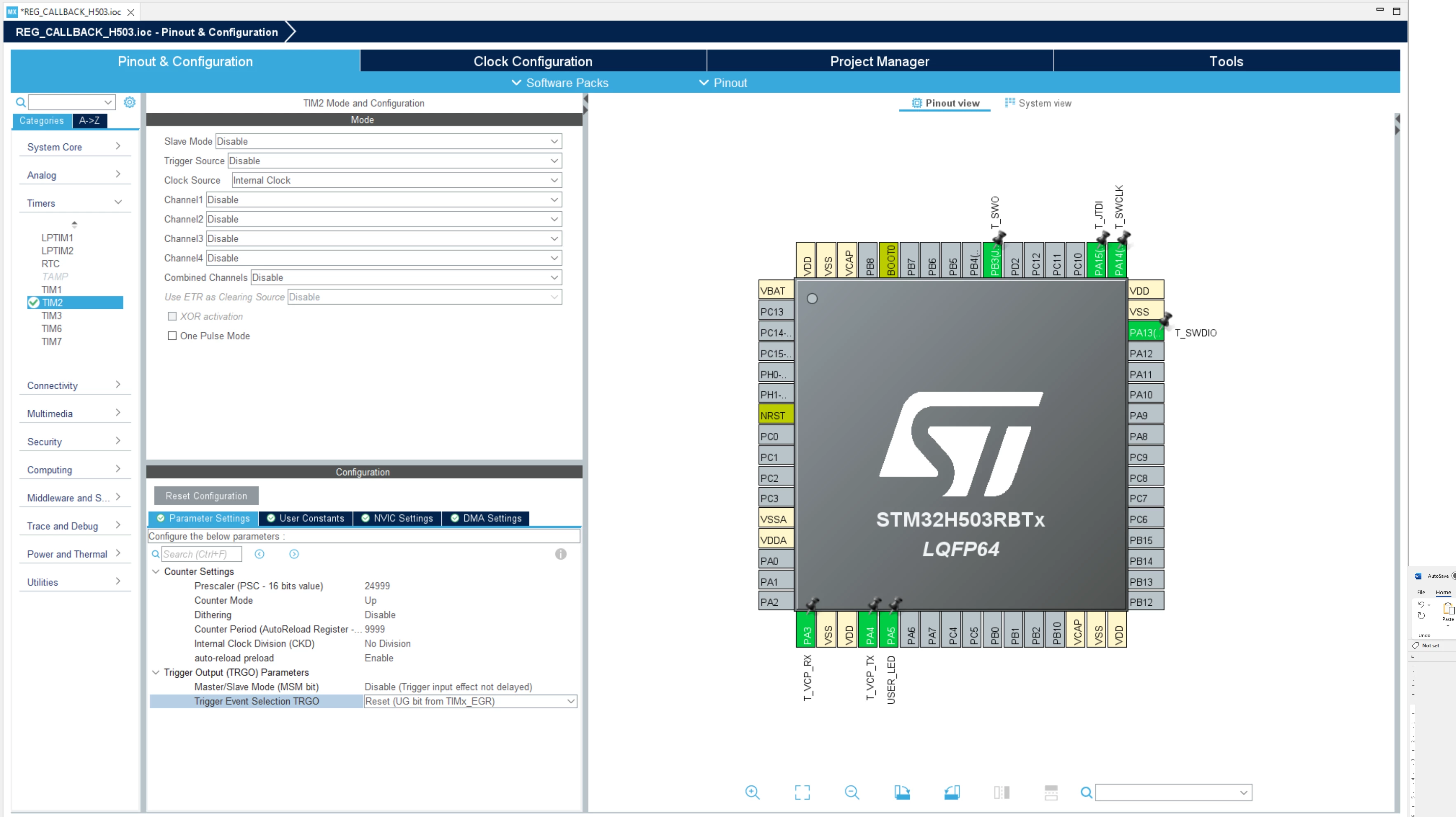

Create a project for the STM32H503RB using the STM32CubeIDE. In this project, the following settings are applied:
  • USART3: 115200 bits/s - 8N1:
    • PA3 as UART_RX.
    • PA4 as UART_TX.
  • PA5 as GPIO Output with USER_LED label.
  • TIM2 as 1 second time base:
    • Internal clock as source.
    • Prescaler as 24999
    • Counter period as 9999
    • Autoreload preload enabled.
  • NVIC: Enable both USART3’s and TIM2’s ISRs.
Figure 4 – MCU Project Settings. Source: Author’s screenshot.Figure 4 – MCU Project Settings. Source: Author’s screenshot.

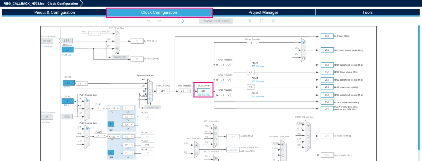

The next changes are made at the clock configuration tab. In this tab, the HCLK frequency needs to be changed to 250 MHz (this frequency matches the TIM2 settings for the 1 second time base).
Figure 5 – Clock configuration settings. Source: Author’s screenshot.Figure 5 – Clock configuration settings. Source: Author’s screenshot.

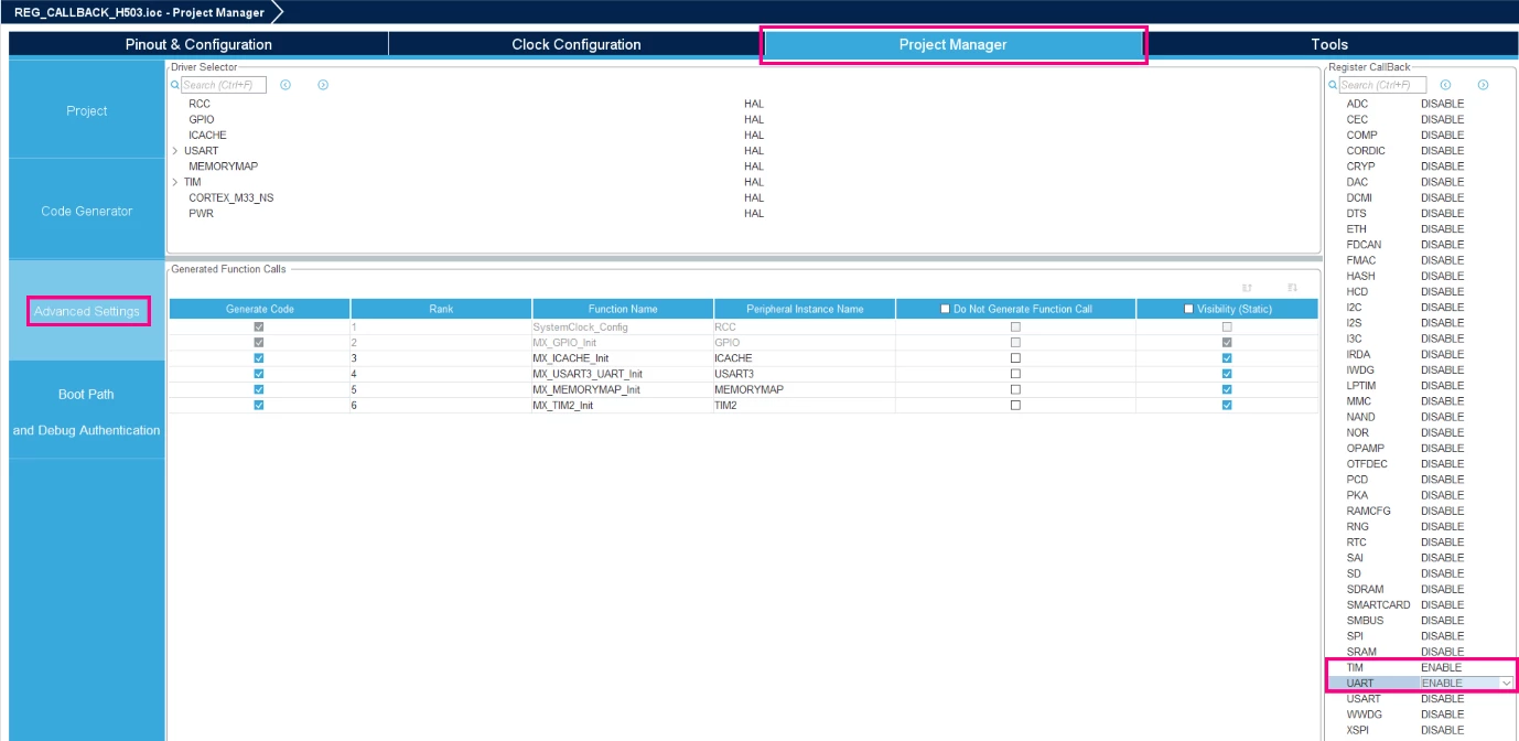

The last step, before the code generation, is to enable the register callback. For that, the UART and TIM register callbacks should be enabled under project manager -> advanced settings as shown in figure 6.
Figure 6 – Enabling the Register CallBack for UART and TIM. Source: Author’s screenshotFigure 6 – Enabling the Register CallBack for UART and TIM. Source: Author’s screenshot

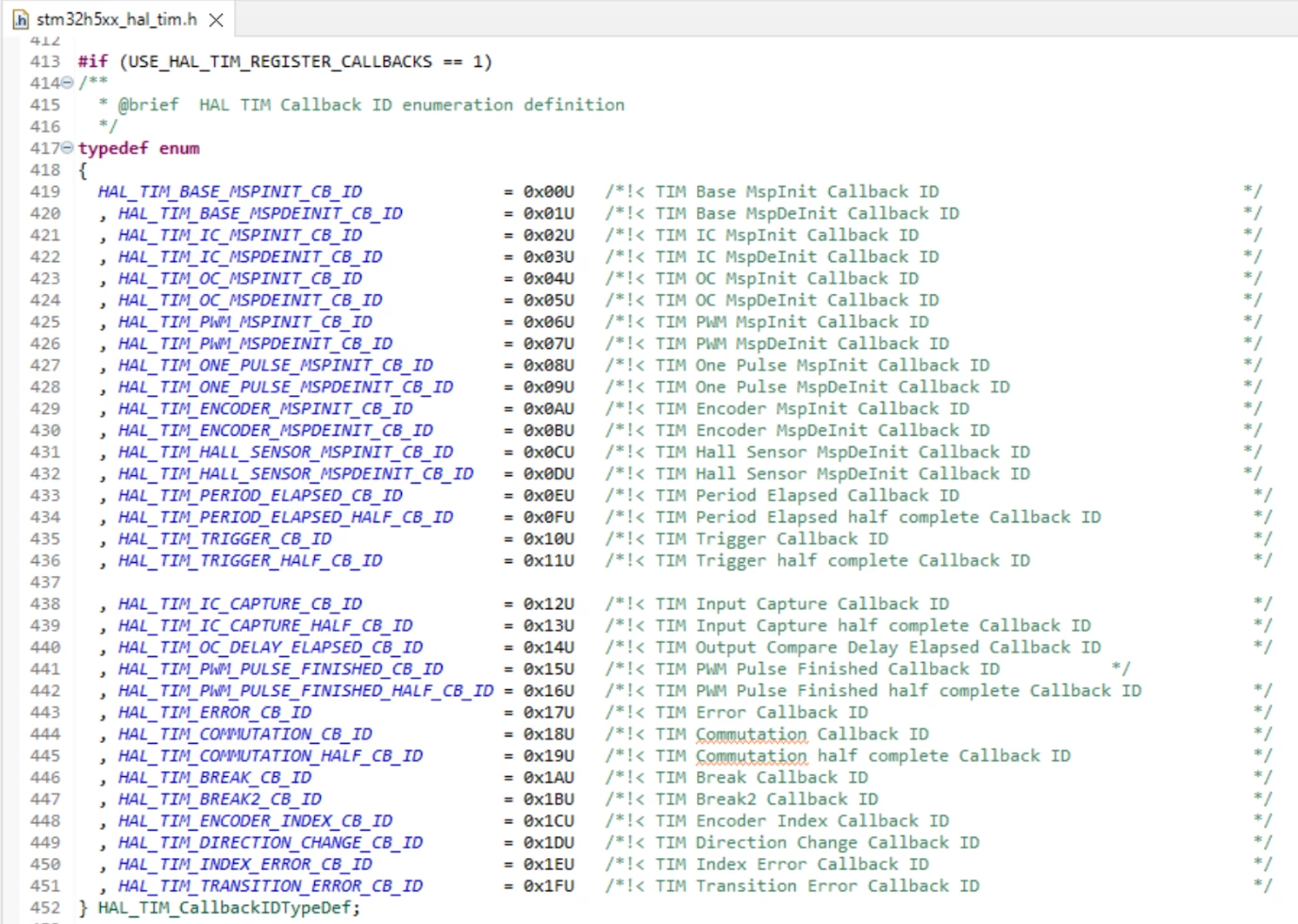

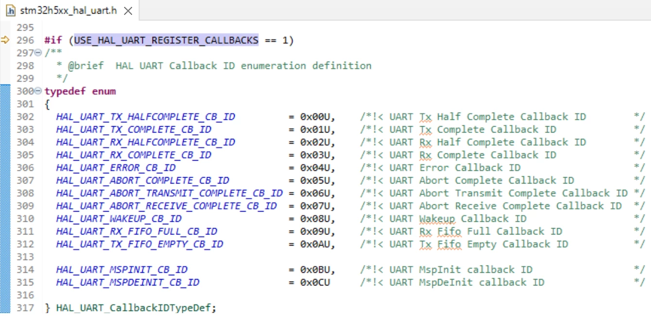

Note that we have some parameters to fill. The first one is a pointer to the peripheral handler, &huart3 and &htim2 for the UART3 and TIM2 respectively. The second parameter is a CallBack ID, which points to which the interrupt source calls the given CallBack. A list of these IDs can be found in the respective peripheral HAL driver headers. See figures 7 and 8.
Figure 7 – List of UART CallBack IDs. Source: Author’s screenshot.Figure 7 – List of UART CallBack IDs. Source: Author’s screenshot.
Figure 8 – List of TIM CallBack IDs. Source: Author’s screenshot.Figure 8 – List of TIM CallBack IDs. Source: Author’s screenshot.

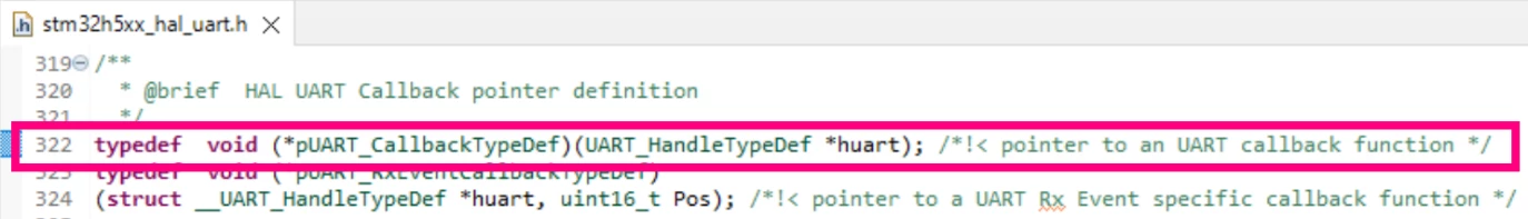

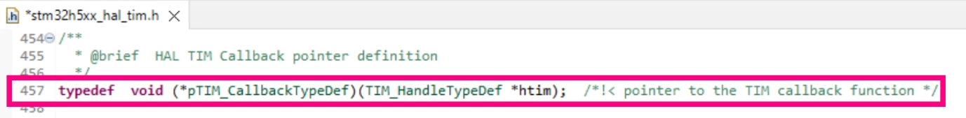

Finally, the last parameter is a pointer to your custom CallBack function. Just make sure that your function respects the same structure as the HAL excepts. You can find the correct structure in the p[Peripheral]_CallbackTypeDef (like pUART_CallbackTypeDef). See the examples below:
Figure 9 – UART Callback structure. Source: Author’s screenshot.Figure 9 – UART Callback structure. Source: Author’s screenshot.
Figure 10 – TIM Callback structure. Source: Author’s screenshot.Figure 10 – TIM Callback structure. Source: Author’s screenshot.

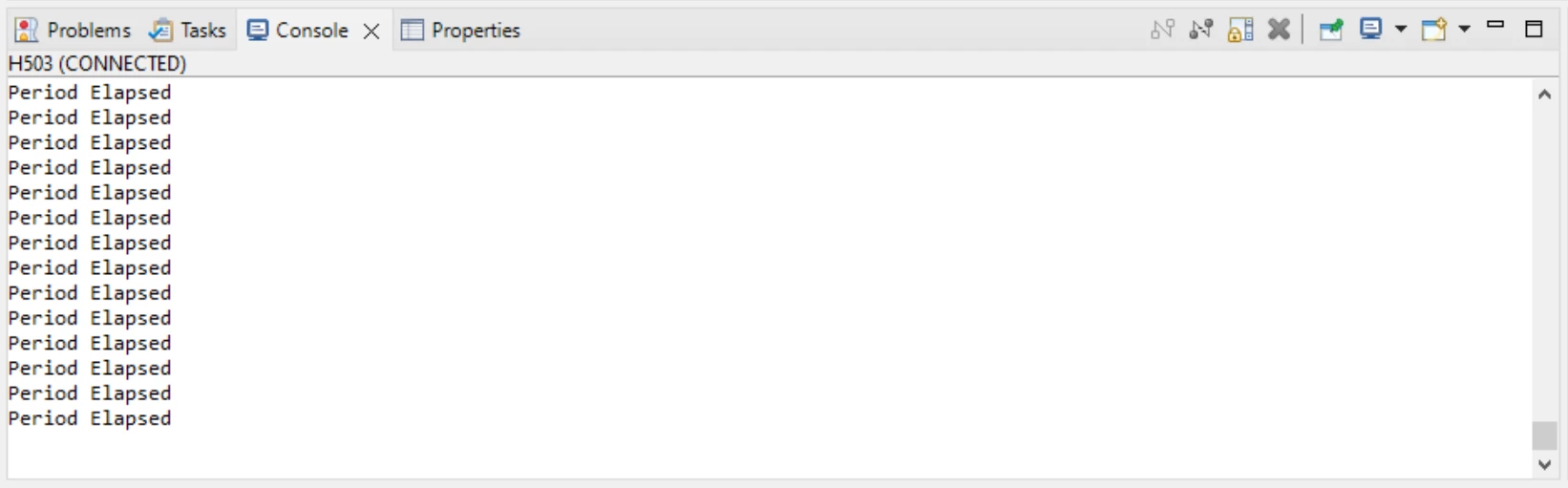

Now that you have completed all the steps to implement the Register callback feature, you can build the code, flash it onto your microcontroller, open a terminal and see the application in action.
2. How does this demonstration work?
This application utilizes timer 2 to generate a 1-second time base, resulting in an interruption being generated every second. This interrupt calls the custom period elapsed callback function, which sets the periodElapsed flag. This flag is used in the infinite while loop in the main function. Once the periodElapsed flag is set, the code within the main loop transmits the defined message through the UART in interruption mode (non-blocking). After the message is queued to be sent, the periodElapsed flag is reset. Finally, once the message transmission is complete, a Tx complete callback is generated, calling the UART custom callback function, which toggles the LED status.
In summary, this application sends a message through the UART every second. The application changes the LED status once the message is fully sent, utilizing the custom callback functions that were created.
Figure 11 – Demonstration Results in the STM32CubeIDE Serial Terminal.Source: Author’s screenshot.Figure 11 – Demonstration Results in the STM32CubeIDE Serial Terminal.Source: Author’s screenshot.
