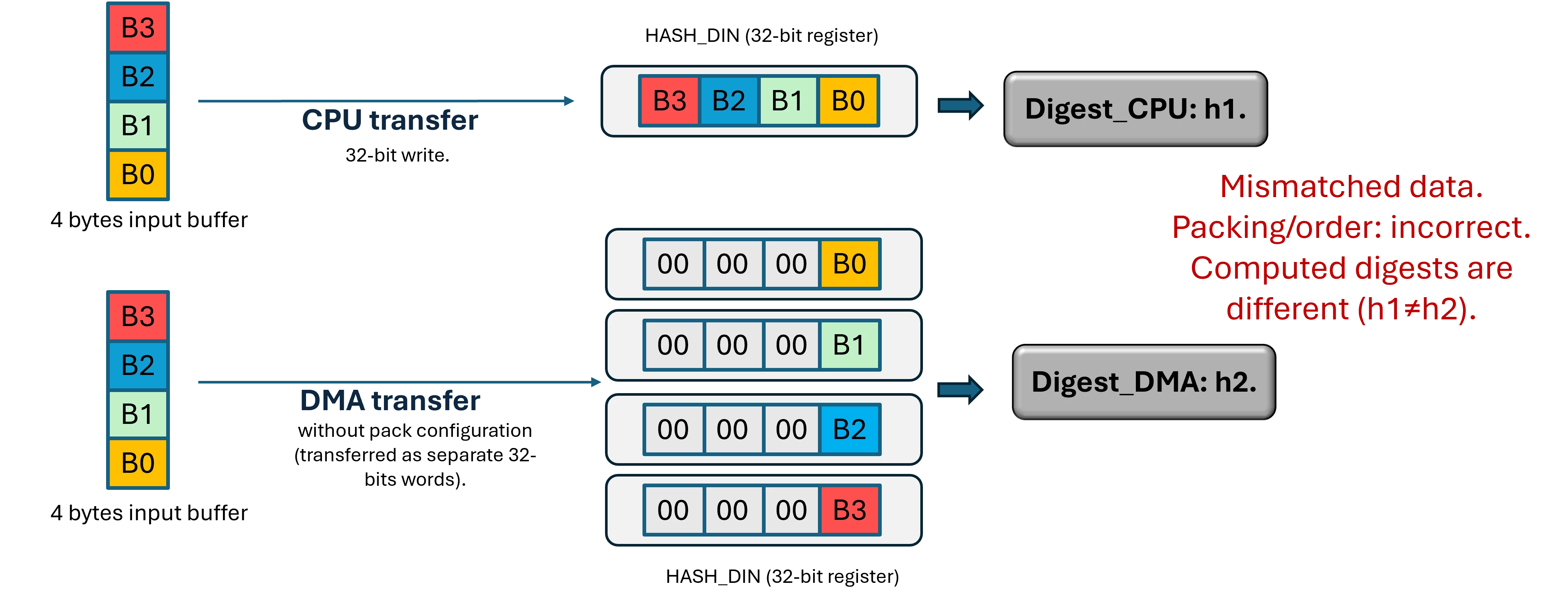

A common (but incorrect) way to use DMA in this context is to rely on the fact that the message is a sequence of bytes. Additionally, assuming that the DMA + HASH combination implicitly packs these bytes into 32‑bit words as needed by the HASH engine. In practice, the CPU path uses a single 32-bit write, while the DMA path generates multiple 32-bit writes from bytes. As a result, they do not produce the same input word sequence for the HASH core.
The figure below (CPU vs DMA transfer) illustrates this behavior using a simple 4‑byte input buffer [B3 B2 B1 B0]:
  • When the CPU performs a single 32‑bit write to HASH_DIN, the four bytes are presented to the HASH as one 32‑bit word [B3 B2 B1 B0], and the digest h₁ is computed from this expected layout.
  • When DMA is used without any explicit packing, each byte B0, B1, B2, B3 is effectively sent as a separate 32‑bit word (0x000000B0, 0x000000B1, …), so the HASH core sees a completely different message and computes a different digest h₂.
Even though the original byte values are the same and the DMA transfer completes without error, the mismatch in byte‑to‑word packing leads to h₁ ≠ h₂

When data is written by the CPU as a single 32‑bit word, the relationship between the four bytes and the resulting word is explicit and well‑defined. In contrast, DMA may process the message as bytes without a consistent packing strategy. In that case, each byte can end up as a separate 32-bit word written to HASH_DIN.
2.2 Why the digest differs between CPU and DMA paths
The digest difference comes from the fact that the HASH engine sees two different messages:
  • CPU path
    • One 32‑bit write: HASH_DIN = [B3 B2 B1 B0].
    • The logical message seen by HASH is [B3 B2 B1 B0].
  • DMA path without packing
    • Four 32‑bit writes:
      • HASH_DIN = 0x000000B0,
      • HASH_DIN = 0x000000B1,
      • HASH_DIN = 0x000000B2,
      • HASH_DIN = 0x000000B3.
    • The logical message seen by HASH is [00 00 00 B0, 00 00 00 B1, 00 00 00 B2, 00 00 00 B3].
Although the original input buffer [B3 B2 B1 B0] is identical in both cases, the sequence of 32‑bit words processed by the HASH core is not. Since the HASH algorithm operates on these words, not directly on the conceptual byte stream, the resulting digest h₂ is different from h₁.
In other words:
  • The problem is not that bytes are lost or corrupted,
  • The problem is that each byte is packed into words differently depending on whether the CPU or DMA is used,
  • Without explicit and consistent byte‑to‑word packing, CPU, and DMA paths cannot be expected to produce the same digest for the same byte buffer.
The next sections of this article shows how to configure the data path so that:
  • bytes are packed into 32‑bit words in a controlled way, and
  • the HASH input sequence is identical between CPU and DMA usage, ensuring h₁ = h₂.

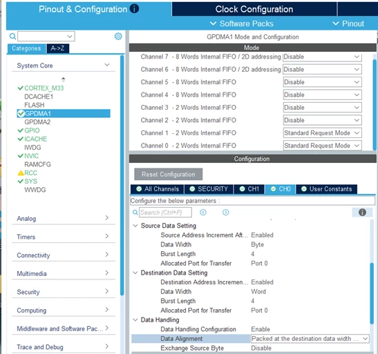

If you prefer using CubeMX, the same configuration is expressed in the Data Handling section of the GPDMA channel (as shown below):
  • Data Handling ConfigurationEnable
  • Data AlignmentPacked at destination data width (for src < dest)
  • Exchange Source Byte / Destination Half Word / Destination ByteDisable (or set them according to the byte order you want at destination).

Key point: with PACK correctly configured, the DMA no longer sends one full 32‑bit word per byte, but packs several bytes into each destination word exactly as described by the table.

This is controlled by the HASH data format configuration (for example HASH_DATATYPE and any word/byte swap options).
From an instructional perspective:
  1. Choose your global convention, for example:
    “The logical message bytes are in the order B0, B1, B2, B3, … as seen by the HASH algorithm.”
  2. Use the PAM/SB/DB/DH combination that produces this byte order at the destination (see the “Destination data stream” column in the programmed data handling table).
  3. Set HASH_DATATYPE / swap so that the HASH core interprets the bytes inside each 32‑bit word consistently with that convention (no swap, byte swap, etc.).
The goal is that, for a given message:
  • The logical byte stream seen by the HASH core is identical.
  • This applies whether the data is written by the CPU or transferred via GPDMA.
3.4 What you must respect
To summarize what must be respected to fix the issue:
  • Packing responsibility
    • The GPDMA must be explicitly configured (via PAM/SB/DB/DH or CubeMX Data Handling) to pack bytes into words according to your desired ordering.
    • Do not rely on default behavior; default “byte→word” can produce one 32‑bit word per byte.
  • Endianness and intention
    • Decide clearly what 32‑bit word layout represents your message (for example [B3 B2 B1 B0]).
    • Use the programmed data handling table to pick the PAM/SB/DB/DH combination that yields this layout at the destination.
    • Configure the HASH (HASH_DATATYPE, etc.) so that the interpretation of each word matches this layout and your reference vectors.
  • Consistency CPU vs DMA
    • CPU 32‑bit writes and DMA transfers must produce the same sequence of 32‑bit words at HASH_DIN.
    • When this is true, the digest computed with DMA is guaranteed to match the digest computed with pure CPU writes.
By explicitly using GPDMA programmed data handling, you can control packing, not just alignment.
This ensures that the HASH peripheral receives the correct input word stream and resolves the digest mismatch problem.
