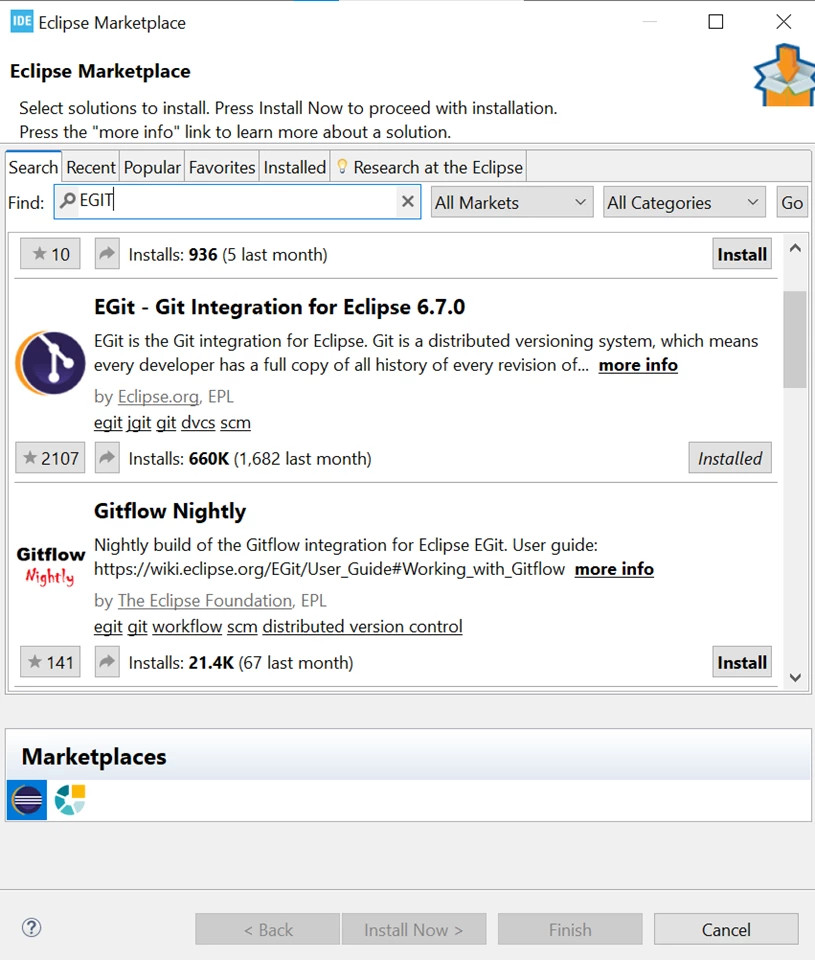

5. Install the EGit plugin
To install the EGit plugin in STM32CubeIDE, start by launching STM32CubeIDE on your computer. Next, go to the [Help] menu at the top of the screen and select [Eclipse Marketplace]. In the Eclipse Marketplace window, use the search bar to search for [EGit]. Find the EGit plugin in the search results and click the [Install] button next to EGit. Follow the prompts to complete the installation.

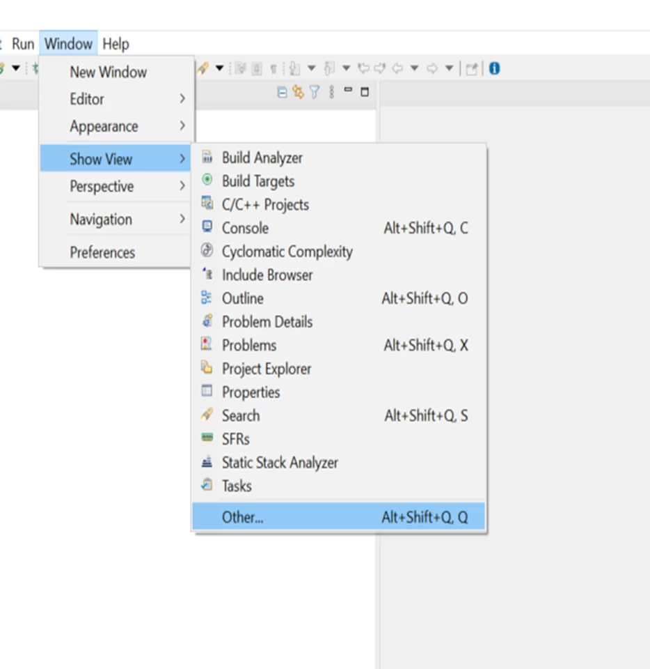

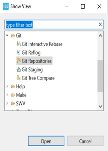

Once the installation is complete, restart STM32CubeIDE to apply the changes. After restarting, navigate to the [Window] menu, select [Show View], then [Other]. In the dialog that appears, expand the [Git] folder, select [Git Repositories], and click [OK].

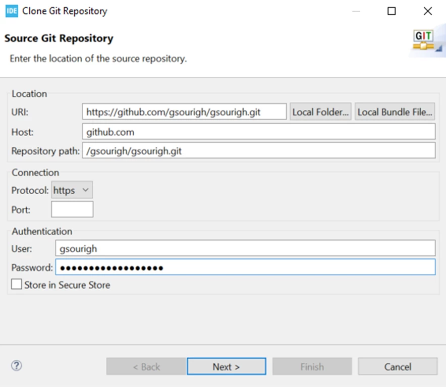

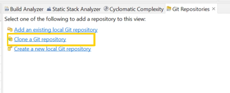

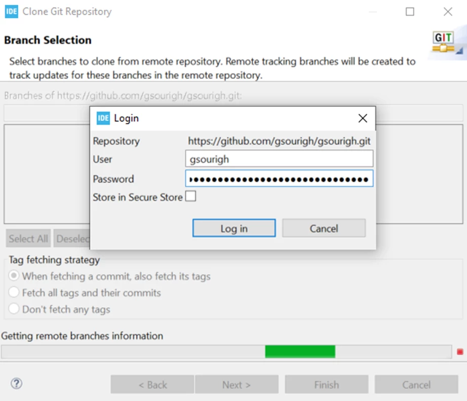

To clone a repository, start by selecting the [Clone a Git repository] option. In the "Clone Git Repository" window, paste the URL of the GitHub repository you created earlier. Next, in the "Authentication" field, enter your GitHub username. For the "Password" field, use the personal access token you generated earlier instead of your GitHub password. Finally, click [Next] to proceed.

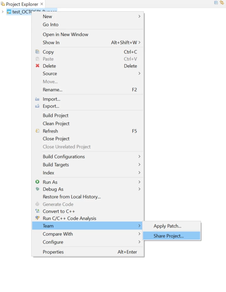

To link your project to a GitHub repository, right-click on the project in the Project Explorer. From the context menu, navigate to the "Team" menu and click on [Share Project]. In the dialog that appears, enter your GitHub username and the personal access token you generated earlier. Then, choose the GitHub repository you created and cloned earlier. Finally, click the [Finish] button to complete the linking process.
