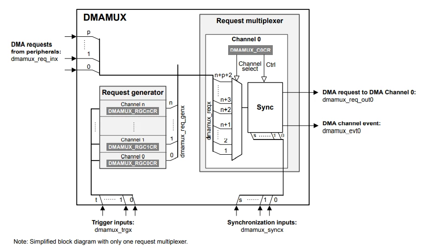

The DMAMUX request multiplexer enables routing DMA request lines from the peripherals to the DMA controllers in the products. The routing function is ensured by a programmable multi-channel DMA request line multiplexer. Each channel selects a unique DMA request line to forward (unconditionally or synchronously) to the associated DMA controller channel. This allows DMA requests to be managed with a high flexibility, maximizing the number of DMA requests that run concurrently.
3. DMAMUX features
​​​​​​Features include:
  • Request routing and synchronization
  • Request generation
  • Request generation and synchronization

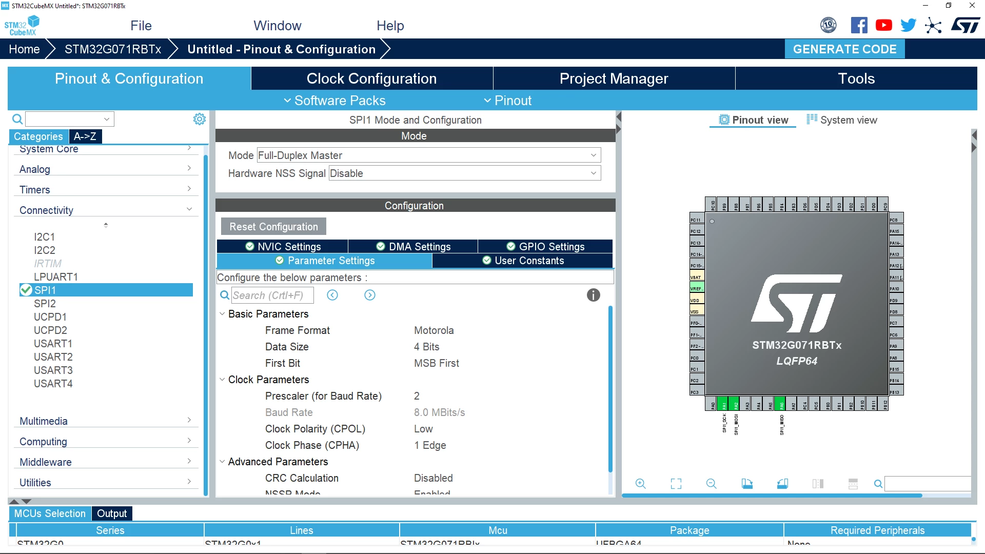

The first step within STM32CubeMX is to enable the SPI peripheral that is going to be used for serial communication (see figure below):

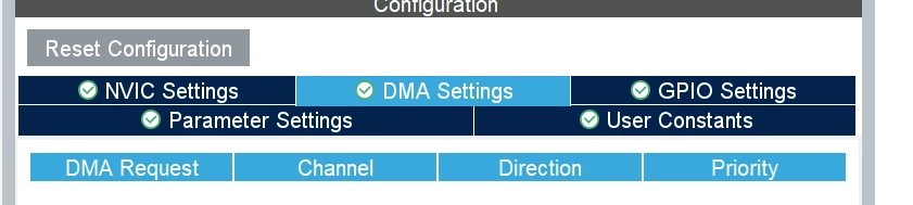

The next step is to click on DMA Settings to make those configurations:
We are going to add two DMA Requests, one for SPI RX (reception) and one for SPI TX (transmission). To do this click on Add.

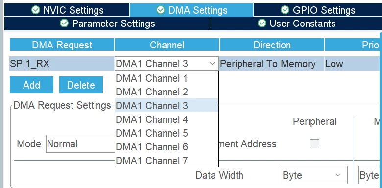

Now click on Select in the drop-down box and then click on SPI1_RX.
Because of DMAMUX's flexibility you can select any DMA channel for the peripheral you are using. In this example case, channel 3 is selected by clicking on the drop-down box and clicking on DMA1 Channel 3.

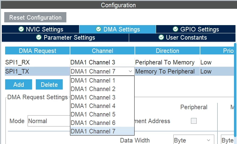

The next step is to select the DMAMUX channel for SPI1_TX.  Again, due to the flexibility of DMAMUX, any channel is available and channel 7 is used in this example.
As illustrated in this example, DMAMUX offers the flexibility to select any DMA channel to be used with the peripherals as opposed to being limited to a specific channel.

Thanks a lot. The fixed RM0440 saved me quite some time. Nether the less the DMAMUX chapter still is a mess. The difference between "unconditional request forwarding" and "conditional request forwarding" is not described. Without AN5224 it is really hard to understand the DMAMUX. Also Figure 32 of RM0440 is missing (page 428), which should be equal or similar to Figure 2 of AN5224 (or the second Figure on this page).
