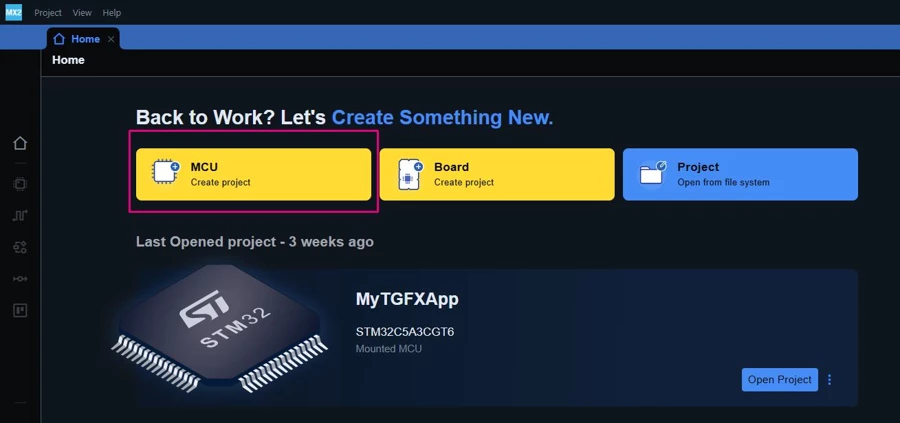

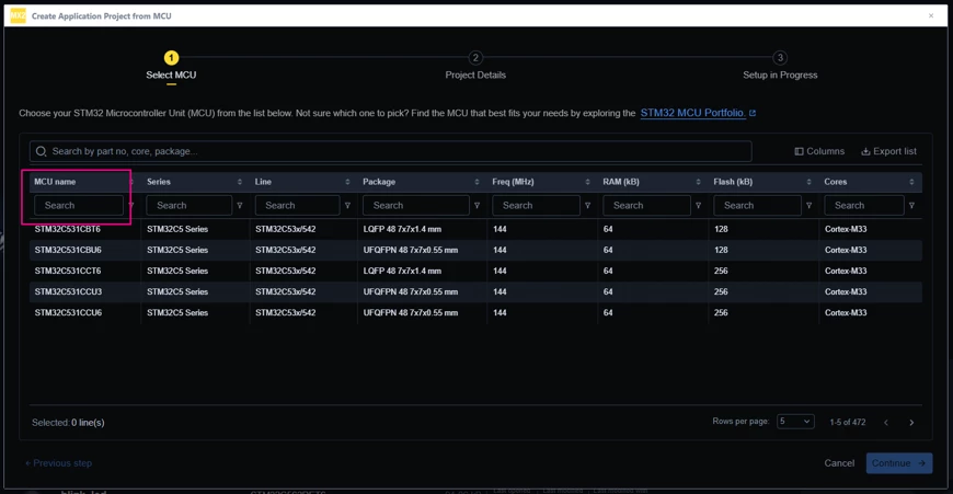

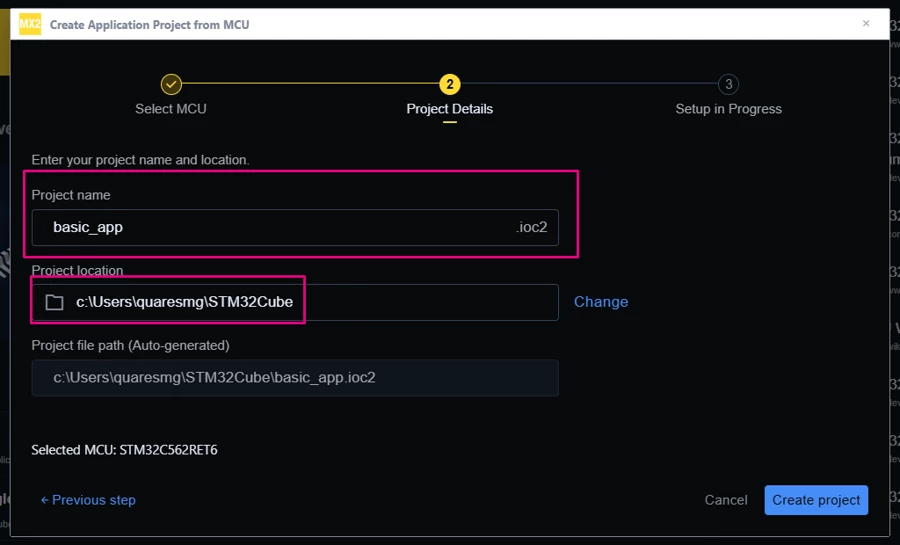

Open STM32CubeMX2. On the Home tab or icon, click the MCU button to create a new project.
In the search field under MCU name, enter STM32C562RE and select the MCU. Click [Continue].
Enter the project name and location. Click [Automatically Download, Install & Create Project] to finish project creation. Select [Launch Project] to start.

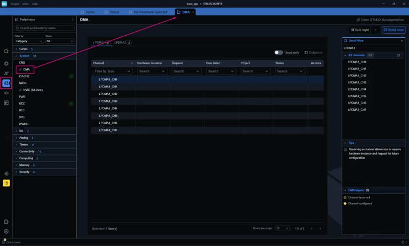

To configure DMA in STM32CubeMX2:

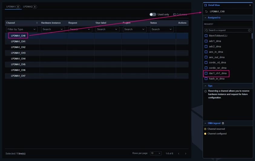

  1. In the Peripherals tab, open the System drop-down list and select [DMA].

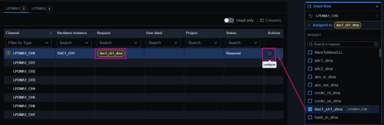

  2. In the DMA System View page, go to the LPDMA1 tab and select channel [LPDMA1_CH0]. Then click [dac1_ch1_dma] to assign the channel to the DAC.
    This example uses the DAC, but circular mode works with many other peripherals, such as the ADC or the UART.
  3. Click the gear icon next to dac1_ch1_dma, or click Actions, to configure the channel.

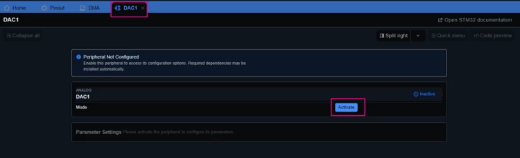

  4. In the DAC1 page, click [Activate].

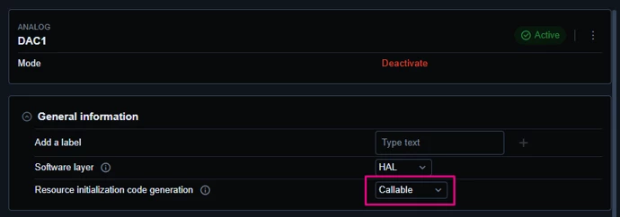

  5. In the General information tab, set Resource initialization code generation to [Callable].

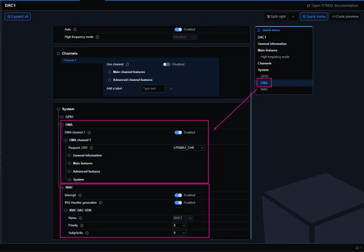

  6. Go to System → DMA → DMA channel 1 and toggle the switch on to enable it.

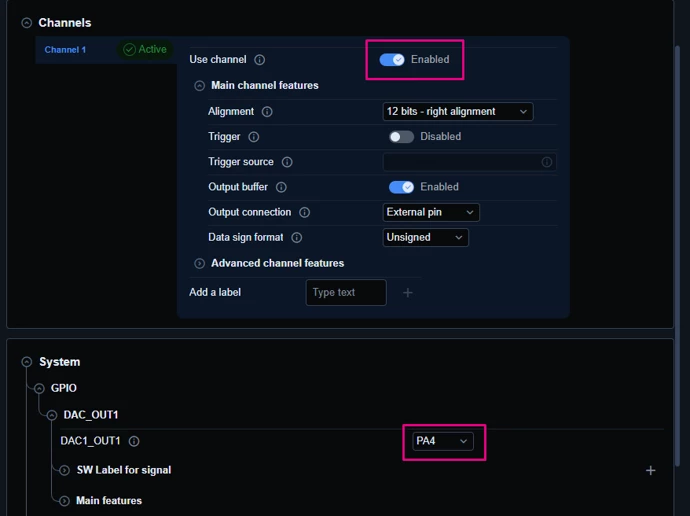

  7. Enable DAC channel 1 in Channels → Use channel. The assigned pin is seen in System → GPIO → DAC_OUT1. It is typically PA4.

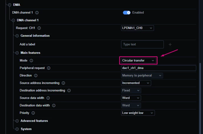

  8. Go to System → DMA → Main features → Mode and select Circular transfer.
    Keep the other default settings: the direction is Memory to peripheral, the source address is incremented so the DMA walks through the buffer. The destination address is fixed because the DMA always writes to the same DAC register.

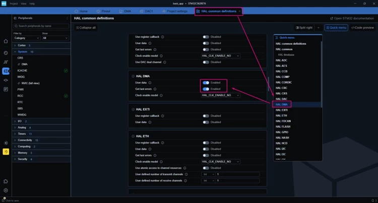

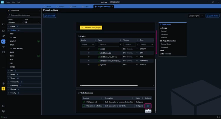

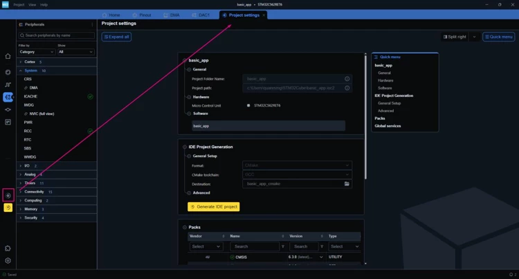

  9. Select the [Project settings] icon. In Global services, click the gear icon next to HAL common definitions.
  10. Use the quick menu to locate the HAL DMA category, and enable [User Data] and [Get Last Errors].
    The NVIC interrupt (System → NVIC) is not required for this example, because the code does not use any DMA callback. Enable it only if your application needs to know when the DMA reaches the end of the buffer, for example to update the buffer contents while the transfer runs.

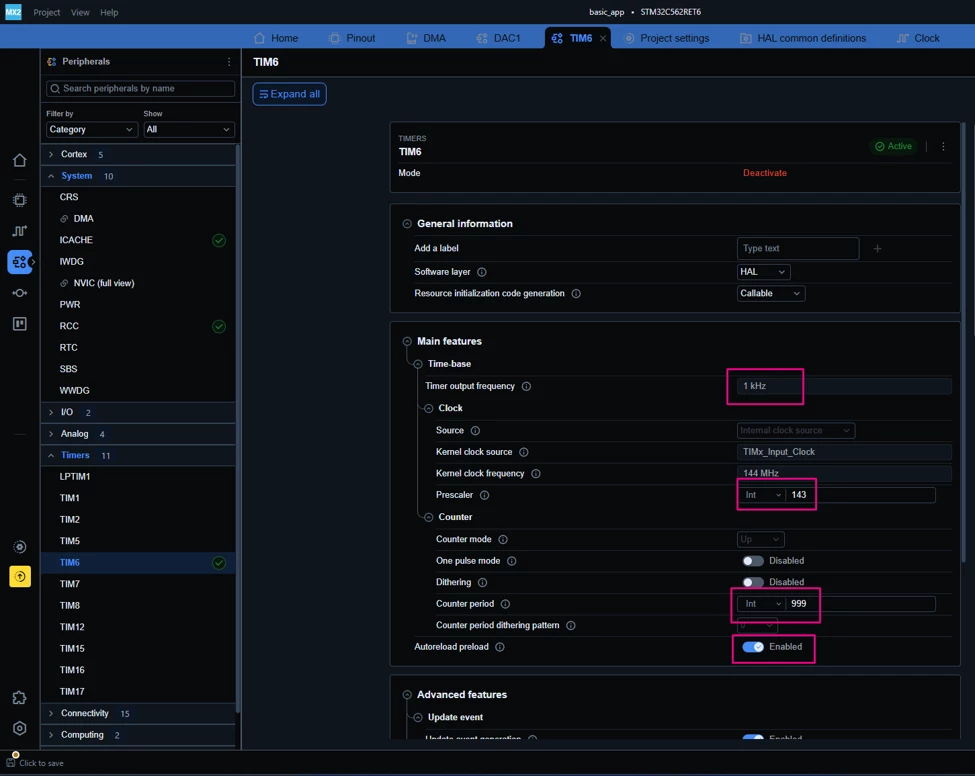

2.3 Configuring the DAC trigger and TIM6
In this example, TIM6 sets the output rate. Each TIM6 update event triggers the DAC, and the DAC asks the DMA for the next sample. Without a trigger, the DMA has nothing to pace it.

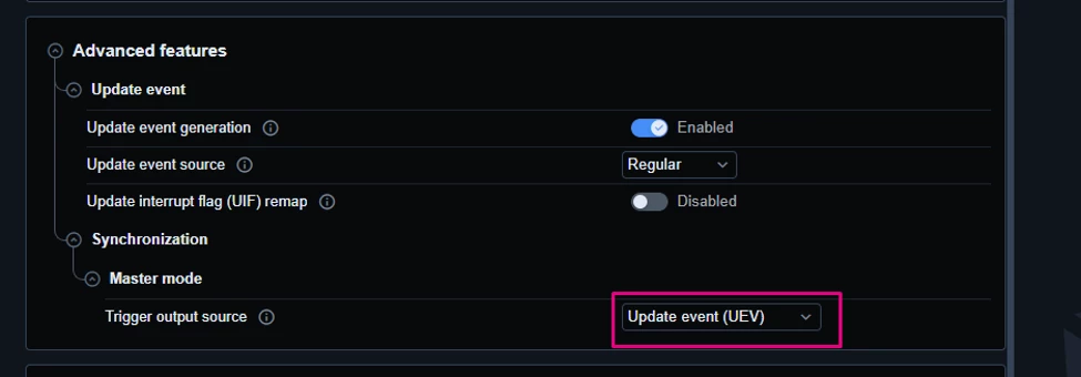

First, configure TIM6 to generate an update event every 1 ms (1 kHz):
  1. In the Peripherals tab, open the Timers drop-down list and select [TIM6]. Click [Activate].
  2. Check the TIM6 input clock in the Clock tab. TIM6 is a basic timer, so this is the only clock you need to know.
  3. Set Prescaler and Period to get 1 kHz. The update frequency is: timer clock / ((Prescaler + 1) × (Period + 1)). For example, with a 48 MHz timer clock, set Prescaler to 47 and Period to 999: 48 MHz / (48 × 1000) = 1 kHz.
  4. Set Trigger output (TRGO) to Update event. With this setting, TIM6 sends a trigger signal at each update event.

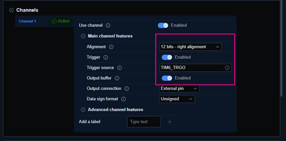

    Connect the DAC to this trigger:
  1. Go back to the DAC1 page and open Channels → Main channel features.
  2. Enable Trigger.
  3. Set Trigger source to TIM6.
    Now, the DAC converts a new value only when TIM6 sends a trigger. The output rate depends only on TIM6: to change the frequency of the waveform, you only need to change the TIM6 period.

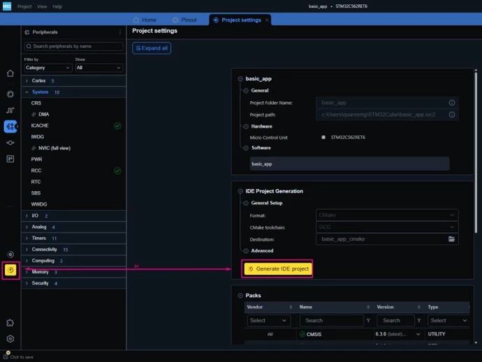

2.4 Code generation​​​​​​​
To generate the code:
  1. Click the [Project settings] icon.
  2. Click [Generate IDE project].

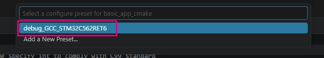

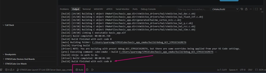

If prompted, select the configuration. If not prompted, press Ctrl+Shift+P, type CMake: Select Configure Preset, and choose the debug configuration.
Build the project to make sure that everything is set, and then move on to the code.

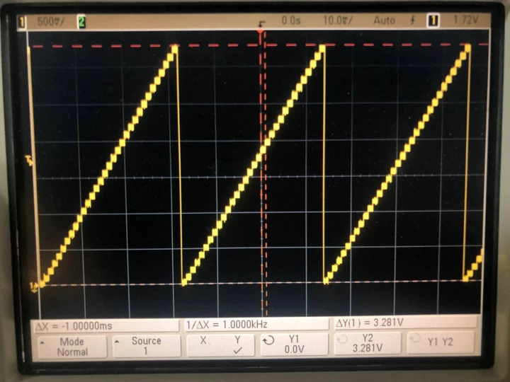

The result is a sawtooth with 32 steps of about 103 mV, from 0 V to about 3.2 V. Each step lasts 1 ms, so the full ramp repeats every 32 ms.
3.3 Validation

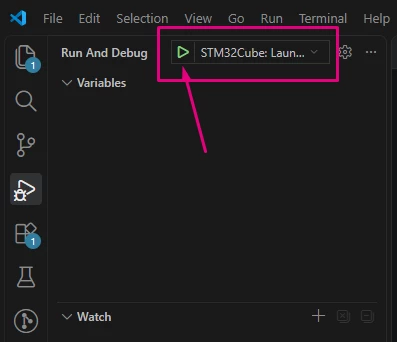

After building the application, select the [Run and Debug] icon. Create a debug session by selecting the [STLINK GDB Server] option.
Run the code and connect an oscilloscope probe to PA4 (CN8 pin 3) and GND. You can see the sawtooth waveform, with each step updated at the TIM6 frequency.
The waveform keeps running even though the main loop is empty. This shows the DMA restarting the buffer by itself in circular mode.
