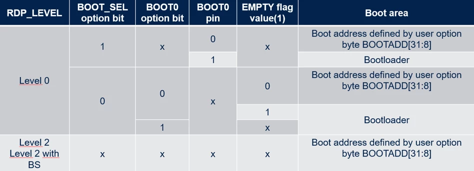

2. Boot selection logic
The decision of which area to boot from is driven by a combination of the BOOT0 pin, the BOOT_SEL option bit, and the readout protection (RDP) level.
In a standard configuration with RDP level 0 (no readout protection), the interaction between hardware and software defines the boot source. If the BOOT_SEL option bit is cleared (0), the BOOT0 pin is active and dictates the boot mode. A high or low state on the pin directs the system to system memory or user flash, respectively.
Conversely, if BOOT_SEL is set (1), the physical BOOT0 pin is ignored. In this state, the device is forced to boot from the address defined by BOOTADD in user flash, ensuring a deterministic startup regardless of external pin states. However, this forced boot can still be overridden by the empty check mechanism.
3. EMPTY check mechanism
To prevent the system from attempting to execute code from an unprogrammed memory location, the STM32C5 implements an automatic empty check. During the option byte loading phase at reset, the flash memory interface reads the 32-bit word located at the address defined by BOOTADD.
If this word equals 0xFFFF FFFF, the location is considered empty. This status is reflected in the EMPTY bit of the flash access control register (FLASH_ACR). If the user flash is determined to be empty (EMPTY = 1), the system overrides the standard boot selection and automatically falls back to the embedded bootloader in system memory. This feature ensures that fresh or mass-erased devices have a recovery path, allowing programming via the supported interfaces without manual pin intervention. The EMPTY status can be read and modified by software, allowing applications to force a bootloader entry on the next reset by manipulating the FLASH_ACR register.

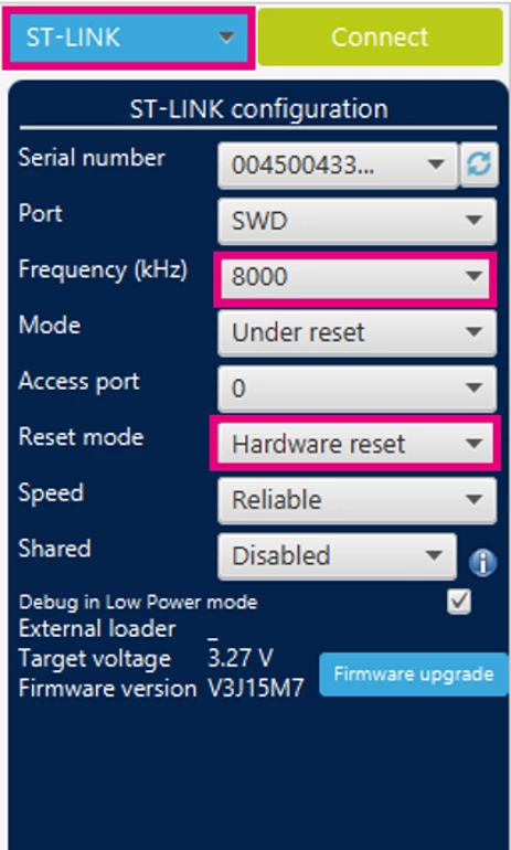

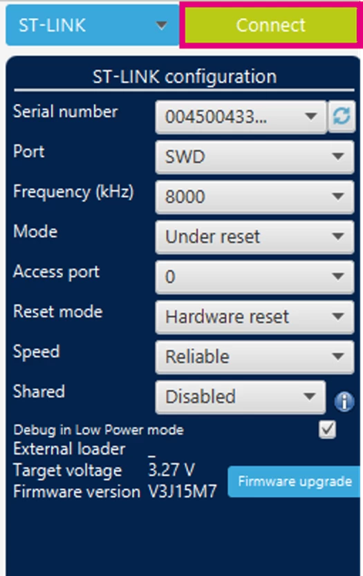

5.2 Connect to the target
  1. In the top‑right ST‑LINK panel:
    1. Select ST‑LINK as the connection mode.
    2. Keep the default SWD frequency and reset mode (for example, hardware reset).
  1. Click [Connect].

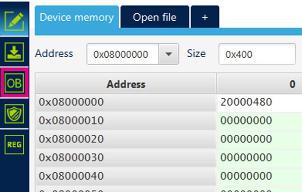

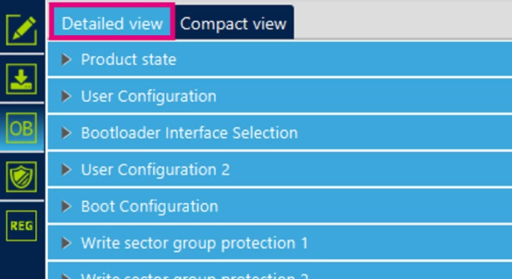

5.3 Open the option bytes view
  1. In the left toolbar, click the “OB” (option bytes) icon.
  1. Ensure “Detailed view” is selected (top left of the option‑bytes pane).

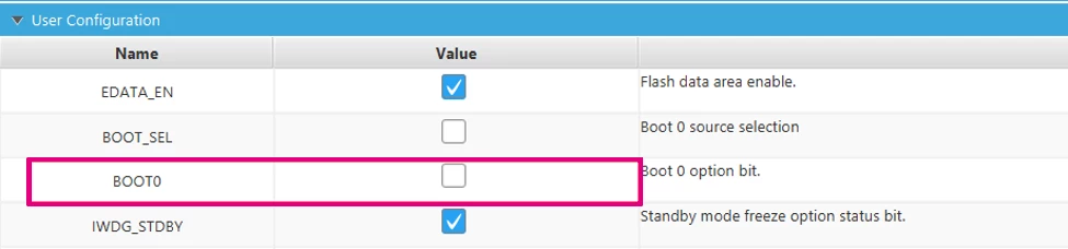

5.4 Configure boot to system memory (system bootloader)
This uses the BOOT_SEL and BOOT0 option bits.
  1. In the User Configuration section:
    1. Ensure BOOT_SEL is unchecked
      → This makes the device take the BOOT0 value from the option bit rather than only from the pin (see RM0522 / AN2606).
    1. Select the BOOT0 checkbox
      → For STM32C5, a BOOT0 value of 1 (checked) selects the system memory bootloader instead of user flash (refer to the boot mode table in RM0522).

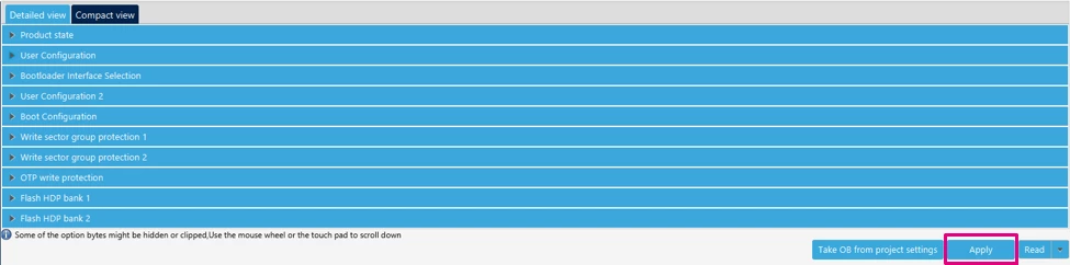

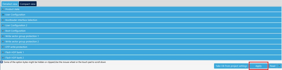

5.5 Program the new option bytes
  1. At the bottom of the option‑byte pane, click [Apply].
  1. Confirm the option byte programming dialog.
    1. CubeProgrammer will erase/program one or more affected OB words and automatically reset the device.
After the reset, the STM32C5 does not jump to user flash but starts from the system memory and runs the native system bootloader.

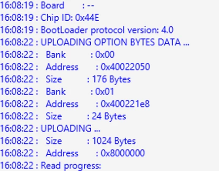

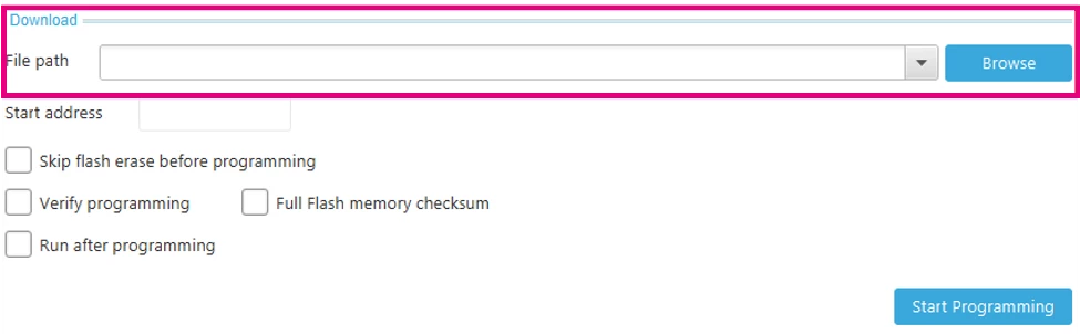

The device is in system boot:

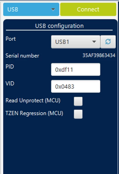

  1. Connect via the desired interface, in this case, USB is used:
    1. For DFU over USB: run a DFU tool (for example, CubeProgrammer in USB mode) and connect.

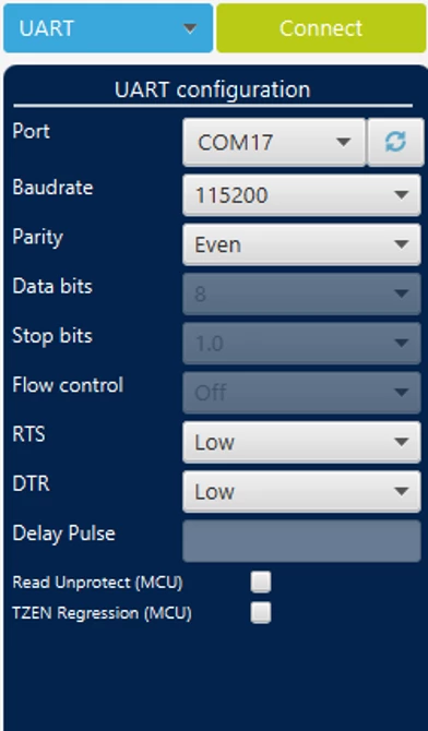

    1. For USART/SPI/FDCAN: use the corresponding host interface from CubeProgrammer or your own tool. It may be necessary to change the port and find the one that matches your Nucleo board.
  1. Perform the flash programming/erase/firmware update through the bootloader.
