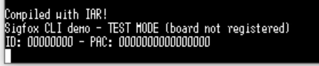

1. Build and flash Sigfox CLI project
- Open the STM32CubeWL3 software package.
- Navigate to:
Projects\NUCLEO-WL33CC\Applications\Sigfox\Sigfox_CLI. - Build the project using STM32CubeIDE or IAR.
- Flash the compiled binary to the NUCLEO-WL33CC board.
- Open the COM port connected to the board.
- Reset the board and verify the Sigfox CLI interface output.

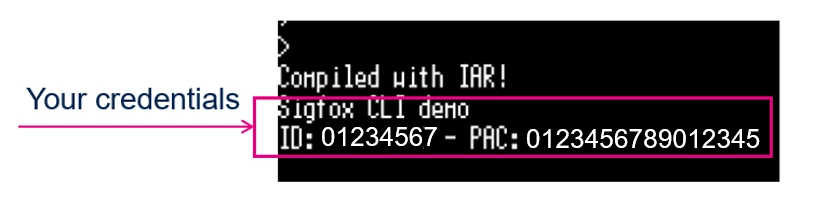

5. Verify the setup
- Open a serial terminal connected to the device.
- Confirm that the Sigfox credentials are loaded and the device is ready for Sigfox network communication:
