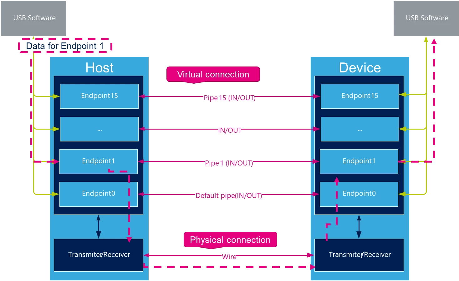

1. Understanding USB endpoints
USB endpoints are virtual communication channels between the host and the device. There are four primary types of endpoints.

2. How to determine the number of endpoints
To determine the number of endpoints required for your application, consider the following general guidelines based on the types of data transfers your application needs:
  • Control endpoint: Typically, only one control endpoint (endpoint 0) is required.
  • Bulk endpoints: Determine if you need separate endpoints for IN (device to host) and OUT (host to device) data transfers.
  • Interrupt endpoints: Identify how many interrupt endpoints are needed based on the number of time-sensitive data streams.
  • Isochronous endpoints: Determine the number of isochronous endpoints based on the number of continuous data streams.

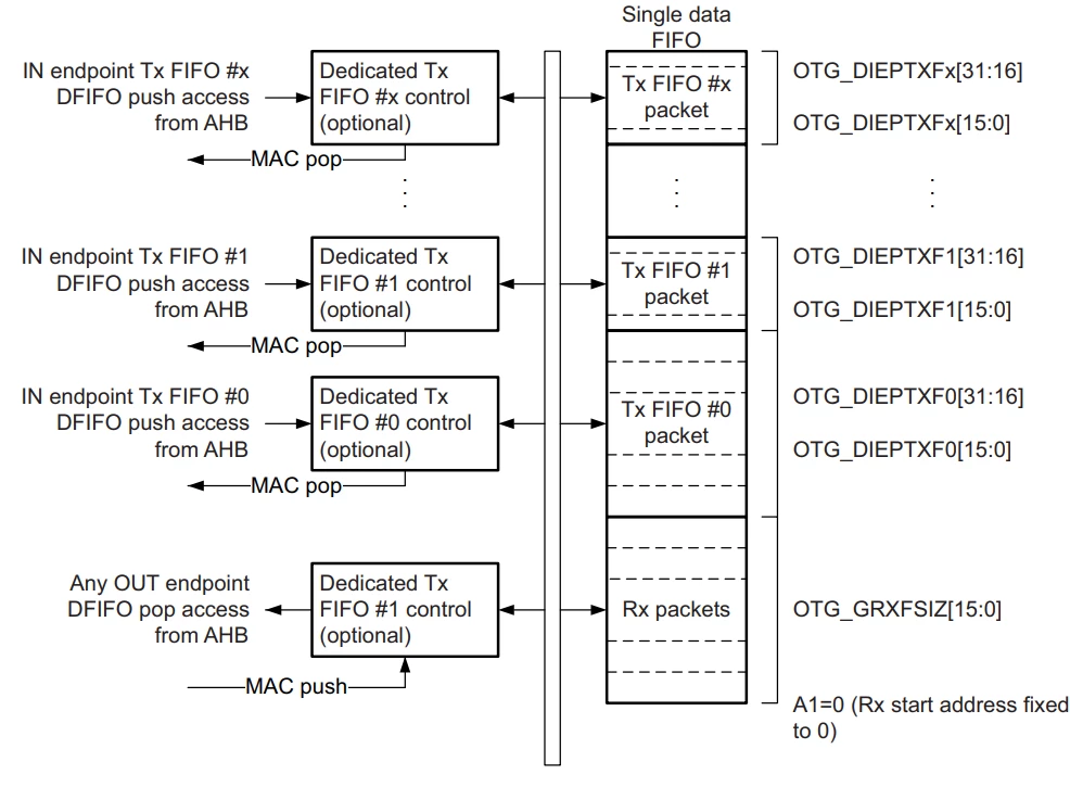

5. Explanation of FIFO operations in device mode in STM32 USB communication
Generally, FIFO sizes can be adjusted to optimize performance and reduce CPU overhead. For example, to handle more data and reduce the frequency of FIFO overflows, FIFO sizes should be larger in high speed mode. Also, bulk endpoints might require larger FIFOs to handle large data transfers efficiently compared to different types of endpoints.
Refer to the appropriate STM32 datasheet to check the size of dedicated FIFO SRAM. Furthermore, check if double buffer mode is supported, which would reduce the number of available endpoints. Here’s how USB FIFO is managed:
  • Rx FIFO: A single shared FIFO for all OUT endpoints, configured via OTG_GRXFSIZ. Efficiently handles incoming data, with status and data stored together. Generates interrupts when full or when data is available.
  • Tx FIFOs: Dedicated FIFOs for each IN endpoint, with sizes configured via specific registers (OTG_DIEPTXF0 and OTG_DIEPTXFx).
Proper management of FIFO sizes ensures efficient data transmission and reception without overflow. By configuring FIFO sizes appropriately, you can enhance the performance and reliability of your USB communication.
