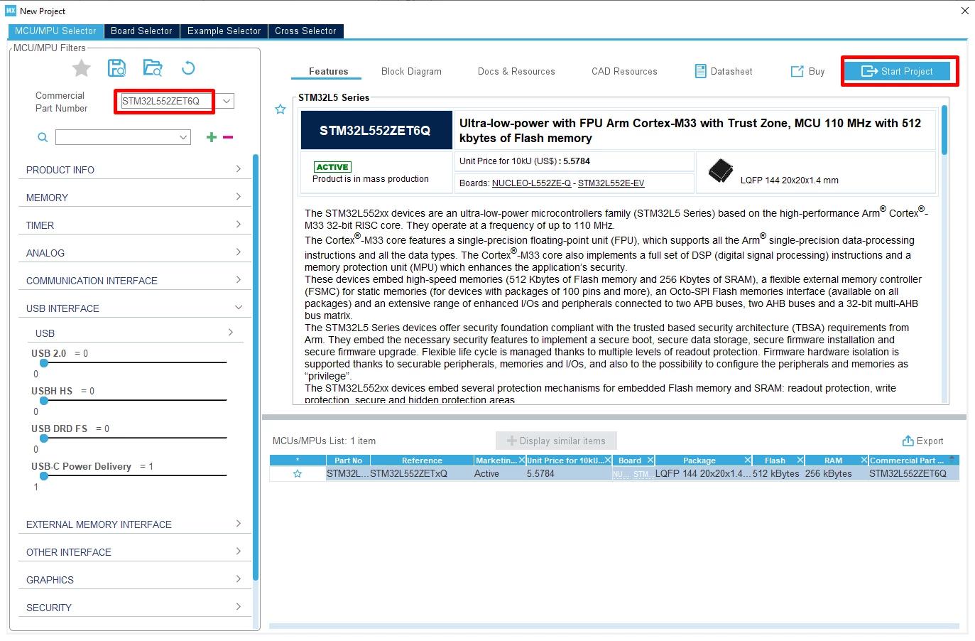

Let us start this demonstration by creating a new project for the STM32L552ZET6QU using STM32CubeMX and configuring the clocks, timer, and LPUART. Here are the steps to perform the initial configurations.
  • Open STM32CubeMX
  • Navigate to [File] -> [New Project]
  • Search for STM32L552ZET6Q and then click on [Start Project]
  • A pop-up appears for TrustZone activation, create the project with TrustZone deactivated to keep it simple

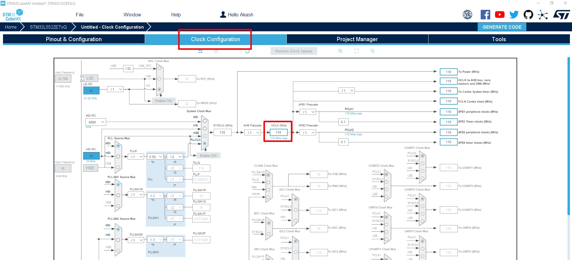

Next, let us configure the clock peripherals. Make sure that the core is running at the maximum frequency of 110MHz. This can be done by going into the [Clock Configuration] tab and entering 110 in the HCLK box. STM32CubeMX automatically calculates the values for the PLL multipliers and prescalars.
NOTE: Results (DMIPS/MHz) are linear with the clock frequency and hence it is not necessary to run the test at the maximum clock frequency. The DMIPS/MHz value is the same running the test at any clock frequency.

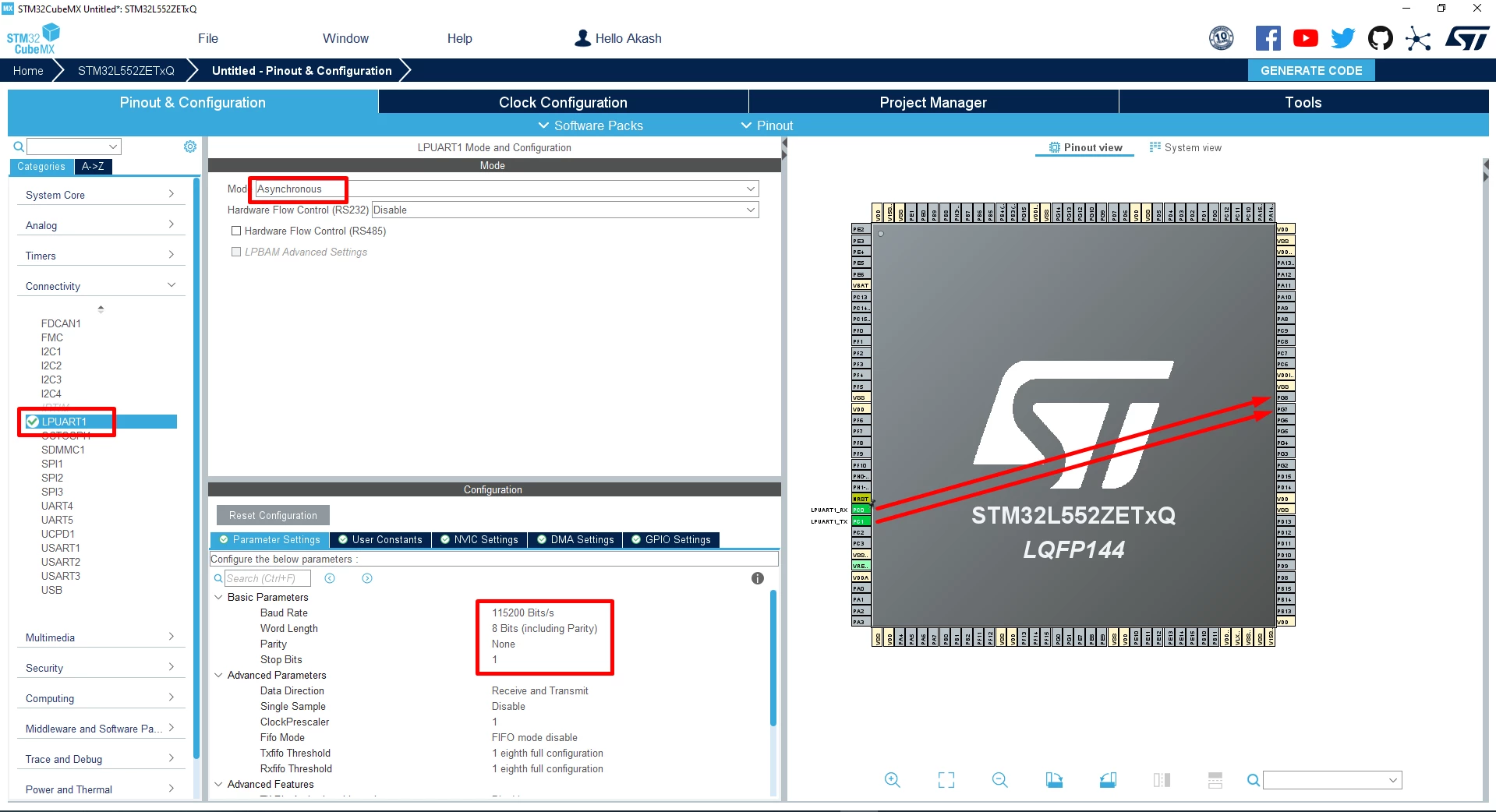

Back to [Pinout & Configuration], enable the LPUART1 under the the [Connectivity] menu. By default, LPUART1 (pins PG7/PG8) is connected to the STLINK Virtual COM port to print out the debug messages from the MCU to the PC.
The Virtual COM port settings are 115200 bps, 8-bit data, no parity, 1 stop bit, and no flow control. By default, LPUART1_RX and LPUART1_TX appears on PC0 and PC1 and they have to be redirected to PG8 and PG7.
Tip: There is a shortcut to do this by hovering the mouse pointer on the signal you want to move. Hold down CTRL + left mouse button and move it to the desired alternate function pin that blinks in black color.

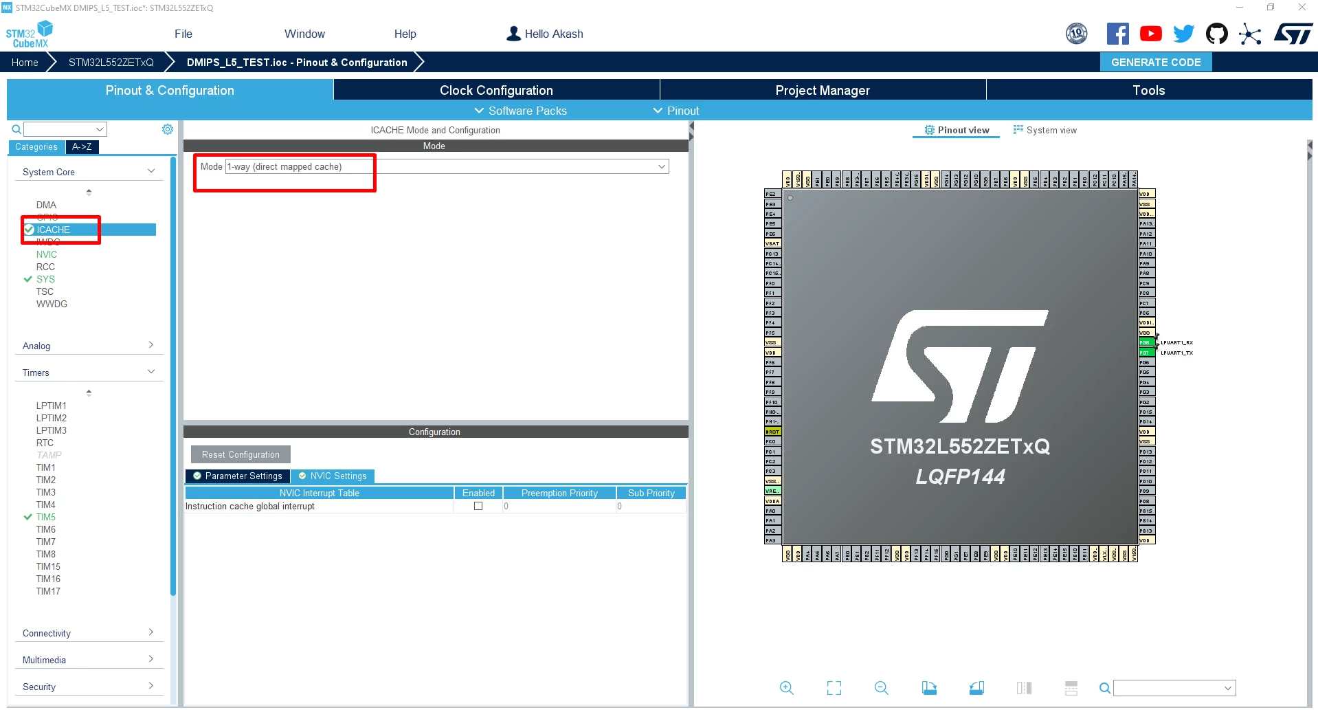

Enable the ICache under system core tab and choose a 1-way (direct mapped cache)

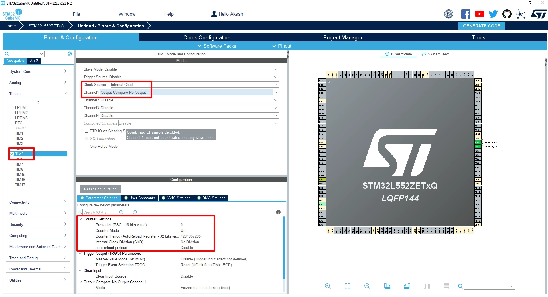

A timer peripheral can be used for the calculation of the DMIPS score. Alternatively, we can use the SysTick timer or the DWT (Data watchpoint and trace) as well; all of these implementations are discussed in this article.
Enable a timer under the [Timers] tab and select TIM5 (can choose any other 32-bit timer as well). Change the clock source to [Internal Clock] and Channel1 to [Output Compare No Output] and continue with the default parameter settings.

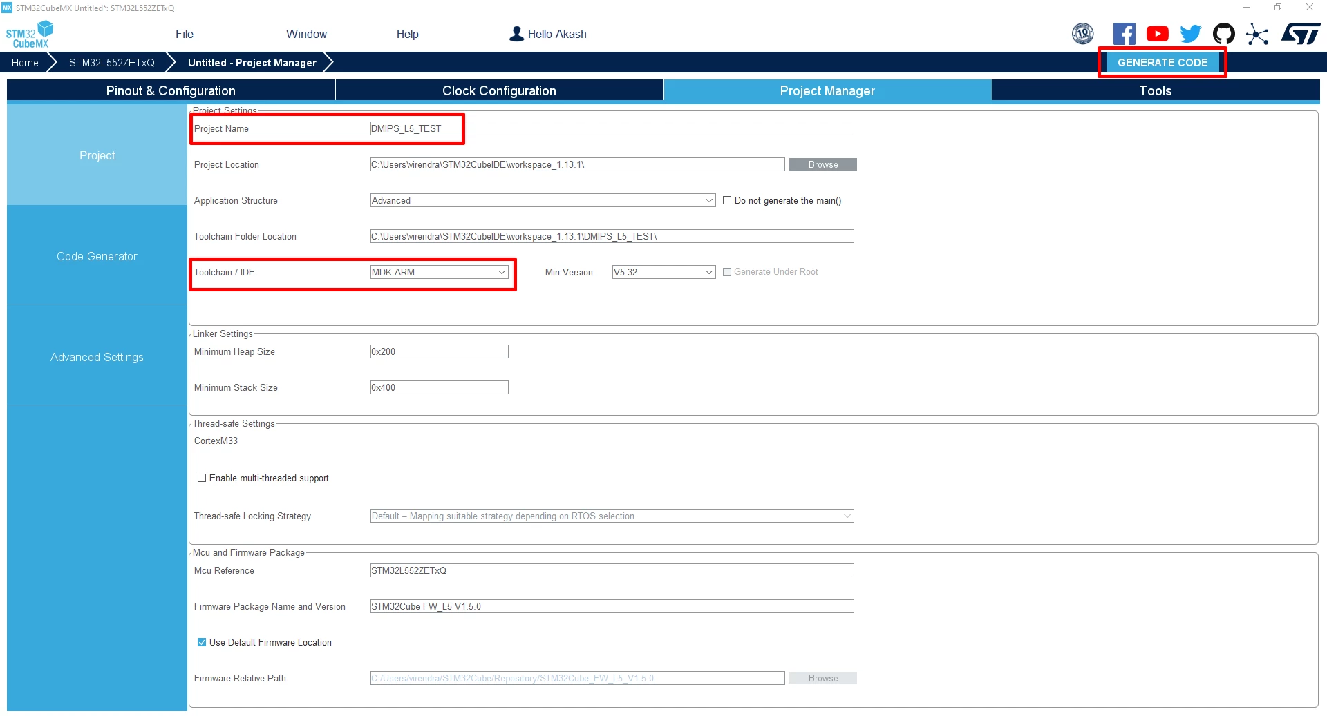

Go to the [Project Manager] tab and choose a name for the project and change the Toolchain/ IDE to MDK-ARM and finally click on [Generate Code].
After clicking on generate code, click on [Open Project] and the Keil® IDE should open.

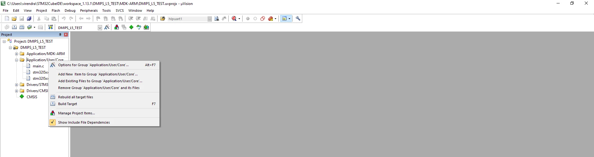

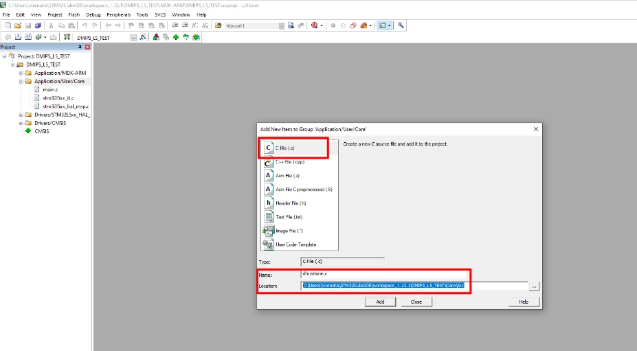

Now, you have to create 3 files dhrystone.c, dhrystone2.c and dhrystone.h
You can add new files to the project as follows:
  • Right-click Application/User/Core and choose [Add new item to group Application/User/Core]
  • Click on the .c file and enter the name (dhrystone.c) of the file and make sure that you place the files in the right folders
  •  .c files are present in Project_name\Core\Src folder and .h files are present in Project_name\Core\Inc folder
  • Repeat the same steps to create the dhrystone2.c and dhrystone.h (Make sure you select Header File .h) files.

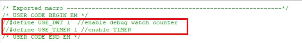

//#define USE_DWT 1 //enable debug watch counter
//#define USE_TIMER 1 //enable TIMER

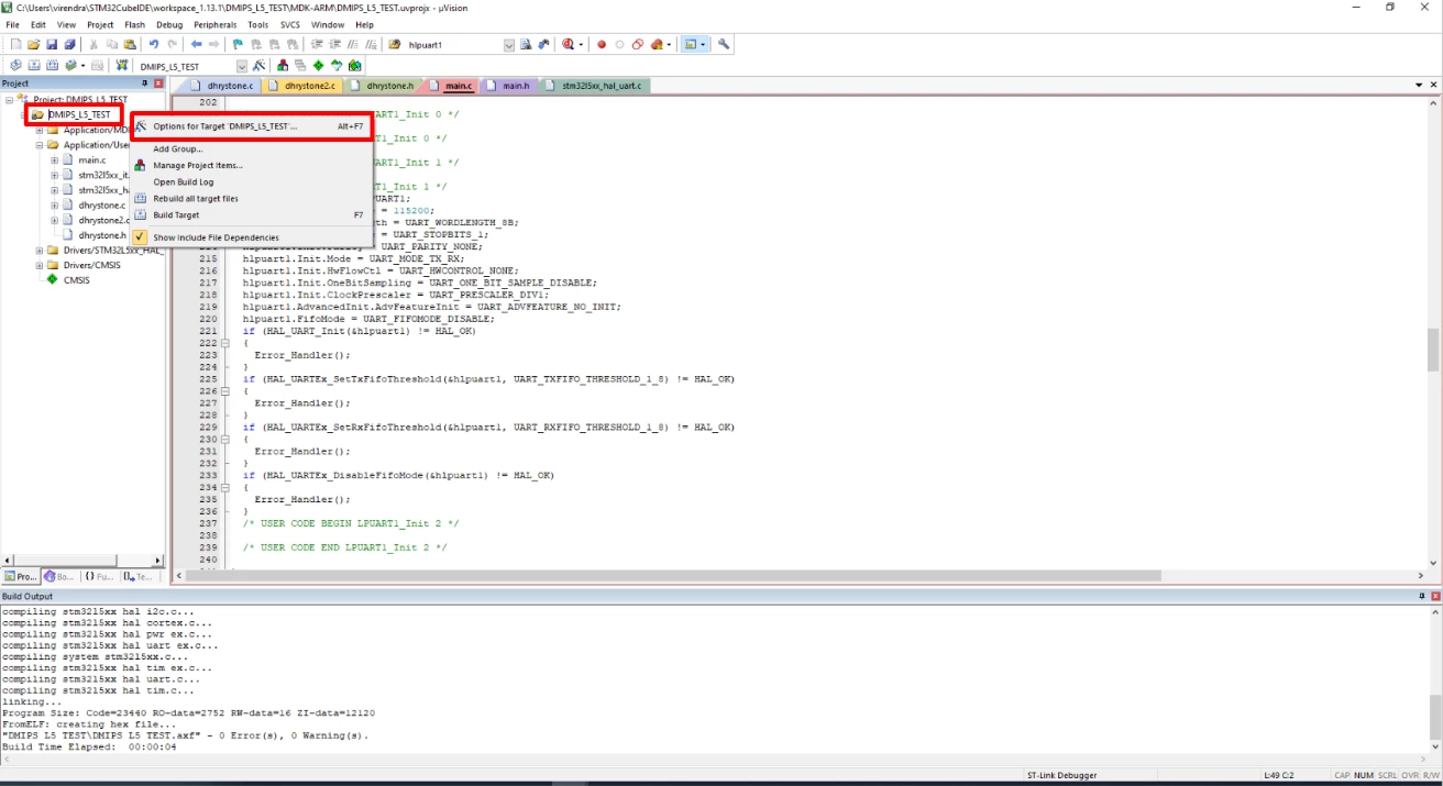

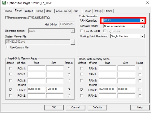

Make sure that the NUCLEO-L552ZE-Q_BSP and STM32L5xx_DFP packs are installed and up to date. We use version 6.21 of the compiler. You can add and use older compiler versions by following this documentation.
Right click on the project name and select [Options for Target DMIPS_L5_TEST]
Make sure you have chosen the right compiler version under the tab [Target].

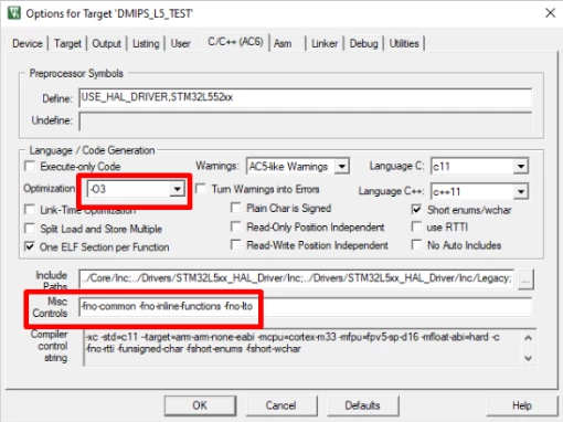

Under the tab [C/C++ (AC6], configure the [Optimization] level to -O3 under the tab and add this line in the [Misc Controls] box to disable inlining of functions.
           -fno-common -fno-inline-functions -fno-lto

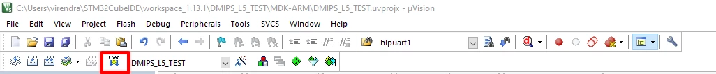

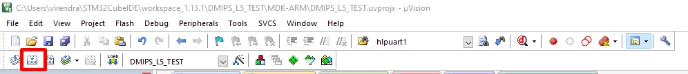

Compile the project by using the shortcut key F7 or clicking on the option shown below. The project should compile with no errors and warnings.
3. Methods to calculate the execution time
You can calculate the Dhrystone timings using three methods:
  1. SysTick timer
  2. 32-bit internal timer
  3. Data watchpoint and trace (DWT) unit
By default, the program uses the SysTick timer to calculate the timing. You can change this by uncommenting the required macro in the main.h file.
  • Remember that DWT control only works when the microcontroller is run in the debugger mode
If you are using the debug counter or the timer peripherals, take care that the counter register does not overflow. No overflow mechanism is implemented. Keep the number of runs variable at a reasonable value. We can implement the overflow mechanism of timers by using interrupts. Let us make it simple here, as HAL functions take a considerable number of clock cycles when an interrupt gets triggered, which might have an impact on the result.
  • Use a 32-bit timer that runs at HCLK clock frequency
4. Results

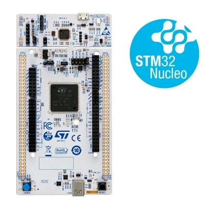

Connect your board to the PC using a USB cable. Load the binary file by using the shortcut key F8 or clicking on the button shown below. The programming should be completed without any errors.

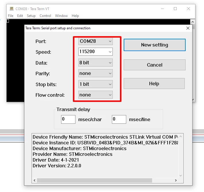

Open Tera Term and choose the right COM port that your board is connected to. Check the [Device Manager] control panel under Ports if using a Windows machine, and then press OK.
The COM port terminal opens and now you have to make sure the serial port settings are correct.
Verify this by selecting [Setup] -> [Serial Port] -> verify the settings with the image below.

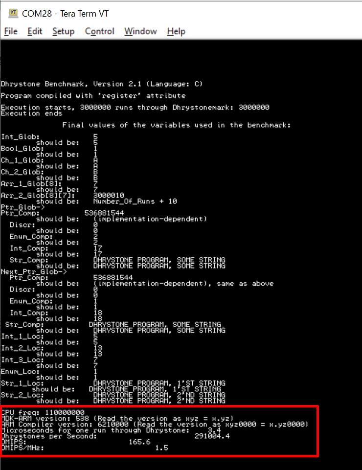

Now, reset the board by pushing the black reset button on the board. You should see a text prompt in the Tera Term terminal window asking you to select the number of runs.
We choose the value 3000000 and then press enter. Now, the execution starts and takes some time to display the results.
As you can see, we have obtained a DMIPS value of 165.6(~165) which is the same as the value specified on the ST website for this MCU.
