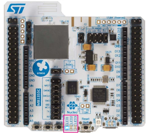

To test and verify that everything is working as expected, the STBLESensor app can be used and easily connected to the board.

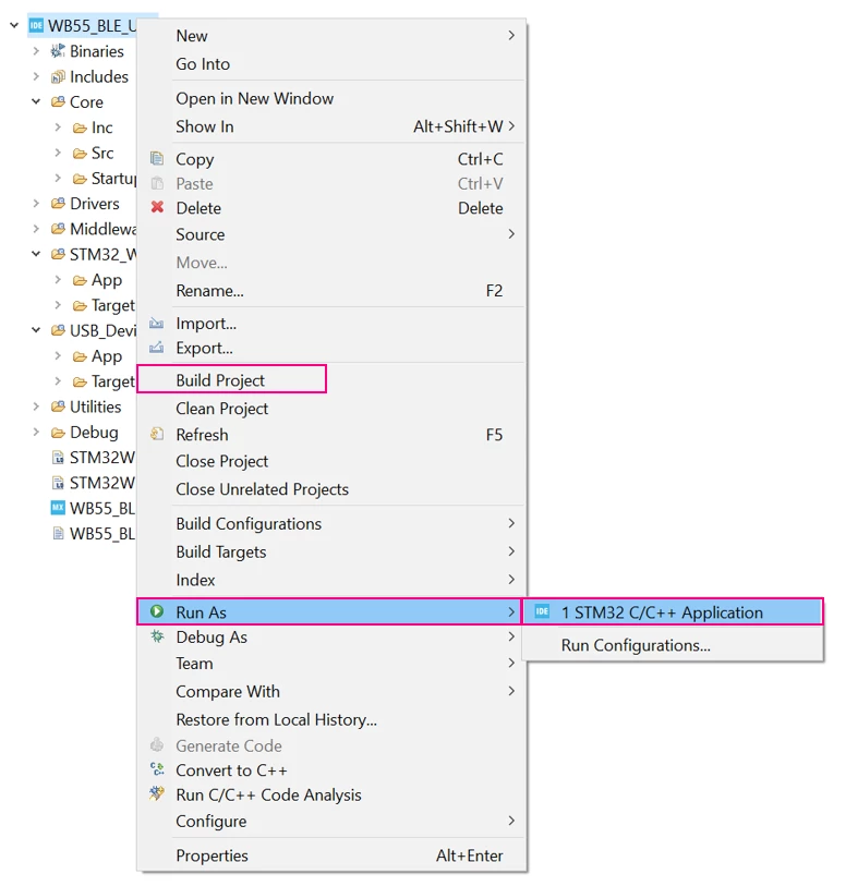

Build the code, check errors and warnings, and run it:

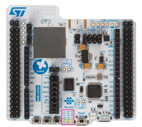

The Green LED must blink, advertising that it is ready to connect.

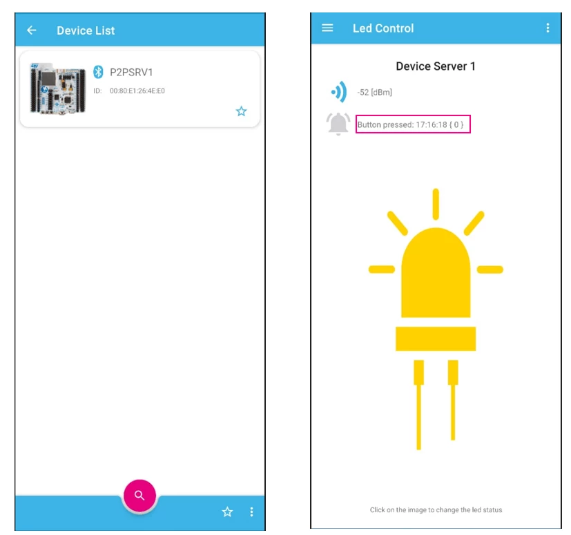

Open the Bluetooth® Low Energy sensor app and you already can see the board available to connection.
Clicking on the image changes the LED status and you can see that the Blue LED switched on.
Pressing the user button SW1, the message “Button pressed” will appear in the app.
