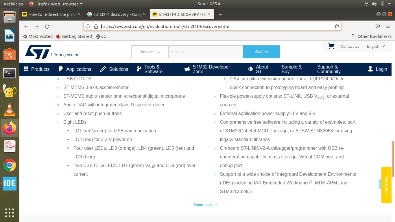

AMuth.3
October 22, 2022
Can I configure the USART in an already created/existing project and generate code as said in this article? If so how to do in STM32F4 Discovery board?
ST AME Support NF
October 22, 2022
The ST-LINK in STM32F4 Discovery supports only SWD and not Virtual COM port.
BR
Nico.
AMuth.3
October 23, 2022
_legacyfs_online_stmicro_images_0693W00000UoafAQAR.pngBut in the product link as given below
https://www.st.com/en/evaluation-tools/stm32f4discovery.html
It is showing as Virtual COM port is supported..
Please look that and confirm.
And what is SWD. Please explain.
ST AME Support NF
October 23, 2022
OK I see, there are 2 models for the STM32F4 Disco, if you are sure yours support virtual com port then yes you can use it. check what UART and I/Os form the STM32F4 are connected to RX and TX of the ST-LINK and use those when configuring your project.
ST AME Support NF
October 23, 2022
please refer to the user manual and schematics to see what IOs are connected the ST-LINK on your discovery kit.
