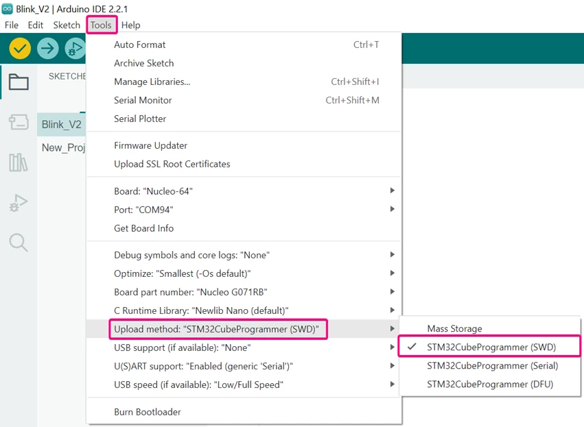

3.3 Uploading the code
Let us start programming our STM32 device with a simple Blink LED through the Arduino’s IDE.
To perform this task, we have a few options.
These options include programming the STM32 MCU through the Serial Wire Debug, using an STLINK device (external or embedded), and also through bootloader serial port, DFU etc.
Let us see below how to program our STM32 MCU using Arduino’s IDE to get it working properly as expected:
Having the STM32CubeProgrammer installed helps program the STM32 Nucleo, Discovery or Eval board through SWD, Serial or DFU methods with ease. The STM32CubeProgrammer enables drag-and-drop flash programming, so there is no need for a separate debug probe. However, this step is optional and you can program directly via Arduino's IDE as well.

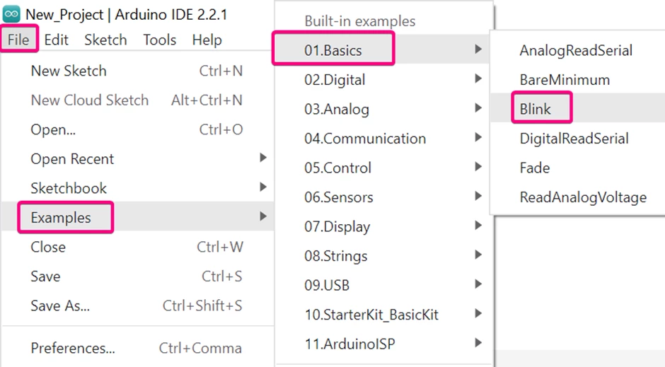

After installing the software and the STM32 cores, go to File > Examples > Basics > Blink:
The Blink LED code pops up in a new window and we can now set the appropriate STM32 board.
After selecting the board type, as we previously made, click again on Tools > Board Part Number > Select the used STM32 device part number:
With the microcontroller correctly selected and the board properly connected, let us define the COM Port where the device is connected. Go to Tools > Ports > Select the Port Number:
Click the Upload Button, wait for the code to be compiled and the board to be programmed:

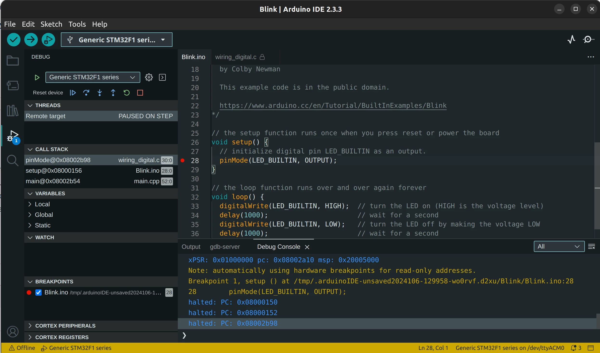

4. Debugging the STM32 over Arduino's IDE
To start a debug session in the Arduino’s IDE, click on Tools > Upload Method > “Serial Wire Debug” option, as follows:
After that, click on the “Verify” symbol to compile the code and then on the “Start Debugging” button.
The perspective changes to the Debug Perspective, as follows:
And with all that set, the debug session is up and running!

I'm using an STlinkV2 programmer with an STM32F103C8T6 minimum system development board. While the Arduino IDE (version 2.1.0) recognizes the STlink and allows me to program the board, I encounter an issue when trying to debug. When I click the debug button, I receive the error message: "Request 2 cancelled on connection close." Could you please take a look and let me know what might be causing this issue? Thank you!
Nov 6, 2024 4:09 PM UTC
@BaiBai
You should use latest Arduino IDE 2 version and use latest STM32 core 2.8.x.
Then enable the "Optimize for Debugging" in the "Sketch" menu.
After "upload", click on "Start Debugging" button and it should work.
