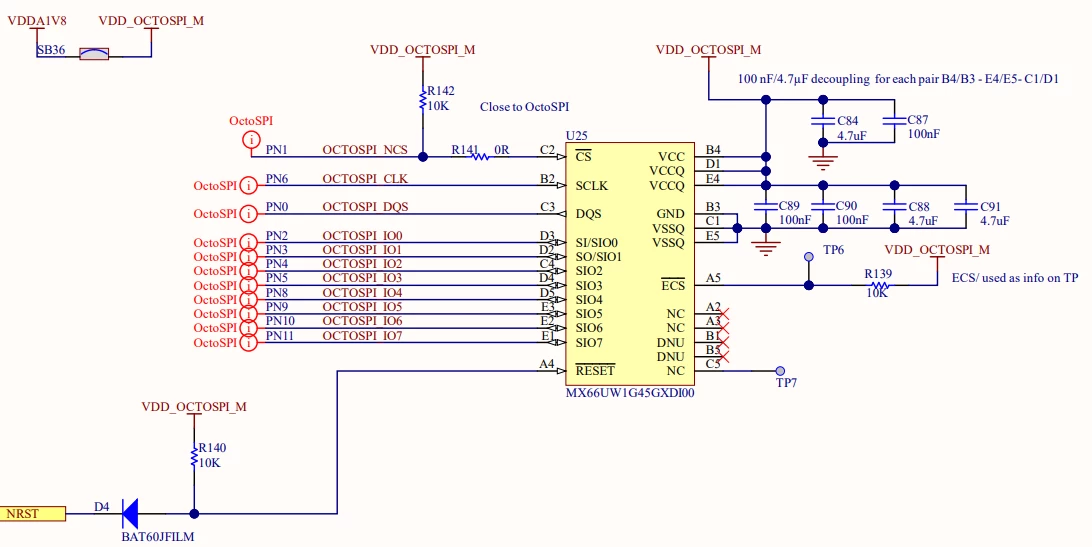

1. Hardware considerations
The IS25LXWX01G and MX66UW1G45G memories are pin-to-pin compatible, and both operate at 1.8 V, making it straightforward to swap the memories.
The extended serial peripheral interface (XSPI) has 16 I/O data lines and supports single, dual, quad-SPI, octo-SPI, and 16-bit memories so that a wide range of external memory types can be used. The STM32N6570-DK board is configured to use octal mode, where eight data lines (IO0 through IO7) are connected to the external memory, as illustrated below:
Impedance for the high-speed signals between the microcontroller and memory device is important for reliability and should be adjusted based on implementation. This topic is beyond the scope of this article.

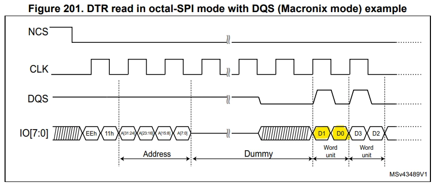

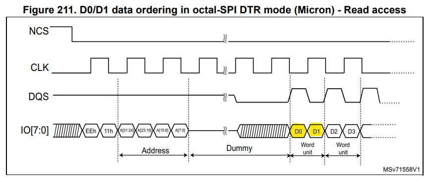

The XSPI section in the reference manual (RM0486) shows the different types of memory supported and configured using bitfield MTYP[2:0] in the XSPI_DCR1 register. Data ordering is of particular importance when configuring the interface:
  • D0/D1 data ordering: In this configuration, Data 0 is output first, followed by Data 1, as illustrated below. In this case, the DQS signal polarity is opposite to the clock. AMEMCUSupportCenterBB_27-1766172023576.png
  • D1/D0 data ordering: In this configuration, Data 1 is output first, followed by Data 0, as illustrated below. In this case, the DQS signal polarity matches the clock. AMEMCUSupportCenterBB_29-1766172227843.png

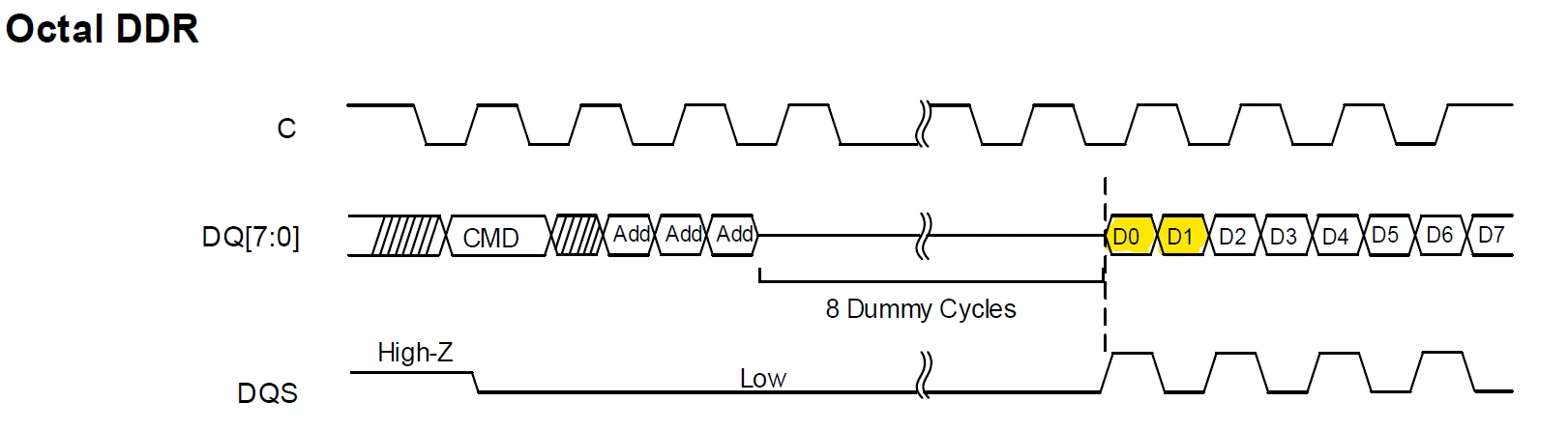

According to the IS25LXWX01G datasheet section READ MEMORY Operations Timings, the data is output in the order D0 followed by D1, and the DQS signal polarity is opposite to the clock, as shown below: excerpt from the IS25LXWX01G datasheet.
This indicates that the IS25LXWX01G is compatible with Micron mode, and the MTYP[2:0] bits in XSPI_DCR1 must be configured to 0b000: Micron Mode.

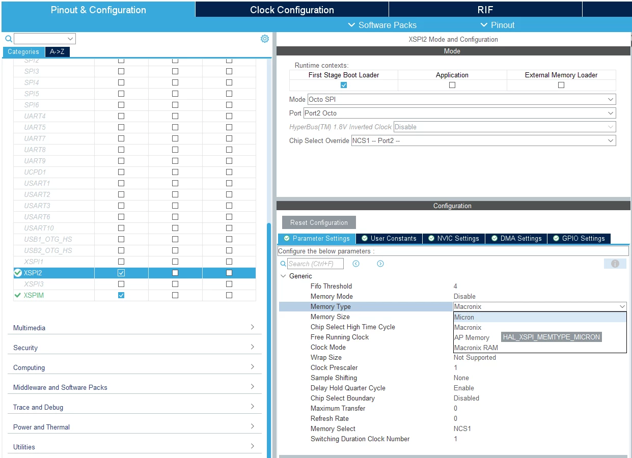

To implement this change, open STM32CubeMX and load XSPI_NOR_MemoryMapped_DTR.ioc available under:
STM32Cube_FW_N6_V1.3.0\Projects\STM32N6570-DK\Examples\XSPI\XSPI_NOR_MemoryMapped_DTR.
In XSPI2 in Connectivity category under Pinout & Configuration, then under Parameter Settings tab, change the memory type from Macronix to Micron, as shown below:
At this point, save the project and generate the code by clicking the [Generate Code] button located in the top-right corner.

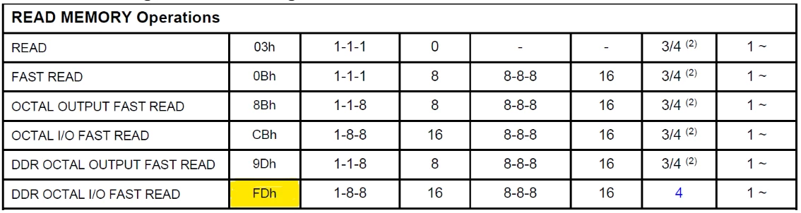

Based on the excerpt below from IS25LXWX01G datasheet Table 8.1 Command Set, the memory supports many read commands. For best performance, we want to use one that supports octal mode and Double Data Rate (DDR) which is the same as Double Transfer Rate (DTR).

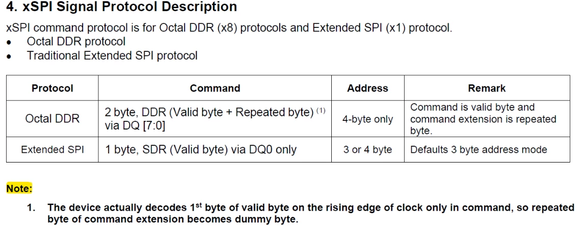

The two commands that satisfy the two requirements are DDR OCTAL OUTPUT FAST READ (9Dh) and DDR OCTAL I/O FAST READ (FDh). Using the command DDR OCTAL I/O FAST READ (FDh) has the advantage of not requiring to switch from 3-byte address mode to 4-byte address mode.  Later in this article I show how to switch the addressing mode even though we are enabling the Octal DTR mode with the command E7h.
Additionally, the memory datasheet in section xSPI Signal Protocol Description specifies in octal DDR mode that the memory decodes the first byte of a valid command on the rising edge of the clock only during the command phase. Therefore, the repeated byte of the command extension becomes a dummy byte as shown by the screenshot below. This means that we can define the command OCTAL_IO_DTR_READ_CMD as FDFDh: the 8-bit MSB is decoded while the 8-bit LSB (repeated) is dummy. Some memory vendors have the pattern of command as cmd+inverted (case of Macronix)
Update the command in main.h as follows:
#define OCTAL_IO_DTR_READ_CMD 0xFDFD
Follow the same process for the other commands: octal page program, octal read status register, octal sector erase, octal write enable, and write to the volatile configuration register based on Table 8.1 Command Set in the memory datasheet:

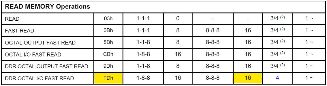

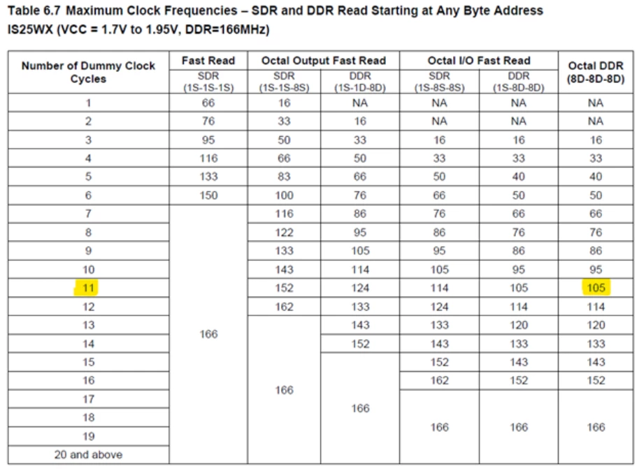

Dummy cycles are additional clock cycles inserted during read operations from serial NOR flash memory (for example, SPI NOR flash) to allow the memory device sufficient time to respond. The number of dummy cycles varies depending on whether the operation involves data access or register access.

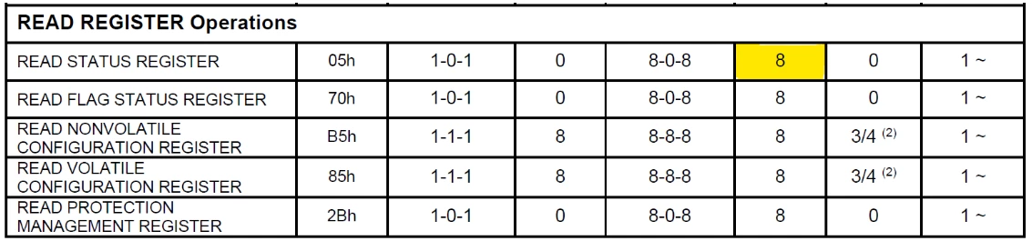

For register read access, 8 clock cycles are required, as shown in the excerpt from the memory datasheet Table 8.1 Command Set.
 For data read access, the default requirement is 16 clock cycles, as shown in the excerpt from the memory datasheet Table 8.1 Command Set.
However, it is recommended to adjust the dummy cycles based on the XSPI clock frequency. In this example, the XSPI clock frequency is 100 MHz, so the appropriate dummy cycles configuration is 11. Table 6.7 of the memory datasheet shows the number of dummy clock cycles per operating clock frequency.

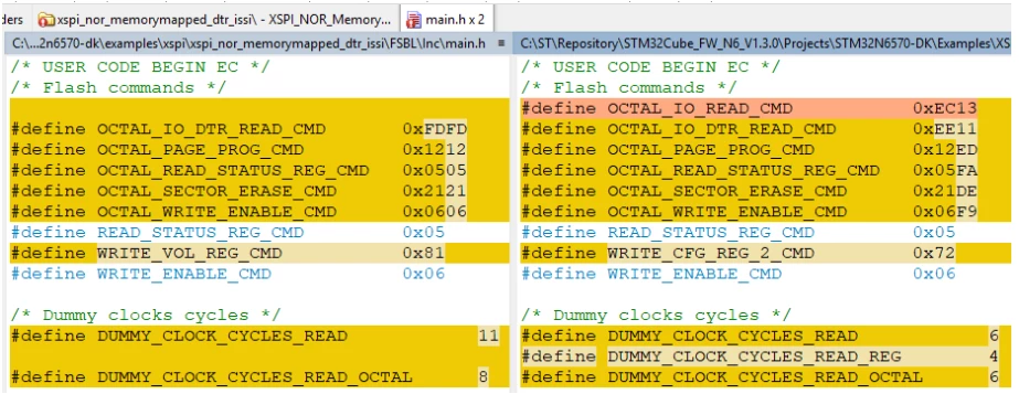

The changes regarding the dummy cycles for both register and data read are as follows:
#define DUMMY_CLOCK_CYCLES_READ 11 // Has to match the dummy cycles setup in the configuration register
#define DUMMY_CLOCK_CYCLES_READ_OCTAL 8
The screenshot below illustrates all the changes in main.h. The left-hand side shows the modified code and the right-hand side shows the original code.
Note that OCTAL_IO_READ_CMD and WRITE_CFG_REG_2_CMD are removed:
  • OCTAL_IO_READ_CMD is not utilized in the original example.
  • WRITE_CFG_REG_2_CMD is not applicable to ISSI memory as only one configuration register is available and the different features (for example, dummy cycles) are mapped to different addresses.

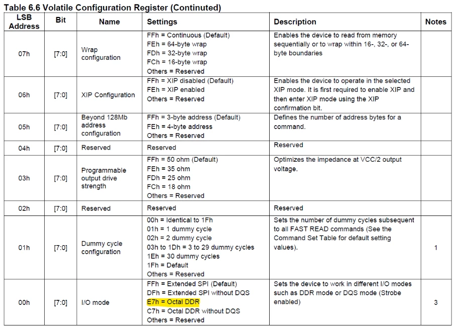

As discussed earlier, it is recommended to setup the dummy cycles configuration to 11 in this particular example where the XSPI clock frequency is 100MHz. For the IS25LXWX01G memory, the sequence is as follows:
  1. Send write enable (instruction = 0x06) to allow access to the volatile configuration register. The volatile configuration register is write-protected by default. The Write Enable command (0x06) must be issued first to set the Write Enable Latch (WEL) bit, allowing subsequent modification of the configuration register. The 0x06 instruction uses the 1-0-0 format with 0 dummy cycles, meaning instruction is required and no address and no data are required, as shown in the code snippet below.
  2. Write 11 to the volatile configuration register (instruction = 0x81) at address 0x00000001 as shown by the code below. The Volatile Configuration Register Write command (0x81) is used to update the register at address 0x01, which controls the number of dummy cycles for read operations. The 0x81 instruction uses the 1-1-1 format with 0 dummy cycles meaning instruction a 3-byte address (default 24 bits), and 1 byte of data. Therefore, the address width is set to 24 bits and the data length to 1, as shown in the code below.

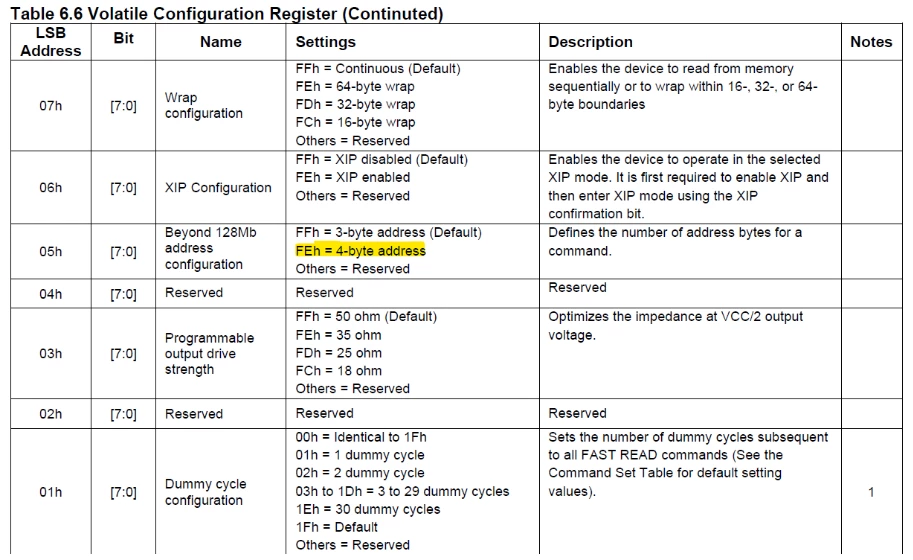

The default memory address range is limited to 24 bits, which means only the first 128 Mb are accessible. To access the full memory content (1 Gb with IS25LXWX01G), it is necessary to enable the 4-byte address mode. To achieve this, perform the following steps:
  1. Send a write enable command (instruction: 0x06) to allow access to the volatile configuration register.
  2. Write 0xFE to the volatile configuration register (instruction: 0x81) at address 0x05, as illustrated below.
This step is not mandatory. Once the device is configured to Octal DDR mode in the next step, it will be fixed to 4-byte address mode. This is regardless of the register configuration at address 0x05, whether set to 0xff or 0xfe.

To enable the Octal Double Transfer Rate (DTR) mode, a specific command must be sent to the memory using the XSPI_NOR_OctalDTRModeCfg() function.
  1. Send write enable (instruction = 0x06) allowing access to the volatile configuration register. The 0x06 instruction uses the 1-0-0 format (one I/O line for the command, no address, or data) and 0 dummy cycles.
  2. Write 0xE7 to the volatile configuration register (instruction = 0x81) at address 0x00, as shown below.  The 0x81 instruction uses the 1-1-1 format (one I/O line for command, address, and data), 0 dummy cycles, a 4-byte address (default 24 bits and changed in previous step to 32 bits, here set to 0x00), and 1 byte of data (0xE7).
