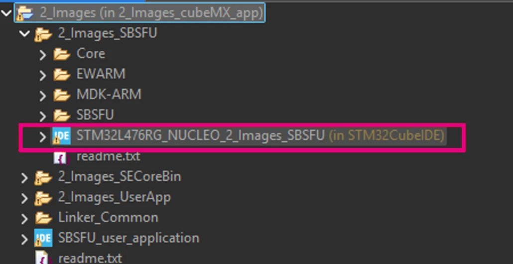

1. User application configuration
We are using the 2_images example and the NUCLEO-L476 board:
x-cube-sbsfu-v2-8-0/STM32CubeExpansion_SBSFU_V2.8.0/Projects/NUCLEO-L476RG/Applications/2_Images
- Copy the user application SBSFU_user_application to the 2_images folder.

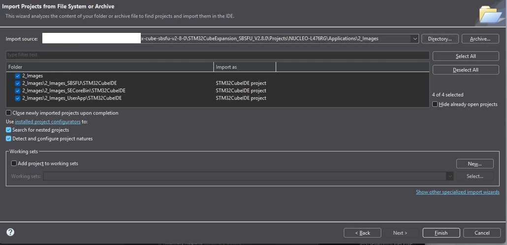

- Import the project to STM3232CubeIDE: Go to
File -> STM32 Project Create/Import -> STM32CubeMX/STM32CubeIDE Project -> Next - Copy the project path: x-cube-sbsfu-v2-8-0/STM32CubeExpansion_SBSFU_V2.8.0/Projects/NUCLEO-L476RG/Applications/2_Images

To build or flash the project, there is a specific process to follow.
Right-click on the STM32CubeIDE icon as highlighted in the image above, then select Build project:
- First, build the 2_images_SECoreBin project.
- Then, build the 2_images_SBSFU project.
- Flash the SBSFU.elf file using STM32CubeIDE.
- Build the user application. This generates a UserApp.sfb file under 2_images_UserApp/Binary.
- Then, using Tera Term, upload the user application to the device.
To build or flash the project, click on the STM32CubeIDE project highlighted by the red rectangle in the image before performing the corresponding step.

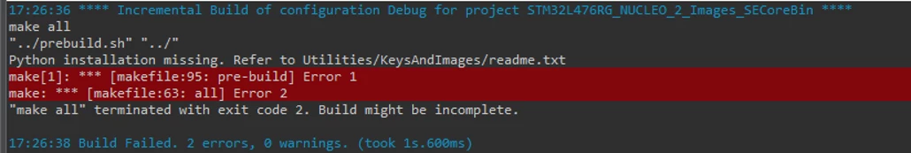

#define SECBOOT_DISABLE_SECURITYSBSFU requires installing Python packages on the system, go to:
x-cube-sbsfu-v2-8-0/STM32CubeExpansion_SBSFU_V2.8.0/Middlewares/ST/STM32_Secure_Engine/Utilities/KeysAndImages
In PowerShell, run:
pip3 install -r requirements.txt.3. User application compiler configuration

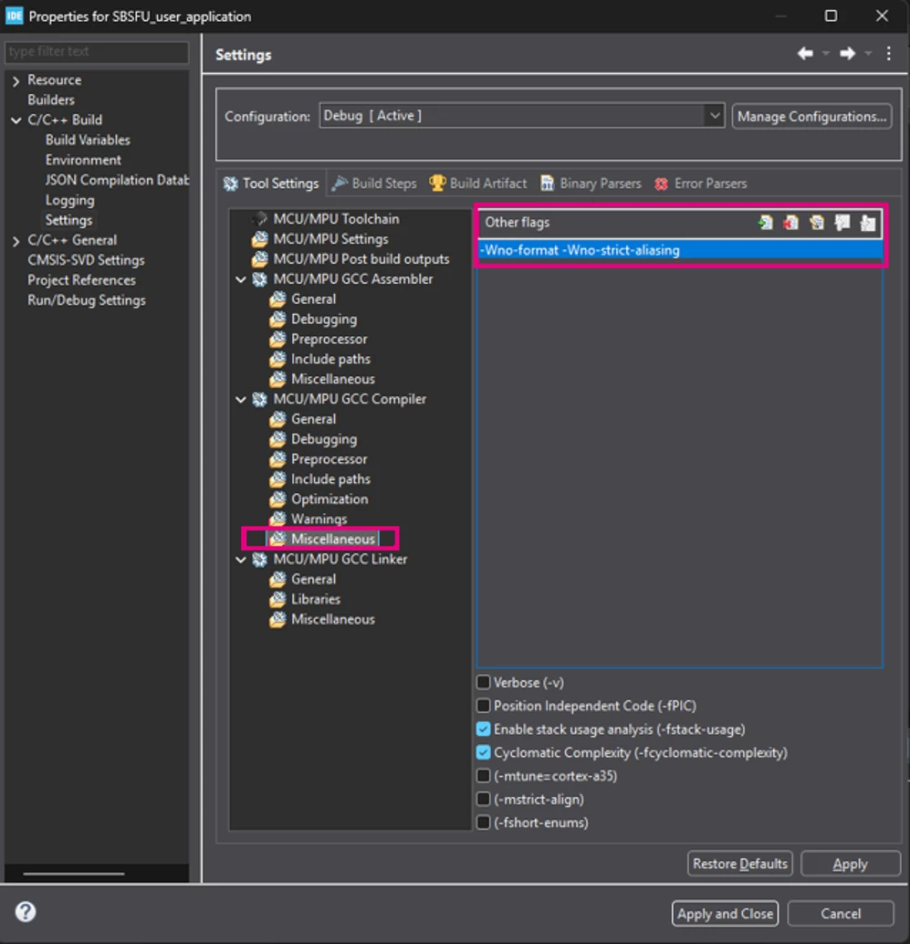

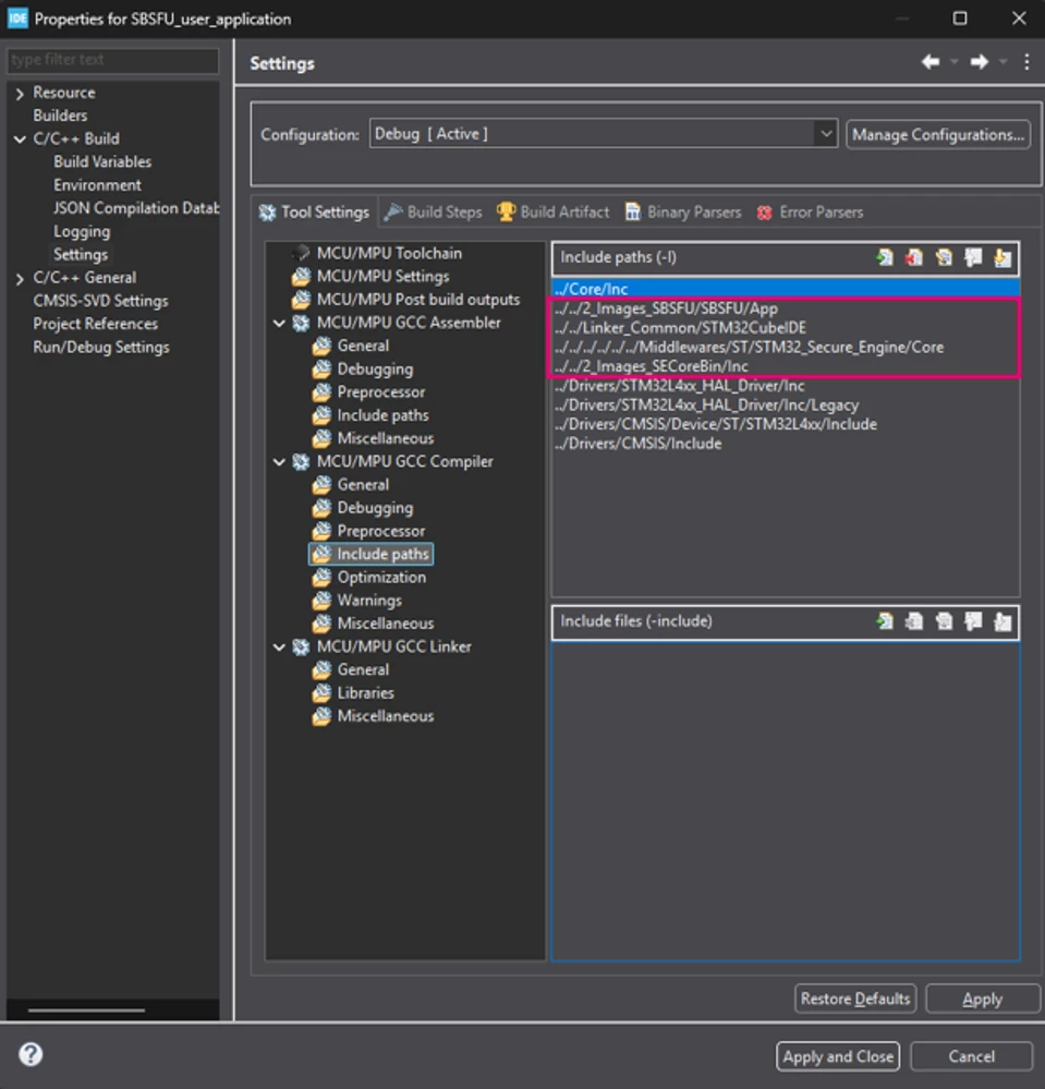

- We need to configure the include-paths for the SBSFU_user_application, go to properties ->C/C++ build -> settings -> MCU GCC compiler -> include paths and add these paths:
- ../../../2_Images_SBSFU/SBSFU/App
- ../../../Linker_Common/STM32CubeIDE
- ../../../2_Images_SECoreBin/Inc
- ../../../../../../../Middlewares/ST/STM32_Secure_Engine/Core
- In MCU GCC compiler -> Miscellaneous -> Other flags, add: -Wno-format -Wno-strict-aliasing

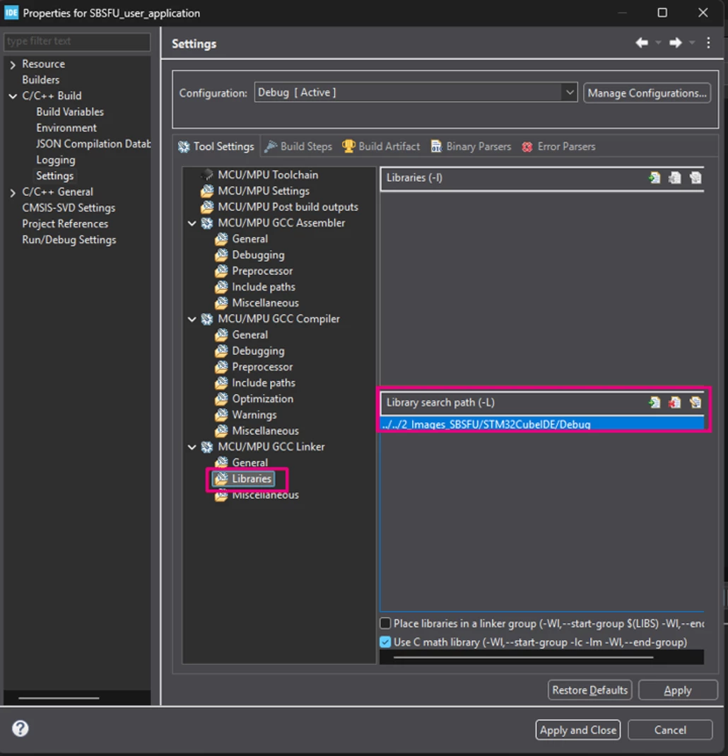

- Go to MCU GCC Linker -> library -> Library search path and add this path:
../../../2_Images_SBSFU/STM32CubeIDE/Debug
This is needed for the SBSFU to detect the secure interface linker file se_interface_app.ld generated by the postbuild.sh script.

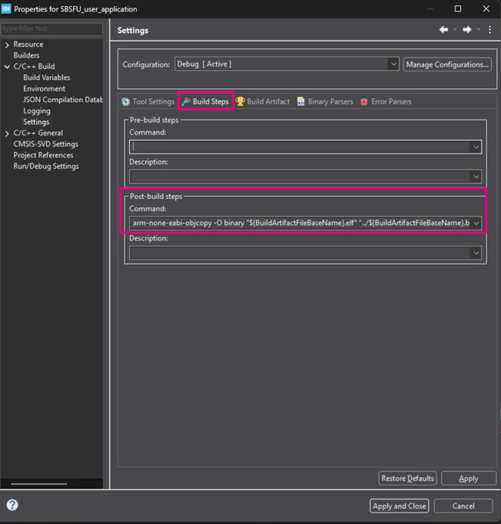

Finally, we add a post build command to generate the .sfb file used for firmware update. In the same window while it is still open go to the Build steps tab. In the Post-Build steps area, add the following command:
arm-none-eabi-objcopy -O binary "${BuildArtifactFileBaseName}.elf" "../${BuildArtifactFileBaseName}.bin" && arm-none-eabi-size "${BuildArtifactFileName}" && "../../2_Images_SECoreBin/STM32CubeIDE/postbuild.sh" "./" "${BuildArtifactFileBaseName}.elf" "../${BuildArtifactFileBaseName}.bin" "1" "1"
- Click apply and close.

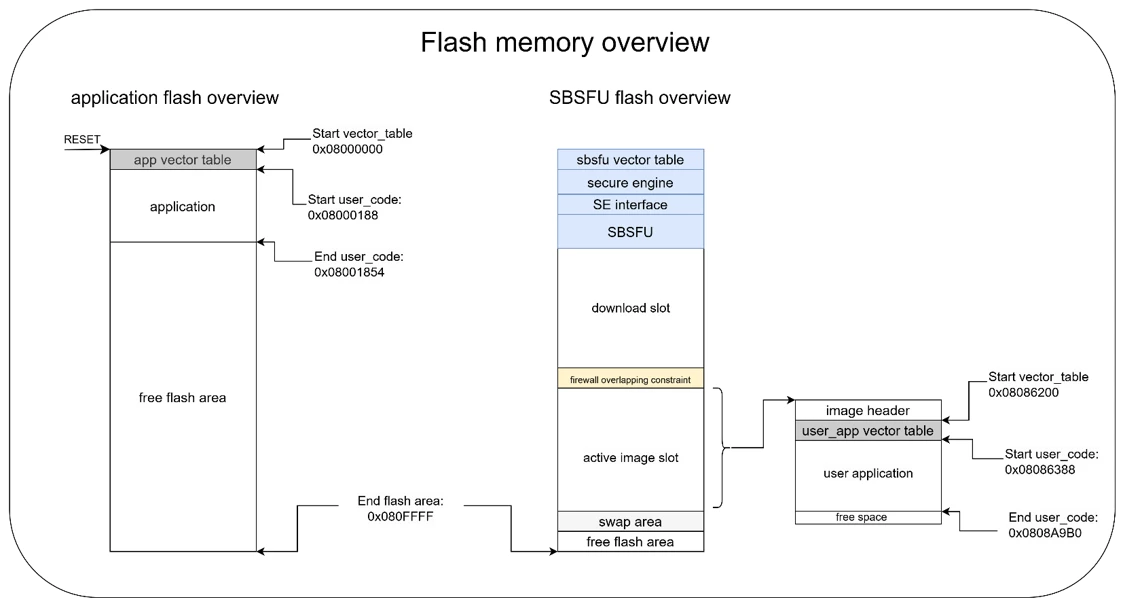

4. Flash memory adaptation
The user application must be linked to and executed from the SBSFU application slot rather than from the default 0x08000000 address. In this article, the SBSFU example application is used as a reference (2_images/UserApp).
Its linker script is used as a template. The relevant memory regions, vector table location, application sections, and RAM/stack configuration are adapted to the STM32CubeMX generated application.
We copy the content of 2_images/UserApp/STM32CubeIDE/STM32L476RGTx.ld into the linker script of the STM32CubeMX generated application.

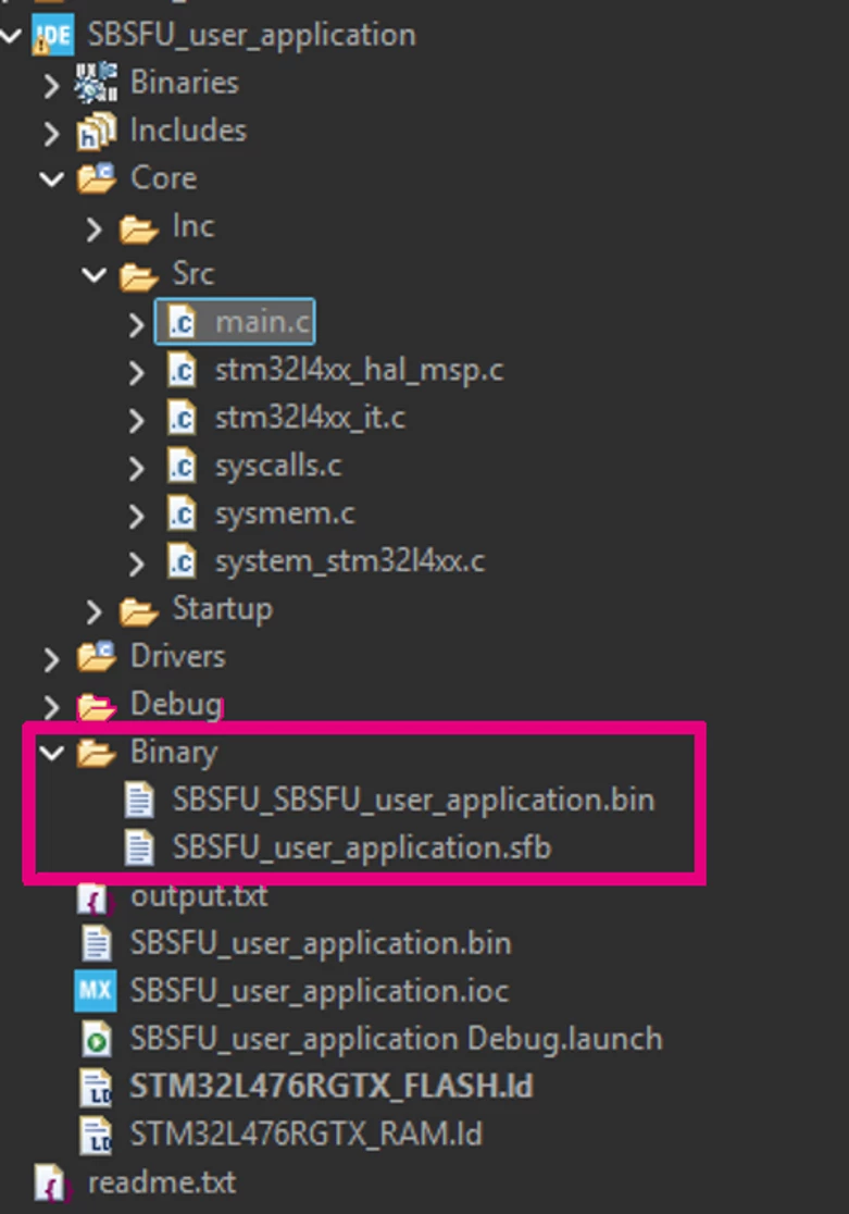

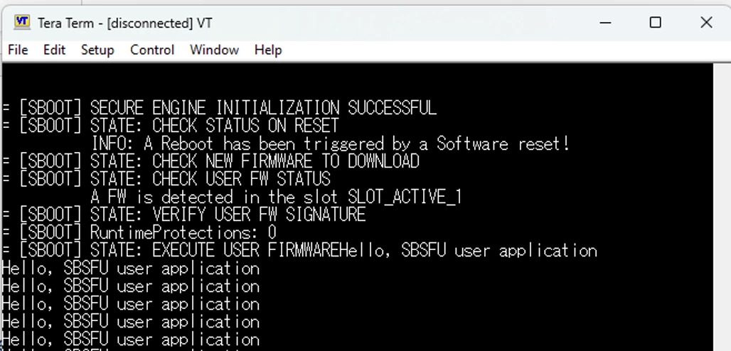

6. Testing the user application
- Build the SBSFU_user_application
The build process generates SBSFU_user_application.sfb under SBSFU_user_application/Binary directory.
- Flash the Nucleo-L476 with SBSFU project
- Using Tera Term, perform the firmware update via Ymodem.
Note: when pressing the blue button on the STM32 during boot the secure bootloader will enter firmware update mode.
For more information about firmware update using TeraTerm, refer to SBSFU getting started user manual section 8.4.2 Send the first firmware.

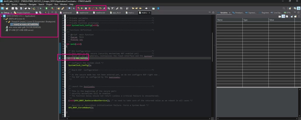

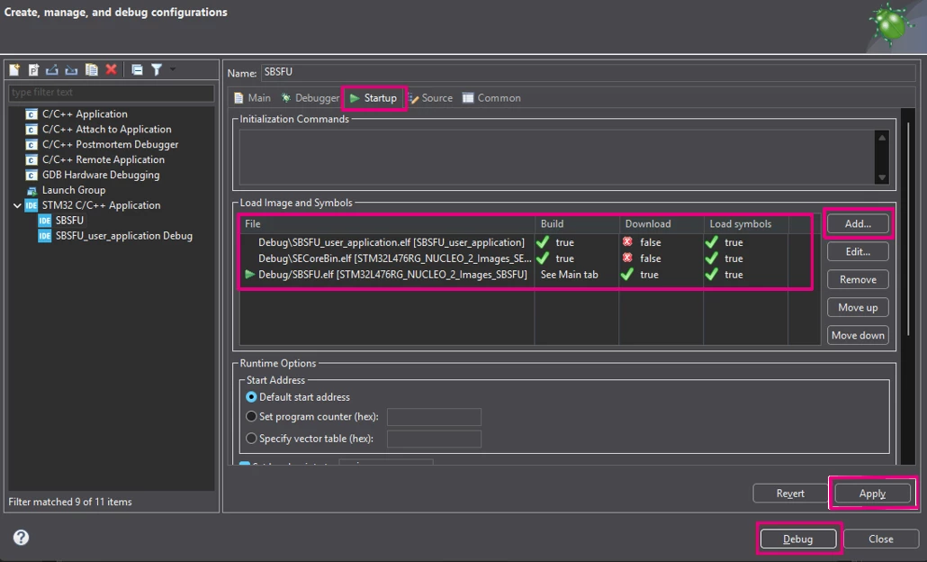

7. Debugging the application
Go to 2_images_SBSFU and open the debug configuration.
- Run > Debug configurations...
- Open the Startup tab

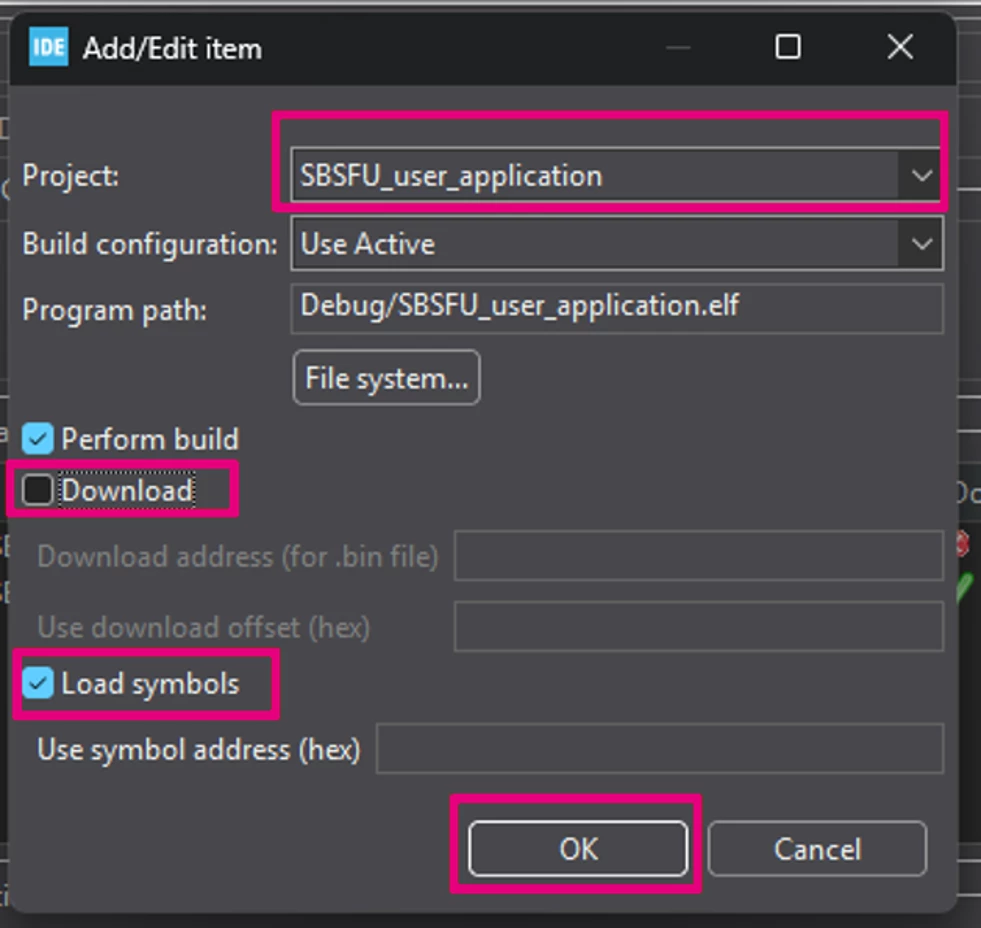

- Add the project, then enable Load symbols.
We load the symbols for the SBSFU_user_application and the SECoreBin. Click add and configure it as shown below:
Then the configuration should look like this. We do not need to download the user image or the SECoreBin. We only need to load the symbols.
Also, it is important to configure the SBSFU project (app_sfu.h) to be in development mode.
- Deactivate all security protections: enable this config SECBOOT_DISABLE_SECURITY_IPS.
- Make sure that SFU_FINAL_SECURE_LOCK_ENABLE is disabled.
- Activate SFU_FWIMG_BLOCK_ON_ABNORMAL_ERRORS_MODE.
- Activate the SFU_VERBOSE_DEBUG_MODE and SFU_DEBUG_MODE.
- We can debug the SBSFU project.

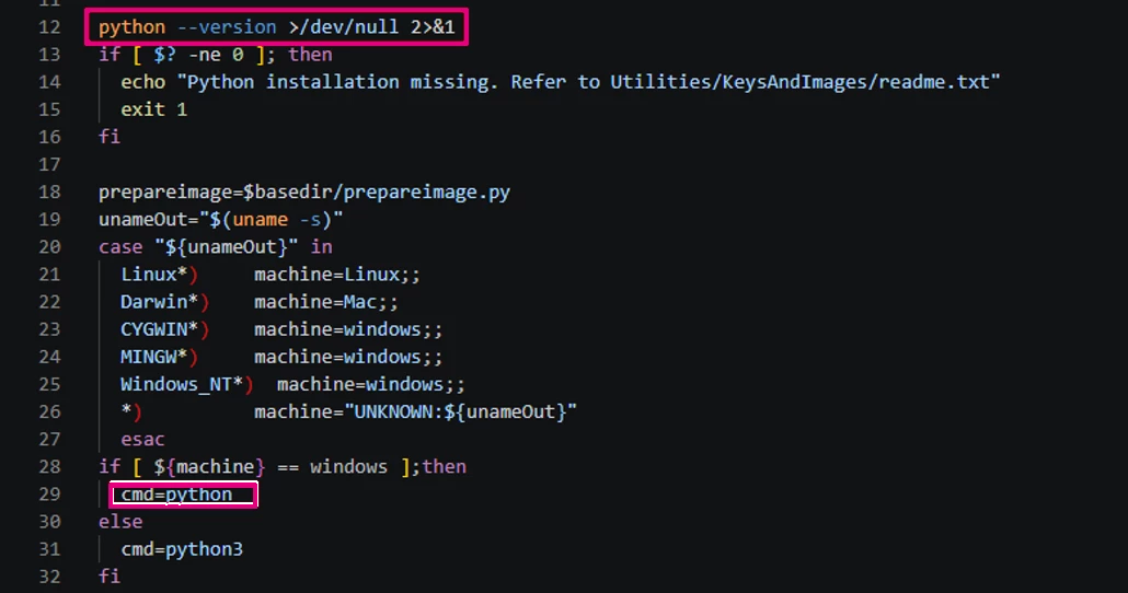

8.2 Update Python scripts
Depending on the Python command, system alias updates the script accordingly.
Update all the .sh scripts by changing all the python commands to py.
This is how it is aliased in our system. Verify the Python command used by the system.
The .sh scripts are located under 2_Images_SECoreBin/STM32CubeIDE and 2_Images_SBSFU/STM32CubeIDE.

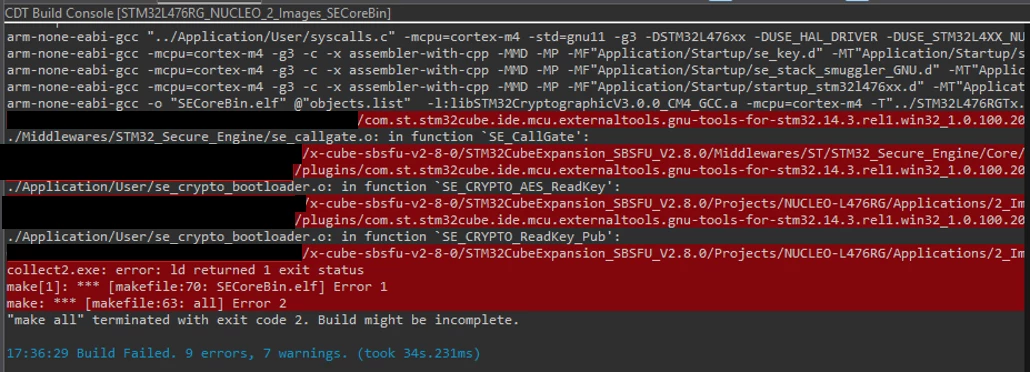

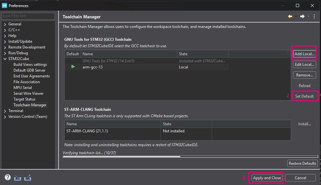

8.3 Compilation process
A separate issue can occur when building the SECoreBin project with Arm GCC 14. In the tested environment, GCC 14.3.1 produced linker errors in the Secure Engine components, as shown in the image below.
The tested workaround is to build the SBSFU project with an Arm GNU toolchain version earlier than GCC 14. We use STM32CubeCLT version 1.1.18. It provides a compatible Arm GCC 13 toolchain.
We updated the STM32CubeIDE toolchain to point to the new arm-gcc toolchain. Go to window -> preferences -> STM32Cube -> Toolcain Manager.

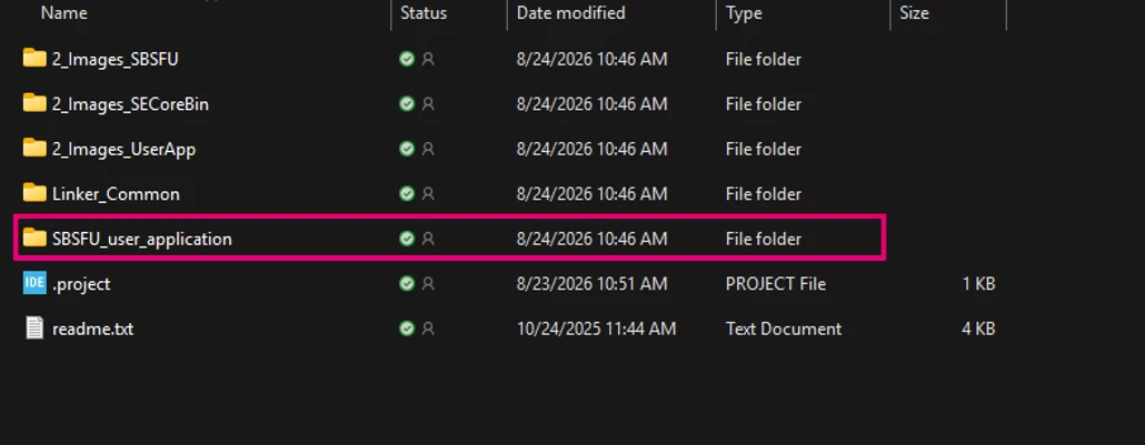

9. Using the attached project
To be able to use the attached project, follow these steps:
- Unzip the project.
- Copy the project directory into:
- Import the project using STM32CubeIDE.
Note: When extracting the ZIP file, it creates a directory. Do not copy that directory. Copy only the root folder containing the SBSFU projects and the SBSFU_user_application.
