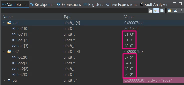

As a validation, you can check the 2nd and 3rd bytes of the UID, which are mostly ascii encoded. Reading these values as bytes, you should be able to see the ascii encoding of the lot numbers:
uint8_t lot1[4];
uint8_t lot2[4];
uint8_t *ptr;
ptr = (uint8_t *)&uid[1];
for (uint8_t i = 0; i < 4; i++) {
 lot1[i] = ptr[i];
ptr = (uint8_t *)&uid[2];
 lot2[i] = ptr[i];

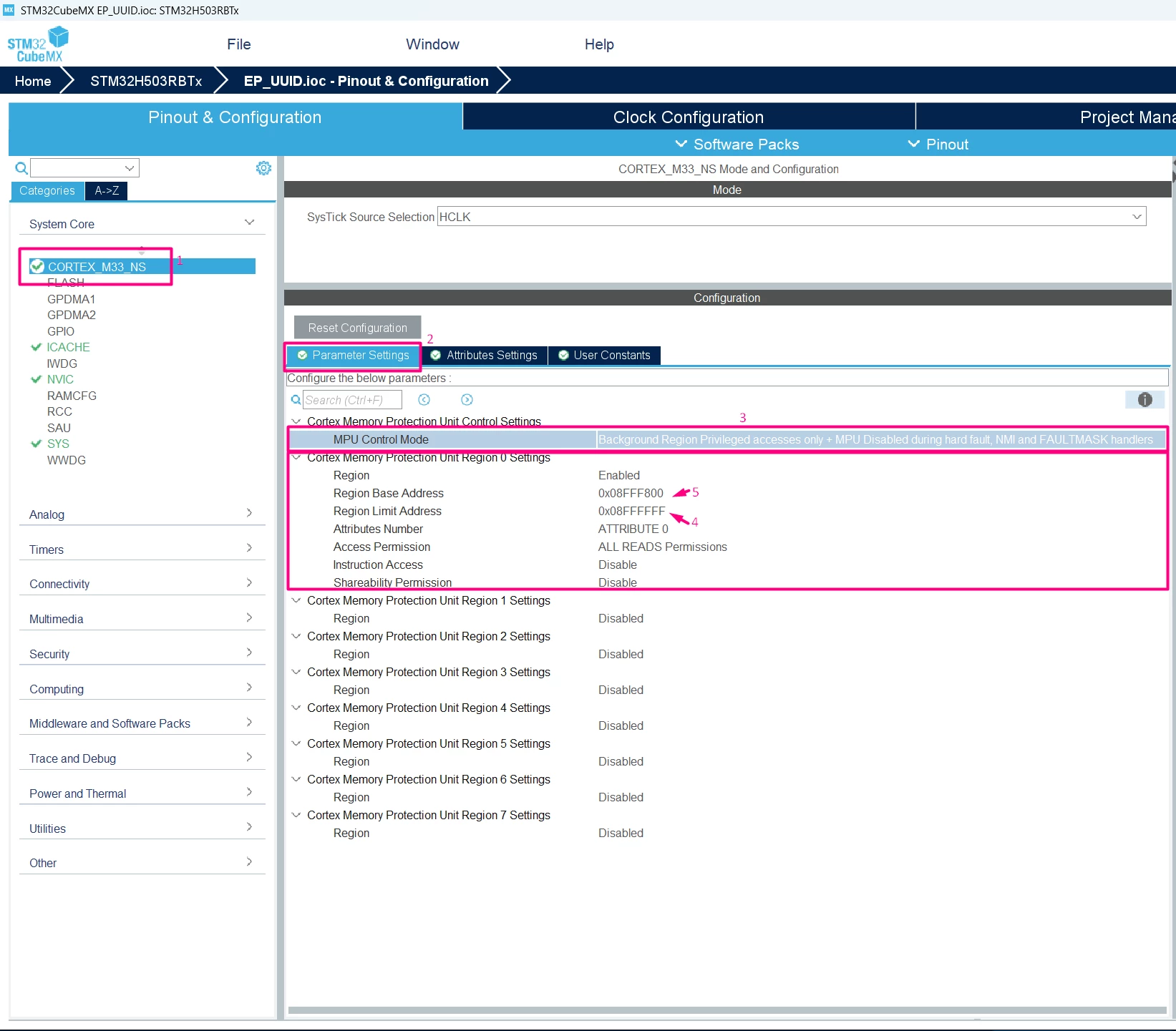

According to the reference manuals RM0492 and RM0481 section 7.3.2: "By default, all the AHB memory range is cacheable. For regions where caching is not practical (OTP, RO, data area), MPU must be used to disable local cacheability." Since the above address is in the AHB memory range, it is necessary to create an MPU region to remove the cacheability of this region. The screenshots below are the STM32CubeMX configuration of the MPU:

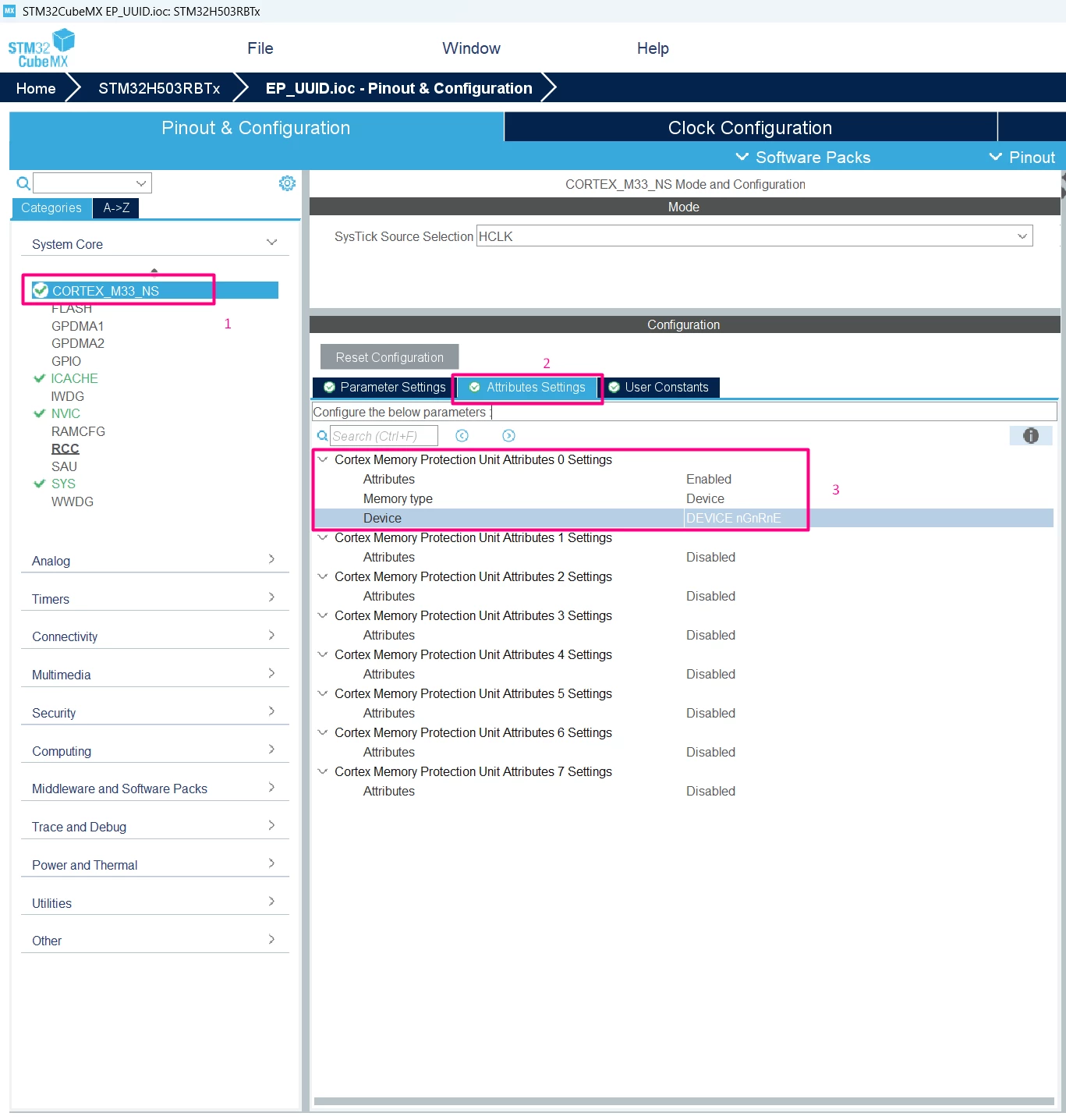

  • Start by creating new Attributes Settings:BMontanari_1-1758715035836.png
  • Configure the Parameters Settings - start by setting the Region Limit Address to 0x08FFFFFF and then configure the Region Base Address to 0x08FFF800:BMontanari_2-1758715156791.png

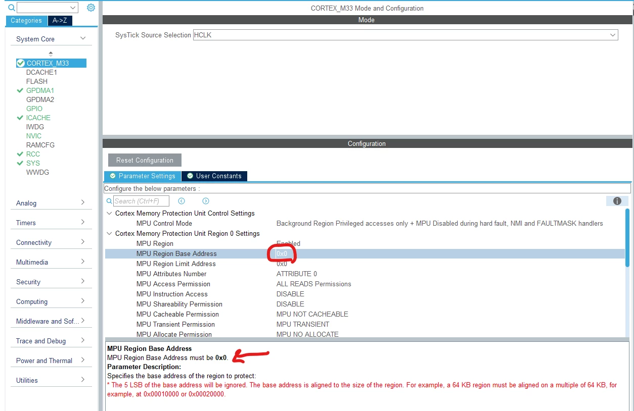

Hi.
I'm trying to set the same configs for MPU on STM32H573IIK3Q in UI, and It keeps setting the base address back to 0x0. However, If I modify the generated code and set the base address to 0x08FFF800 it works without any issue.
Is there anything else in the UI that I need to set before I setup the MPU regions?
Kind Regards.

September 19, 2025
The interface on CubeMX has gotten a bit weird and the details have changed.
With CubeMX 6.15.0, to set the Region Base Address, you have to set the Region Limit Address first, then CubeMX will stop resetting the base address to 0x0.
To set the Attribute Number, first you have to go into Attribute Settings and enable Attribute 0.
Finally, after setting Attribute 0's Memory type to Device nGnRnE, you almost get the code generated in the text of the original post, but only:
MPU_AttributesInit.Attributes = MPU_DEVICE_nGnRnE;
not:
MPU_AttributesInit.Attributes = MPU_DEVICE_nGnRnE | MPU_NOT_CACHEABLE
 | MPU_TRANSIENT | MPU_NO_ALLOCATE;
I can't figure out how to set the extra attributes.

B.Montanari
September 24, 2025
Hi @Andrei Chichak ,
Thanks for raising the code change upon STM32CubeMX update. I just updated the images and expected code generation. It should indeed be just:
 Also, thanks for highlighting the order to configure the MPU settings, that was also incorporated as part of the main text.
